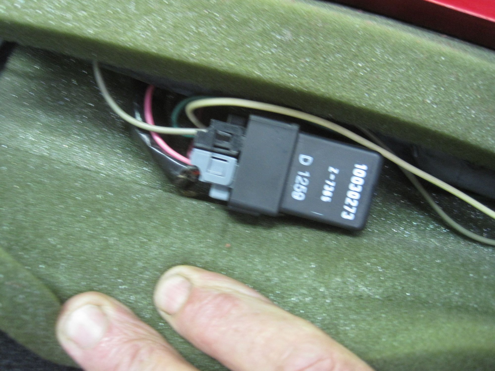

Originally Posted by IndyFestivalRich
Trying to locate the relay. Not in the storage box behind the driver's seat with the other wiring for the antenna. Suggestions?
it’s located in the rear bumper where the antenna is located. Car needs to be on a lift to replace it. Just my cable broke and i was able to fix it, of which took 10 min. Unfortunately , the grommet cost $25 to replace. Being in there for 35 years took a toll on the rubber. Good luck
Old Jun 20, 2025 | 04:40 PM
IHBD's Avatar
IHBD
Pro Mechanic
Joined: Nov 2016
Posts: 2,235
Likes: 3,063
From: So Cal
No, and No to the emphasized items above.
Earlier in the thread the relay location in a Convertible is cited correctly: "On my vert it's located under the carpet driver's side all the way at the back."
In a coupe the relay is under the rear trim panel. Open the hatch, remove the trim, relay on the RH side of car and latch.
In neither body is the relay located under the car, nor requires a lift to access.
Antenna Relay. 1992 Coupe.
1992 Coupe Antenna Relay. Convertible relay is similiar, location is under carpet, driver side, high up near deck lid.
1992 Coupe Antenna Relay. Convertible relay is similar, location is under carpet, driver side, high up near deck lid.
