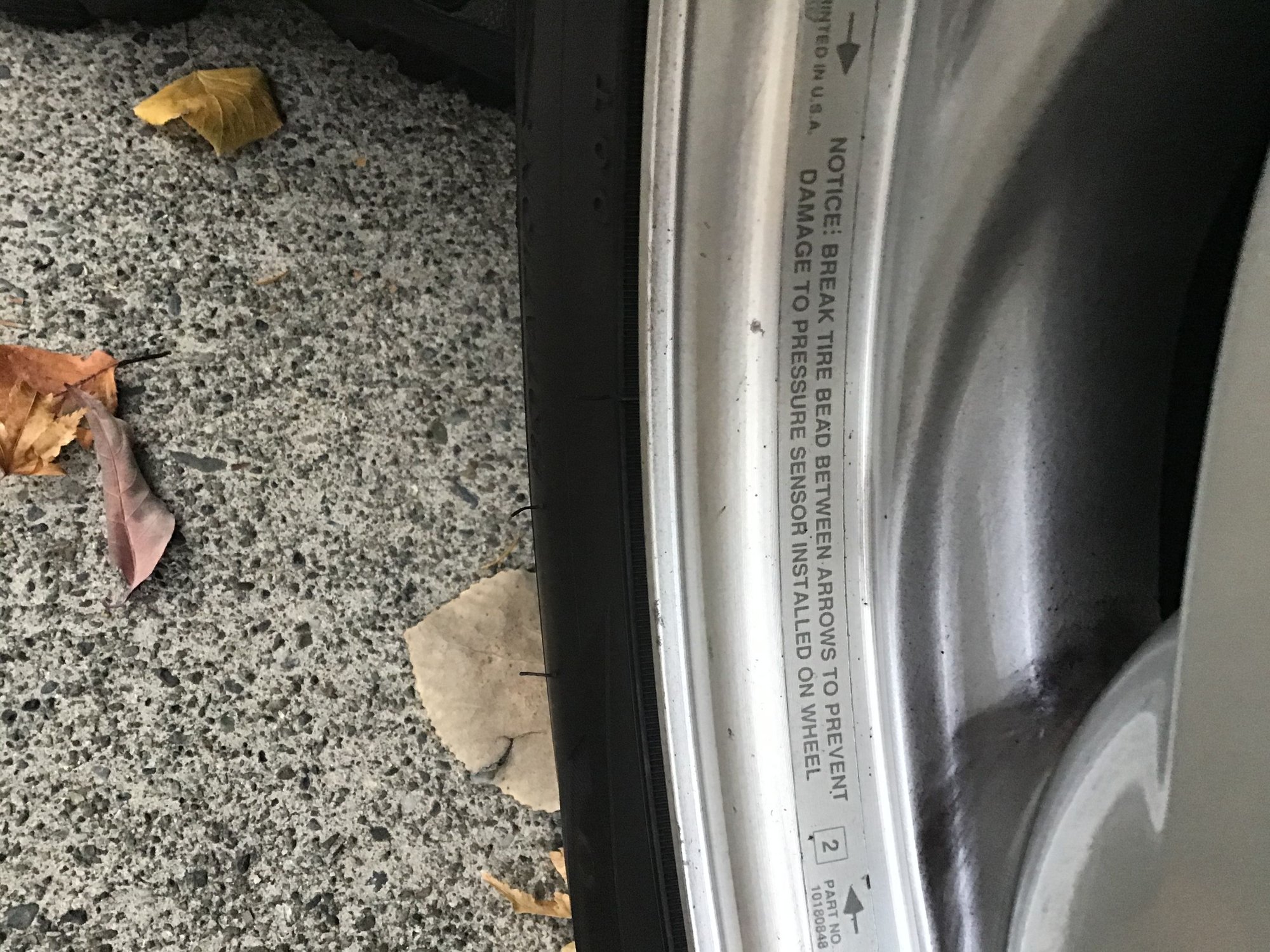

I found that Dornman sells a universal TPMS band for 15 to 24" wheels. part # 974-040. One of my tires still has a label and it indicates breaking the bead at 90 degrees clock wise from the valve stem which is in line with what I just read regarding the sensor location is 180 degrees from the valve stem.

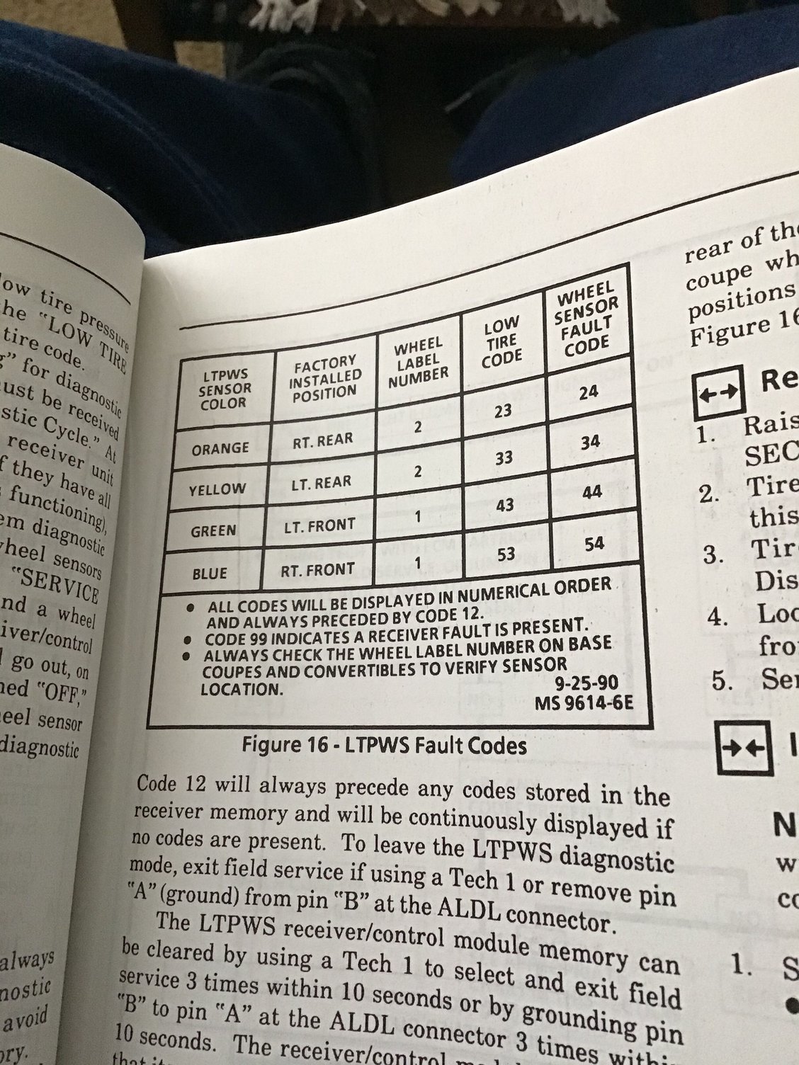

Here are photos of both the label on the wheel and the codes as listed in the service manual. Early sensors are not interchangeable with the later (93-96) sensors.
The band is essentially a large hose clamp but with a lead weight attached to it that offsets the weight of the sensor so the wheel can be balanced. I am surprised that someone had to cut one off since they usually will just unscrew like a large hose clamp. This allows you to remove them if you are changing wheels. This is what most likely happened to the non stock wheels mentioned in this thread.
I always supervise the person changing tires on a wheel with the sensors and keep reminding them the cost of a replacement if one can be found.
Also never discard any component from these sensors. Wheel bands go for $50 to $100, sensors $125 to $350 each, the weight $25 to $50 so keep them. Sensor housings are what is normally damaged by tire removal. The plastic housing where it is attached to the band is broken free and usually not repairable. However the internal components have value and the housIng may be repairable with some of the new plastic repair products on the market.
