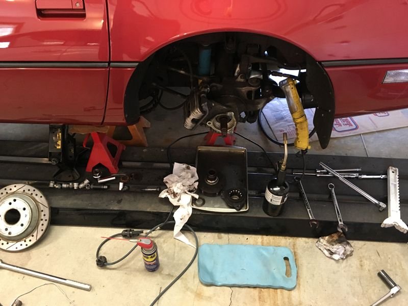

Need to replace RR hub assembly.
The 3 Torx bolts hold the assembly on
WILL NOT BUDGE!
Have been using 50/50 mix acatone trans fluid, heat, hammering, and impact gun.
WILL NOT BUDGE!
Looking at my cut off wheel now, but I didn't want to turn this into a hack job.
Any ideas?
Oh , do I mention they
WILL NOT BUDGE!

Half shaft is still in, and have a straight shot a the bolts.
Packed it in for today.
Soaking bolts overnight, brother has a more powerful impact gun. Hopefully we'll have better luck tomorrow.

Fully aware of the affects of galling. And use anti- seize as standard practice.
Steel bolts pass through aluminum knuckle and bolt into cast iron hub flange.
The car has 240k mi , I doubt they are the original hubs but they could be.
And I've tried tightening and loosening to try and break free.
Had other things to work on today. Will try tomorrow . Will keep posted.

Update.
After 4 hours today, one bolt is out.
Used a 1,000+ ft lb rated impact gun. The other 2 mothers' haven't budged. Using Kroil as suggested, and the torch.
Still have my cut off wheel close by as a last resort.
These are the hardest bolts I've ever encountered. I would think that something would have broke by now.

Got one more out.
One more to go.
Then the other side.
What a ball breaker.

Originally Posted by Tom400CFI
What kind of torch are you using?
Also, how long and thick is your extension (that's what SHE asked!) to get you from the gun, to the socket? You gotta be using an extension...and ain't no 1k lb-ft getting to the socket when using an extension on an impact gun.
Using a mapp gas torch. And a 3" extension
