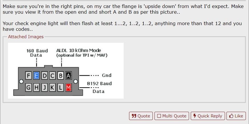

You need to check your codes. Try this video. Dont let the "newer" dash mess you up; the processes, functionality and reading is identical.
Your CEL will throw a code. Best to see what your car is telling you.

Stick a bent paper clip into port a and b. then turn the ignition to on (not starting).

Be advised not every SES light sets a code. I had one that was IAC related that didn't. Agree if you can get a code out that it definitely should help tracking down the issue, but know it's not guaranteed that you'll get one.
I have an Innova scanner and though it finds ODB1 codes, neither it nor the dash reading codes found one when I got this issue with the IAC.
