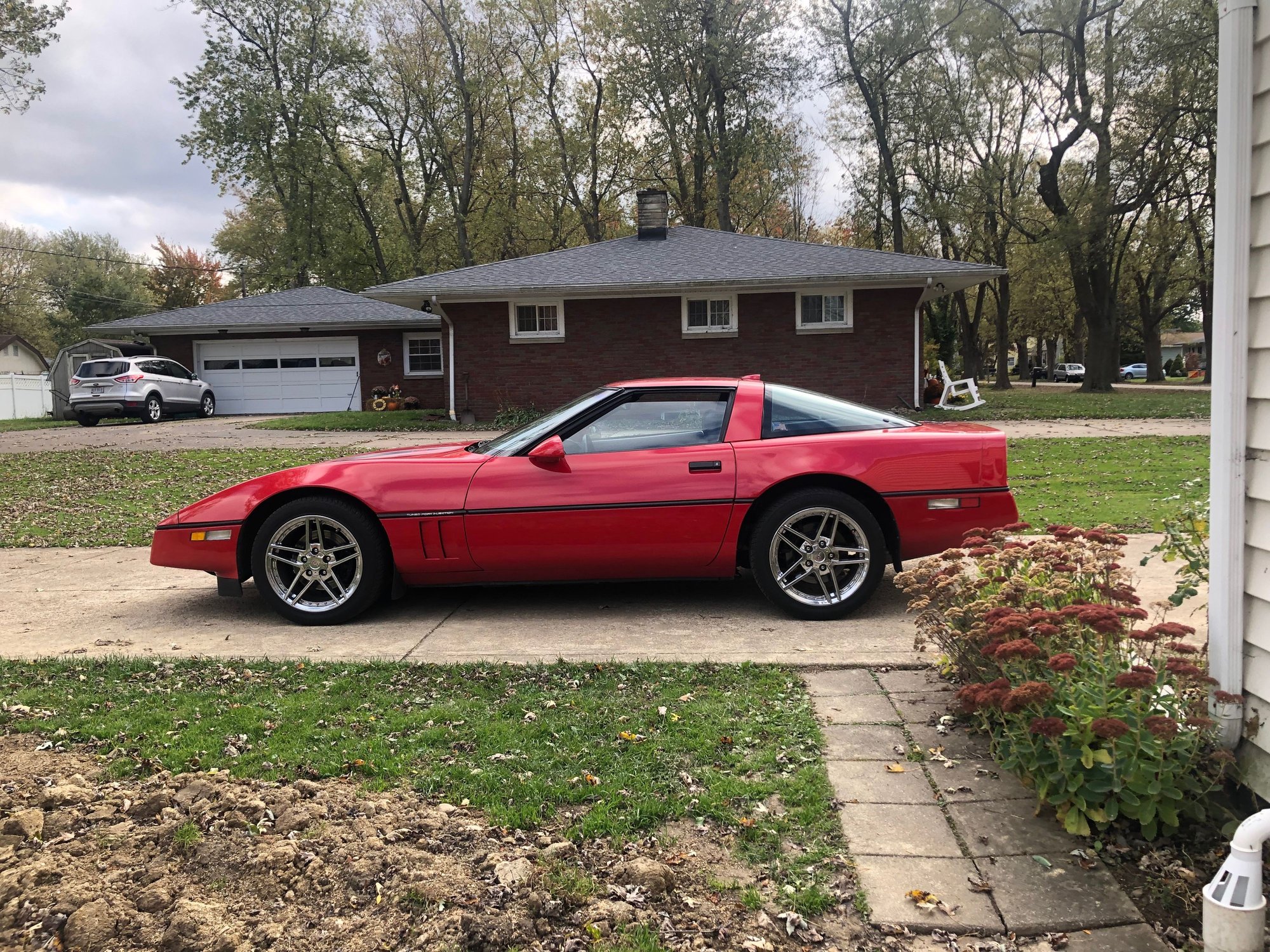

Hello! I bought a 1990 Torch Red coupe about a month ago, and it has some issues that I would like to learn about before I start working on it over the winter.
116k miles, rebuilt transmission, Z06 rims.
