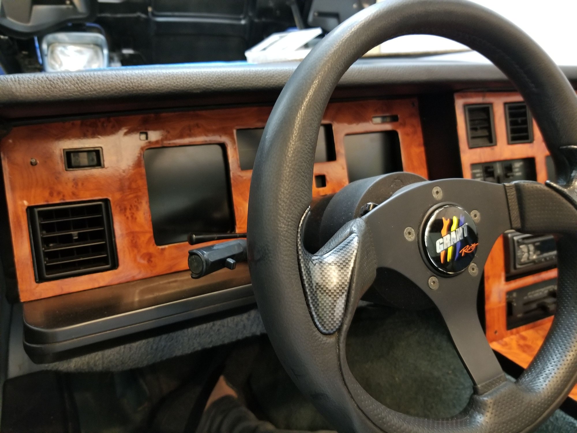

Hi fellas, I was happy today the 1985 vette I purchased a few months ago, I got it started for the first in 8 years of laying in a garage. My issue is the dash panel is dark, the lights are not working at all, not sure if the hi beams are on hi or not and the left turn single is always on and will not turn off as well the wiper blades will not turn off...after all my reading it seems I may need it rebuilt. I read that the car needs to run from time to time to keep the panel in working order and this vette has not run. In 8 years, is this true or should I be looking for a bad ground...or just have the panel sent out for repair...

Hi fellas, good and bad news...I got the wipes to stop, bad switch, got the blinkers to stop blinking as well....however dash still not working at all. This car sat for 9 years, so it's time and I got it out today and I'll send it out to Batee on Monday...thanks for all the help and enjoy the rest of your holiday weekend...
