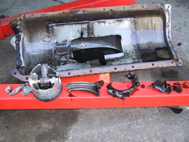

I ran an Accusump on my Brand D road race car as it originally ran an in-line 6 with a shallow oil pan and needed the help. It was difficult to build an oil pan adequate to keep oil at the pickup. It starved for oil on left turns as the engine is canted 30° to the right and oil would climb the right side of the engine. The Accusump didn't keep the engine happy.
That sucks!
Did also have the oil return holes opened up in the engine also?
I opened up all the oil retrun holes and smoothed the areas around them in my heads and engine at the same time as I did the pan and have never had an issue and I have 315 rival S tires on all 4 corners and a pretty tricked out suspension...But if your pushing it that hard and pulling some major cornering G's maybe going to a full on dry sump setup is your only option especially if hapoen to have slicks on your car.

That picture is from when I road raced a 1966 Dodge Dart. This was long enough ago that I ran 225/50R15 Kumho V700 Victoracers. The 225 slant six is a solid lifter engine and doesn't put all that much oil into the cylinder head. The top end oiling is metered through the rear cam journal to a passage that feeds the cylinder head and rocker shaft. The oil coming out of the rockers flows down hill to the right and into the lifter galley which has good sized drain holes.
