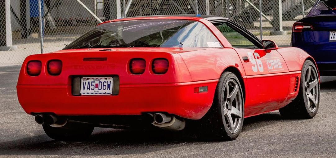

The first picture is of my 96 with 18x11 Forgestar CF5 wheels (50mm offset) and 315/30/18 BFG Rival S tires at all four corners. I think the wide fronts really make the car look more aggressive. These wheels can be had in gloss black. They don't have a wide lip, but they are considered a "deep concave" look because the spokes go inward a fair amount as they converge on the hub. They are under $400 each, so...maybe worth a look?

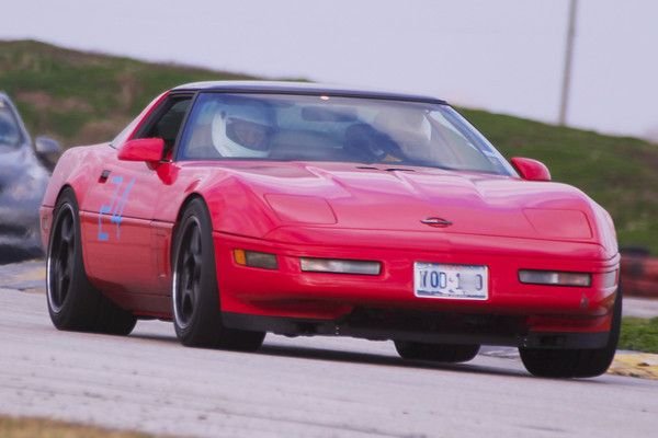

These 17x11 AFS replica A-mold wheels have a bit of a lip, and they're cheap cheap:

How is the driveability with this set up? I still want to tour with my car. It looks like you're racing this set. So all 4 tires and wheels are the same size? Are you experiencing any turning limitations or rubbing issues?
Old Nov 19, 2019 | 08:18 AM
MatthewMiller's Avatar
MatthewMiller
Joined: Aug 2015
Posts: 6,102
Likes: 1,981
From: St. Charles MO
All four wheels and tires are the same size. I drive to and from events on the Forgestar setup, and I have street-driven 315/35/17s of various types extensively. There is no rubbing or turning limitations. The only thing that's worse than stock size is the tramlining. However, I run roughly -3.3* camber in front and -2.5* in back, so it's likely that with a more street-oriented alignment the tramlining would be reduced.
