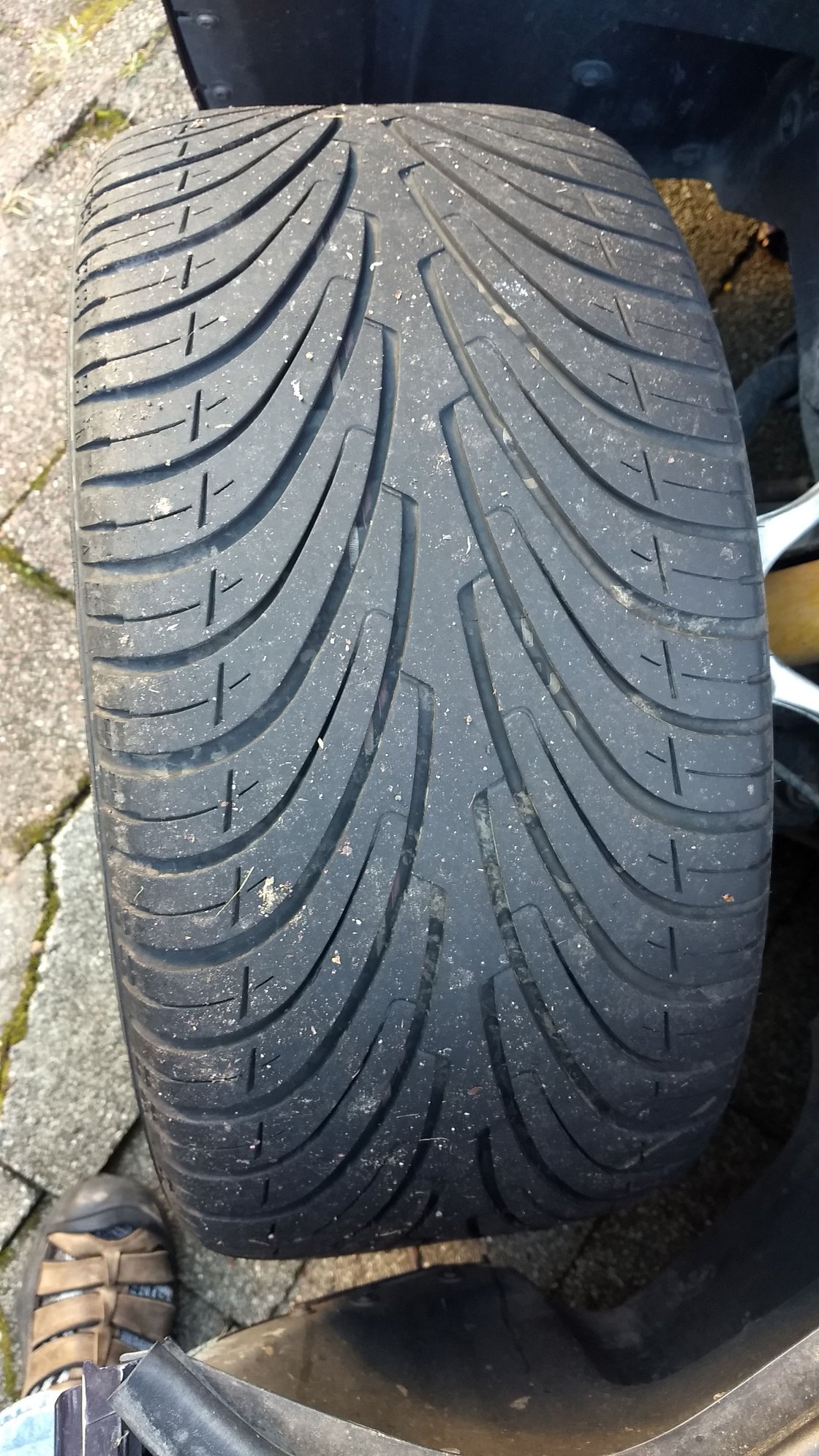

I finally looked to see what is on my car...Nexen N3000. Never heard of them. Doesn't matter, as it seems they are discontinued. The price point would indicate they are a cheap tire, a little over 100 bucks, so on that information alone I'm sure I can do better. I was impressed (and surprised!) at how well they did when I had to drive through a light snowstorm for about 100 miles on my return trip from picking up the car, but that may be attributed as much to the ASR system.
I don't have anything else to compare by experience though, so it may just be that I don't know what I'm missing.

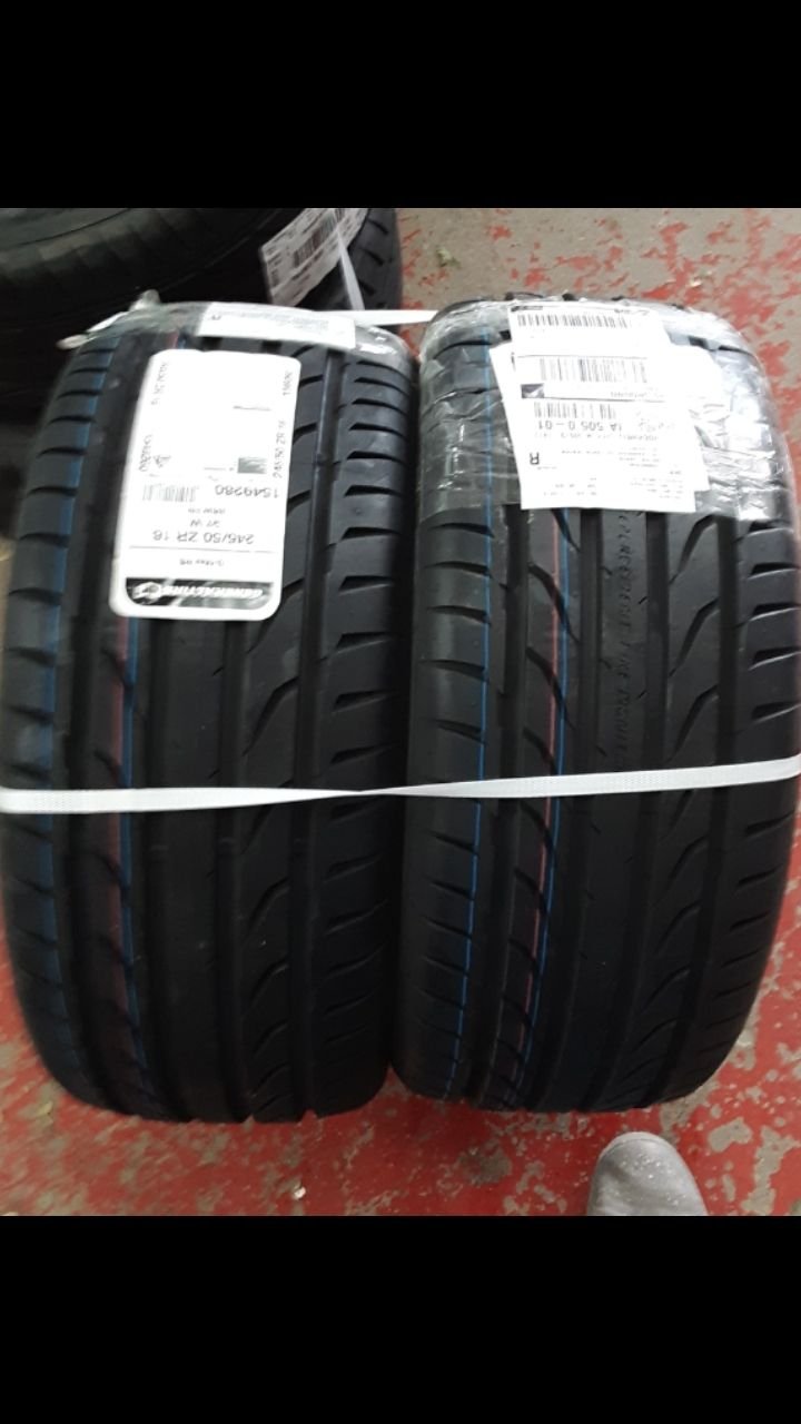

This summer I put 4 new General G-max RS tires on my IROC-Z and I really like those, too....they're super sticky!

The tread pattern on the General's look great, too... here's my IROC tires when I got them. These are 245/50/16
Originally Posted by MatthewMiller
For a budget tire, there are numerous options. I've chosen Riken Raptor A/S at $99 for the 275.
Interesting that the Nexen looks EXACTLY like the Riken.
