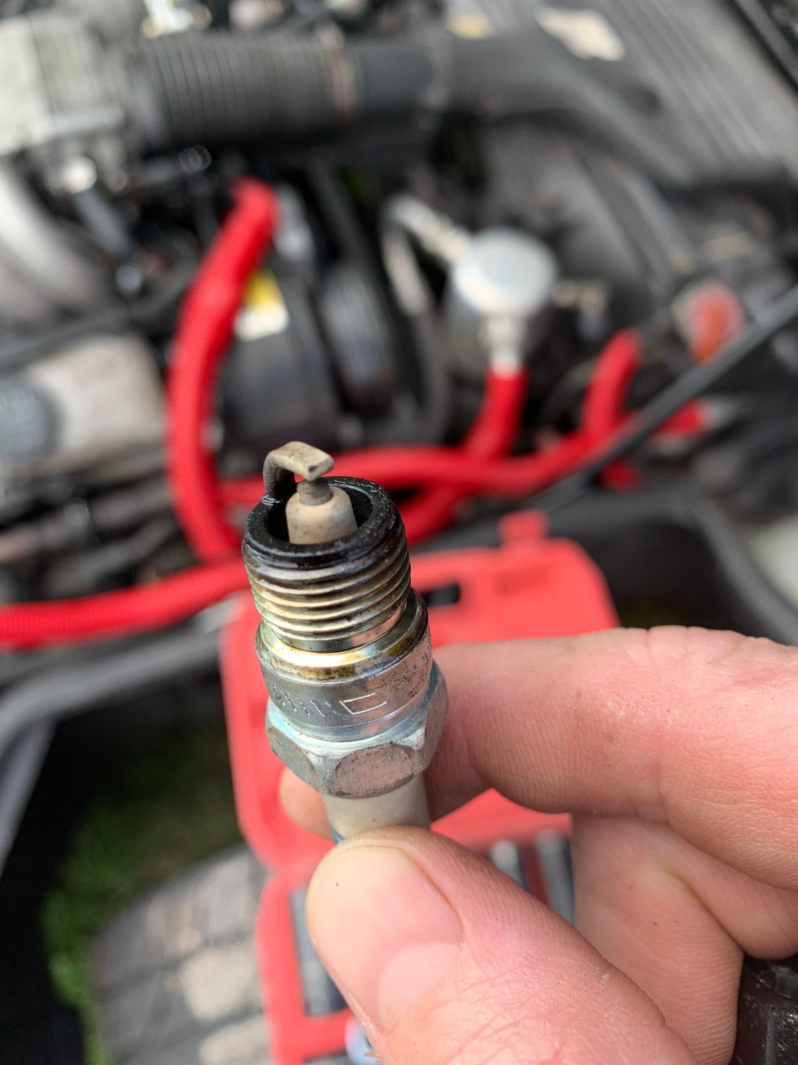

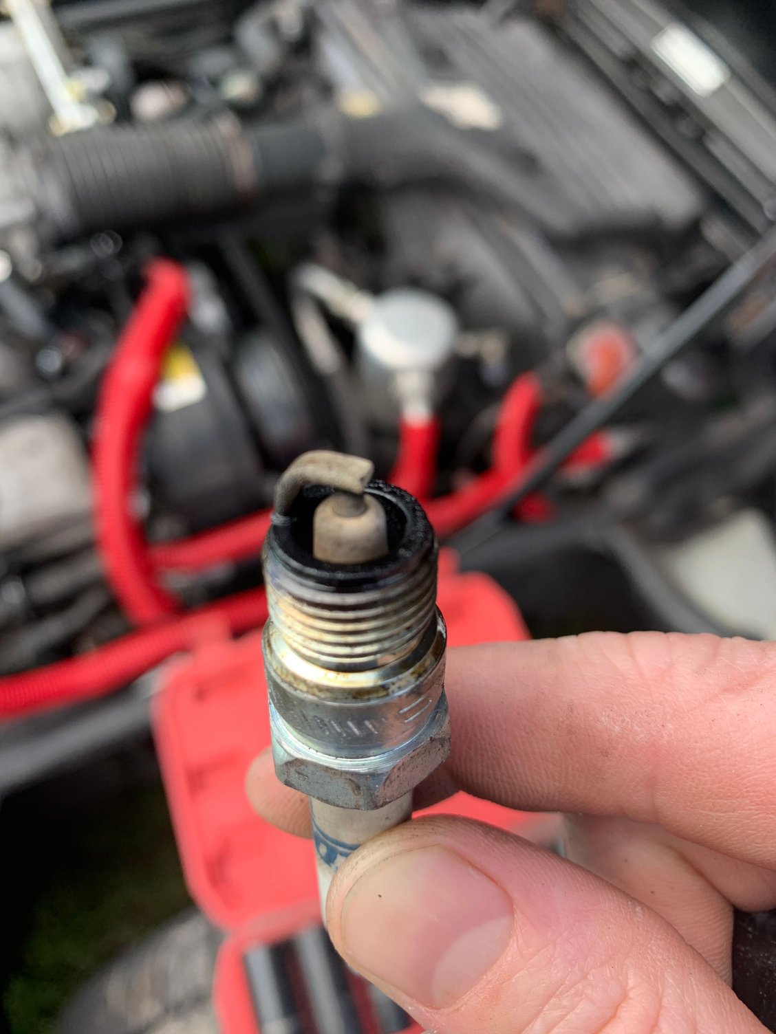

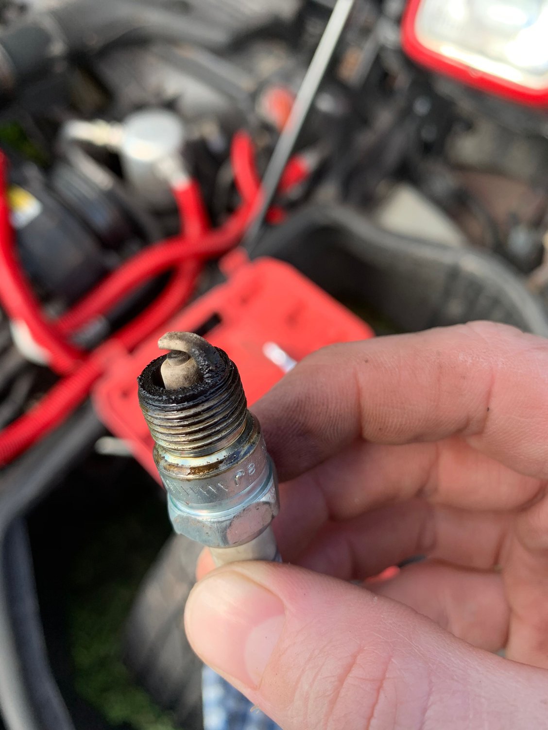

These are my spark plugs. FYI should be able to post data tonight or tomorrow morning.
also. The o2 does move around. It just stays above 700. Like 700-730

Your plugs look used and slightly rich, not bad. Certainly not soot filled(rich) or a glazy white(lean). A slightly brown look with no build up is what you want to see. So your saying it moves between 700-730 only? Does you scan tool give you cross counts? Has the BLMs went back to 160 after the reset?
