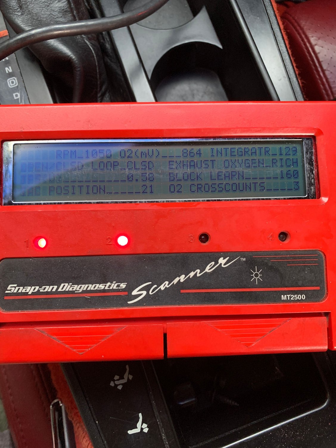

BLM has slowly moved back to 160. Integrator never got above 131.
bad Ecm?

Never mind. Reset the battery again. Blm goes to 128 but as soon as I start the car integrator goes to 160.
Int 160
then settled around 130 ish. Take blm less than a minute to go to 160.

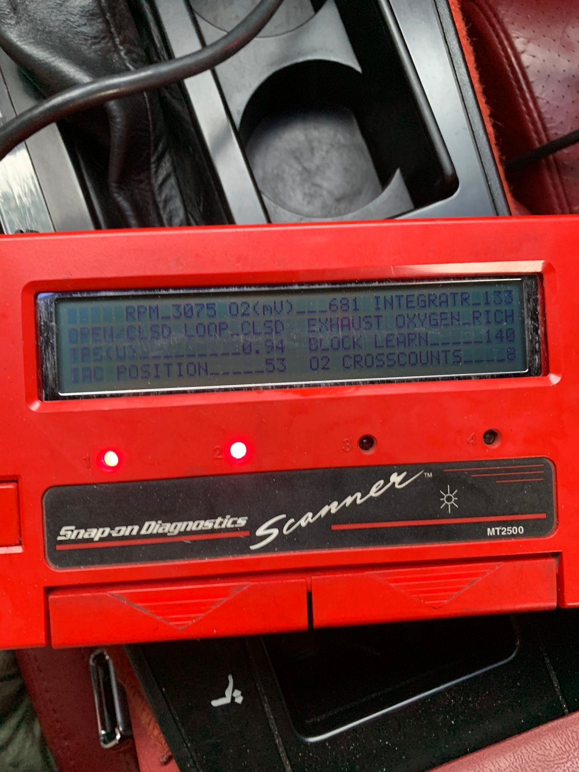

And block learn lowers at 3000 rpm to about 140.
3k rpm
then right back to 160 at idle

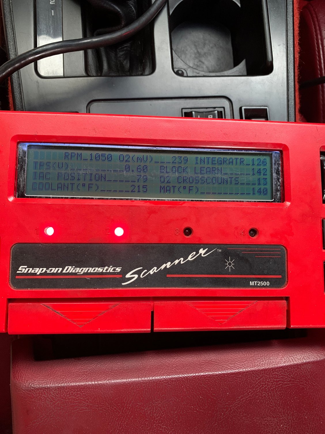

Also for what it’s worth. Blm goes to 142 within a minute with car in gear (d) with integrator around 122-127
In gear.
In gear.
3k rpm
Why is you IAC at 53 while your TPS is at 1V and holding 3000K RPMs? That seems odd.
what should it be?

Likes: 225
In gear.
Looking at this snap shot indicates your O2 voltage has gone low, and the cross counts at 13 indicates the sensor is switching and is good.
Just to satisfy my curiosity why don't you drive the car while looking at the BLM and O2 sensor voltage. Let's see how it drives under load, and what the data says.
