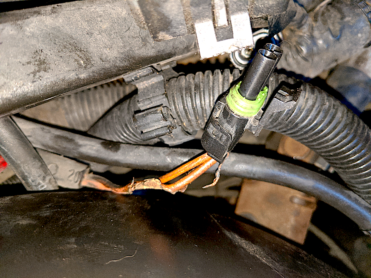

this looks kind of important, being that it comes off the positive Bat terminal cable into a rubber "joint" says 20 on it.. and the wire is broken/ corroded through..
What is it?
how would I fix this?
thanks!
Found broken corroded RED wire (i unplugged it)

Dosent look too bad.....Cut the wire back enough to see how much is damaged. I believe that molded part is a 20 amp fuse. You can get a quality in-line fuse and holder for it if you need to. Just make sure wire size is the same.... Or get the correct part from GM (if originality is an issue) and splice it in per the FSM..... But make sure to check how far back its damaged to make sure you dont half fix it...Good luck!

Oh, and those Packard ends are available almost anywhere as a pigtail repair splice. I have the kit (Summit Racing) so when i wired my car, i made my own ends so it looks factory...

I have made a "3/4" repair temp for trouble shooting.. only one of the 2 wires were broken, the fuse itself looked OK.
I have fixed the other wire with the 20 amp in-line fuse w/ 18ga. and plugged it back in.
still dont know what it controls or goes to?... looks substantial..

What year is it? I have a Not stock 88 but i have the electrical manual for it. I can tell yours isnt an 88, but im sure someone else can tell you what that plug is for...... Id leave it unplugged and see what DOSENT work and then you know...
