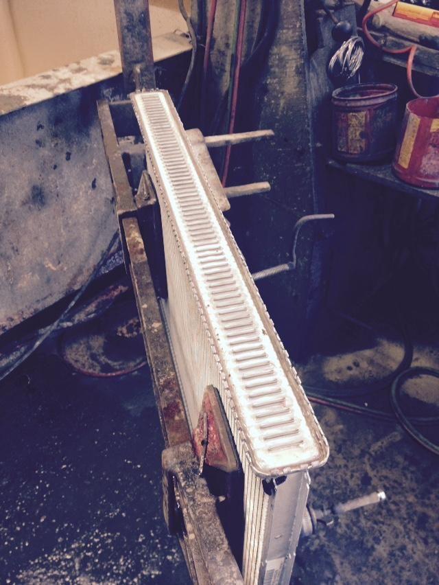

Interesting about the 7 year interval. I haven't seen that in either our work/fleet trucks...or my own. I sold a '96 Silverado 1500 in 2017 with 296,000 miles -original heater core. My 'Vette has almost 200k, I've had it 10 years and never changed the core. And in all the fleets I've managed, we've never had to change a core. Many of those trucks are over 15 years old and we have a few over 20 years old. But we DO, do maintenance: change/flush the cooling system...mostly on time.
In addition to corrosion protection, I believe cooling system fluid changes also help cleanliness...which helps the cooling system keep...cooling. I don't have over heating problems that you see posted here a lot. Here is a pic of the inside/tubes of a radiator that I pulled from my truck (Silverado) after I hit a cow, at 243,000 miles/17 years.
