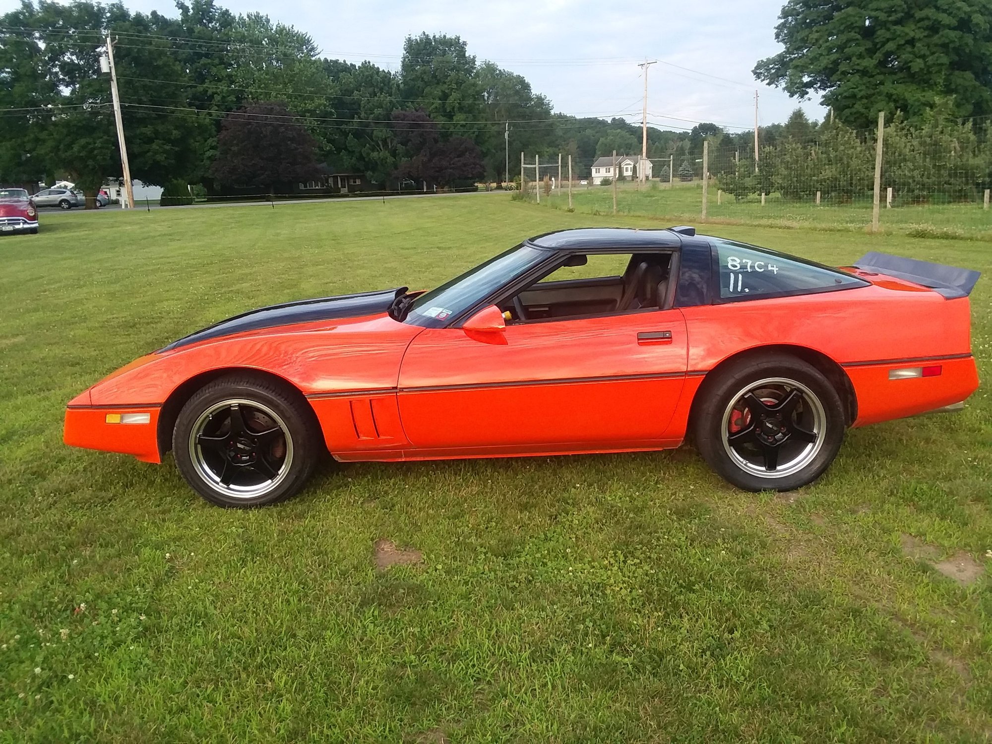

I acquired an 89 cheap but it wasn't running right.Very rough.Changed the fuel pump ign. module and injectors to 42lb. injectors. Now it floods out if I try to step on it.Feels like too much gas.What do I need to do to get it to run right?Chip change maybe?If so which one? Thanks in advance for any help.

Pretty Corvette!
