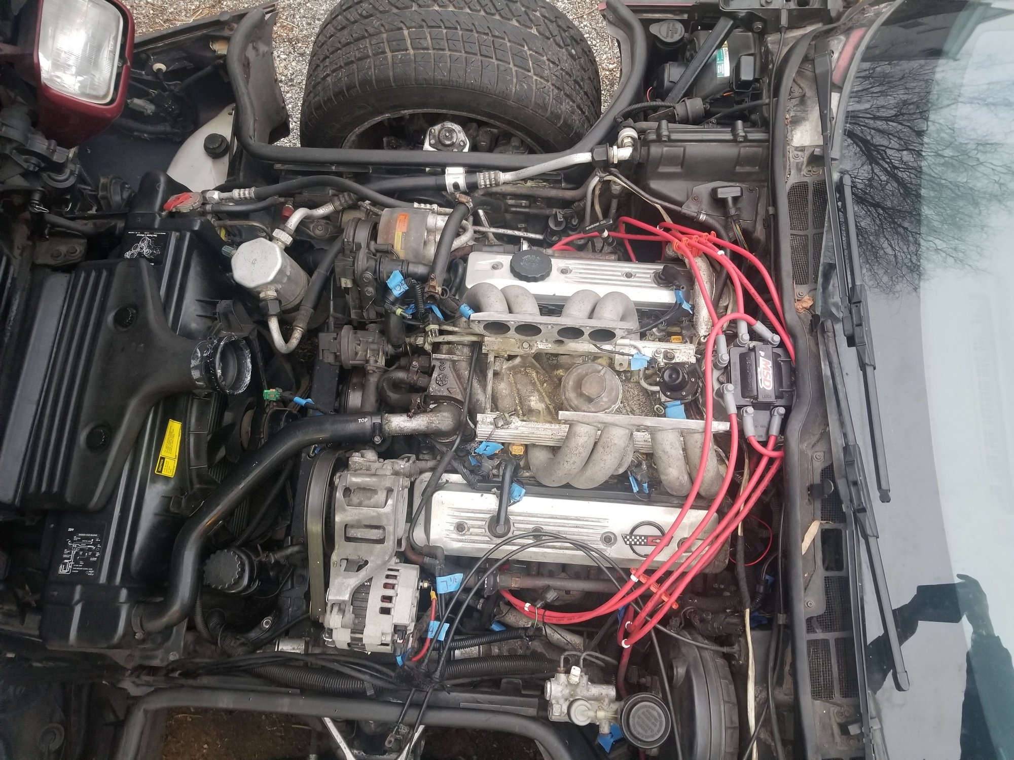

that first picture of the wires.. but that tire.... that thing has been in or near a fire and gotten very hot... in fact after looking again..... about every picture i see fire damage to wiring/components. might be a good option to make it brain dead and ditch the electronics all together old school 385 action torque monster. beauty of that is with the manual trans you do not need to worry about tranny issues with no wiring

Finally found time to get started on pulling the wiring. So far so good, no wiring damage towards front of the car. Everything seems to be concentrated near the firewall.
I label every connector and take a pic. While I am at it I will replace all vacuum lines. Never liked those plastic tubes, especially when that old.
The only difficulty I ran into so far are the two driver side connectors on the firewall next to the battery. They don't want to disconnect. Need to figure out how to get to the release clamp towards the brake booster.

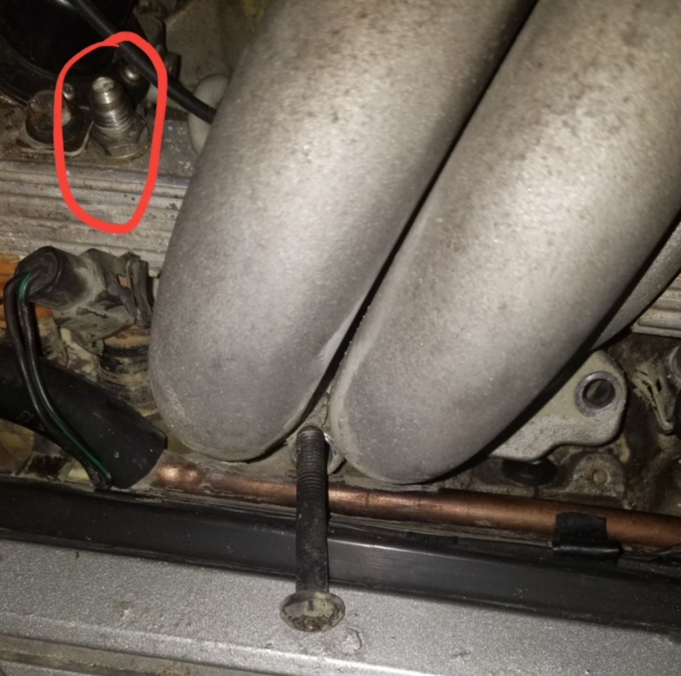

Here a pic of the above mentioned connection that had nothing plugged into...
that is were you would hook up your fuel pressure gage to, that is a schrader valve and should have a screw on cap.
Oh I see, so it's basically just for trouble shooting, not operational.
yes you should find a cap for it just to play it safe, it would be a shame if gas starts squirting out after all your hard work
and you end up have a car fire.
