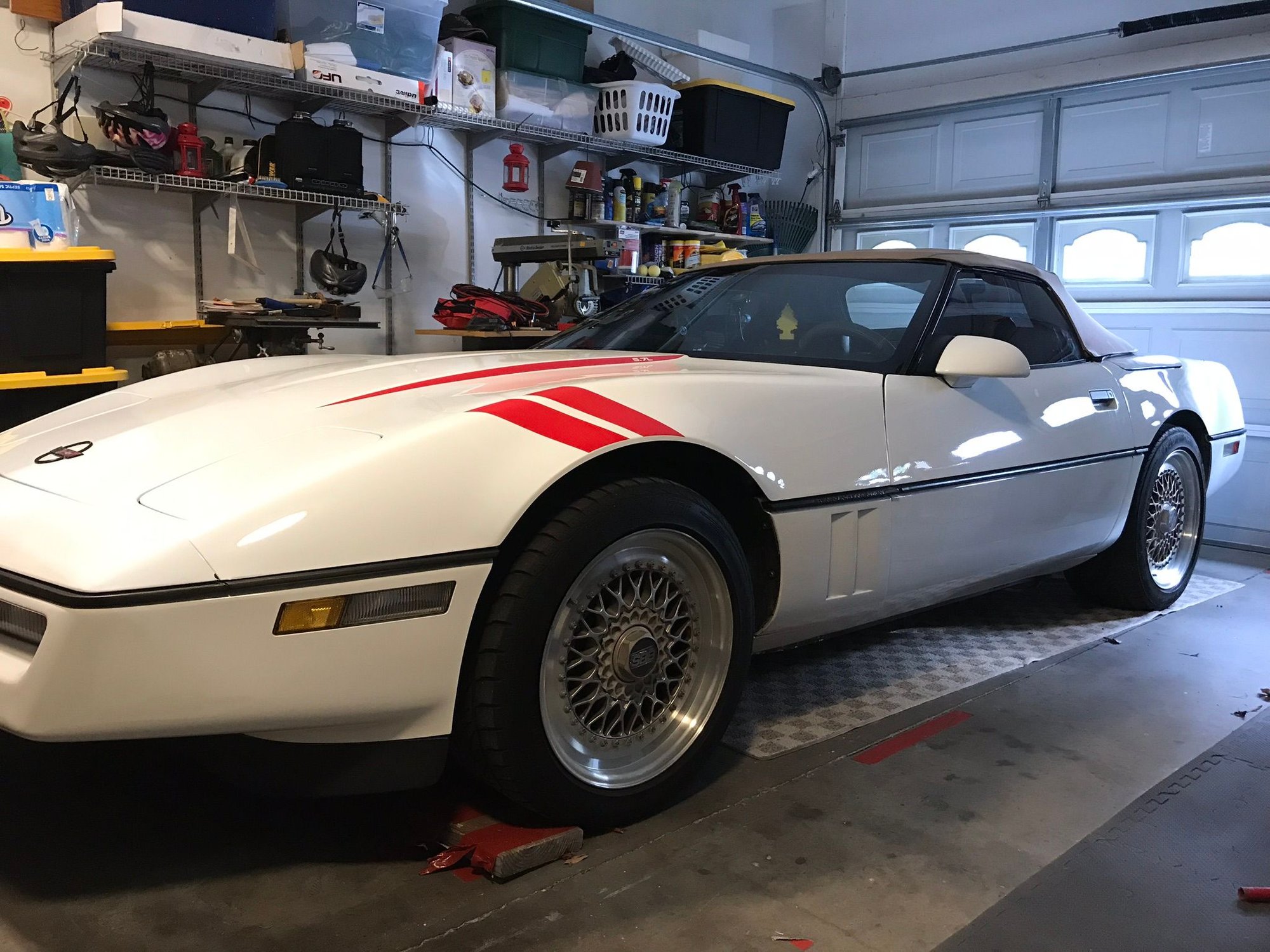

P.S. As you can see the car is in great shape, well except it won't run right now......

2023 C5 of the Year Finalist - Modified
Look I hope you get this worked out but I think the bigger problem is those rims.
Old Jan 7, 2020 | 09:04 AM
barchetta1's Avatar
barchetta1
Joined: Nov 2017
Posts: 1,060
Likes: 80
From: Fort Mill, SC
[QUOTE=Eshoremd;1600757205]Look I hope you get this worked out but I think the bigger problem is those rims. [/QUOTE
Im sure that was quite necessary.

I think the rims are sweet. Very period. I dig 'em. But that's not the OP's problem at all. I agree with the posters who gave GOOD advice about compression and leak down tests.
