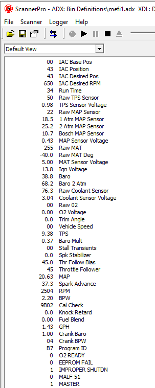

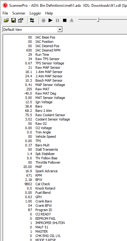

1st Snip is idling
2nd one is while it is dying

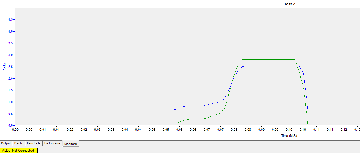

3rd one show a running test with the top line RPM and the bottom BPW
Ican replay that same run and monitor anything i want and graph it if someone wants to look at something different

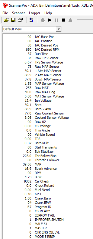

It appears intake air temperature sensor is disconnected or has failed. I would graph TPS. What does MAP read engine off? Do you have manual or e book?

Same run
BLUE is TPS Volts
GREEN is TPS

This is engine off
Which one is the intake air temp sensor
