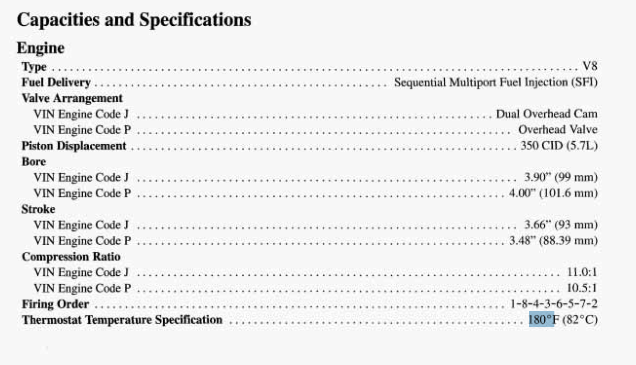

Is stock 180? I thought it was 195?
195 is stock.

Originally Posted by Natty C
195 is stock.
Negative. Not for an LT1. LT1 STOCK T-stat is 180

Here's a snippet from the 1995 owner's manual:
Yeah, Tom already corrected me.
