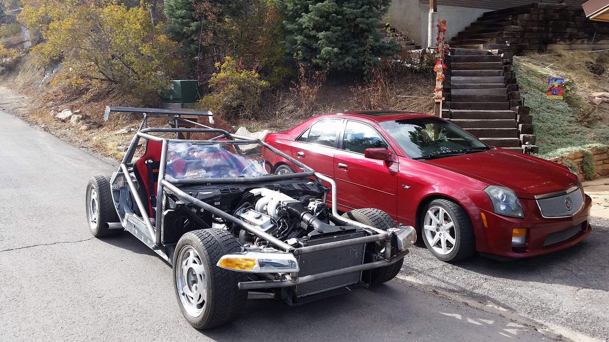

I admit....the wing was 100% for looks. With out it, the rear of the car reminded me of an AMC Gremlin!

Do you have any build pics, or at least fully torn down pics? You seem to have gotten yours lighter than most I've seen. My cage I think will be a bit more substantial (it's being built to NASA race standards), but if I can get mine down to your weight pre-cage, I'd be really happy!
Originally Posted by Tom400CFI
JeremyG, I have a Kart also -an '89 that I've stripped and caged. I cut the w/s frame and halo off before caging and used a polycarbonate wind screen. My kart weighs 2280 w/o me in it and my fuel cell holds 8 gallons. I think pads and good brake fluid are all you'd need for track duty for two reasons:
1. the reduced weight of the car
2. The poor aero of the car. It definitely slows faster from just coming off the gas than my complete '92...and it doesn't want to coast down hills well either.
You might as well try it w/the stock brakes first; the pads are a consumable anyway and fluid is maintenance, so trying decent pads and fluids is barely any more $$ than normal PM/consumables and it may work just fine. We can recall that the Challenge cars used stock brake hardware and held up sufficiently, even with full bodied cars with cages.

My weight is with the cage. I think I am low on weight b/c I "chased" weight all over the place. Losing the w/s and Frame, the halo, even the front frame horns and bumper brace was surprisingly heavy, when I cut it off...adn I didn't add heavy rotors and calipers!
I want to get my cage to NASA spec, so I need to add another side bar, and a diagonal roof bar, I believe.
I made a thread pm the build, with pics and some vids. It's can be found, HERE.
