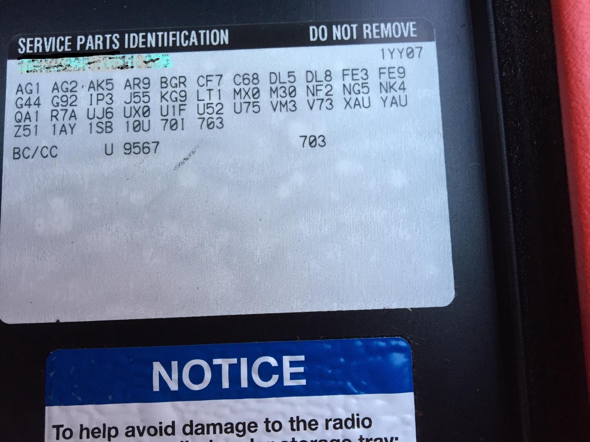

Find the sticker that has the 3 digit RPO codes. If no J55, then you don't have them. This is mine, you can see the J55 option.
https://www.corvetteforum.com/forums...e-upgrade.html
