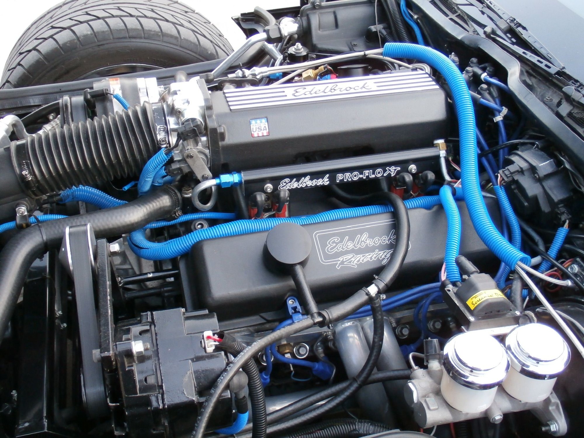

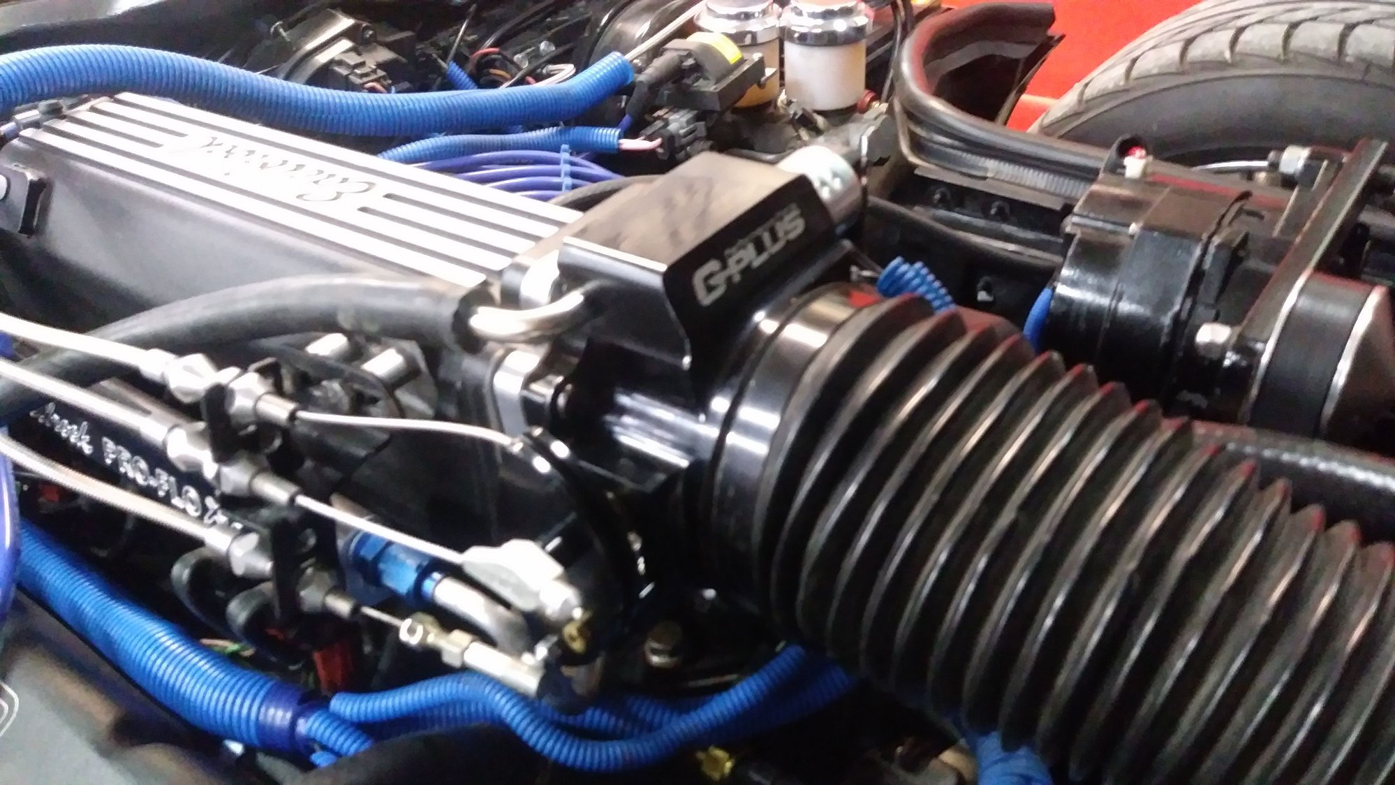

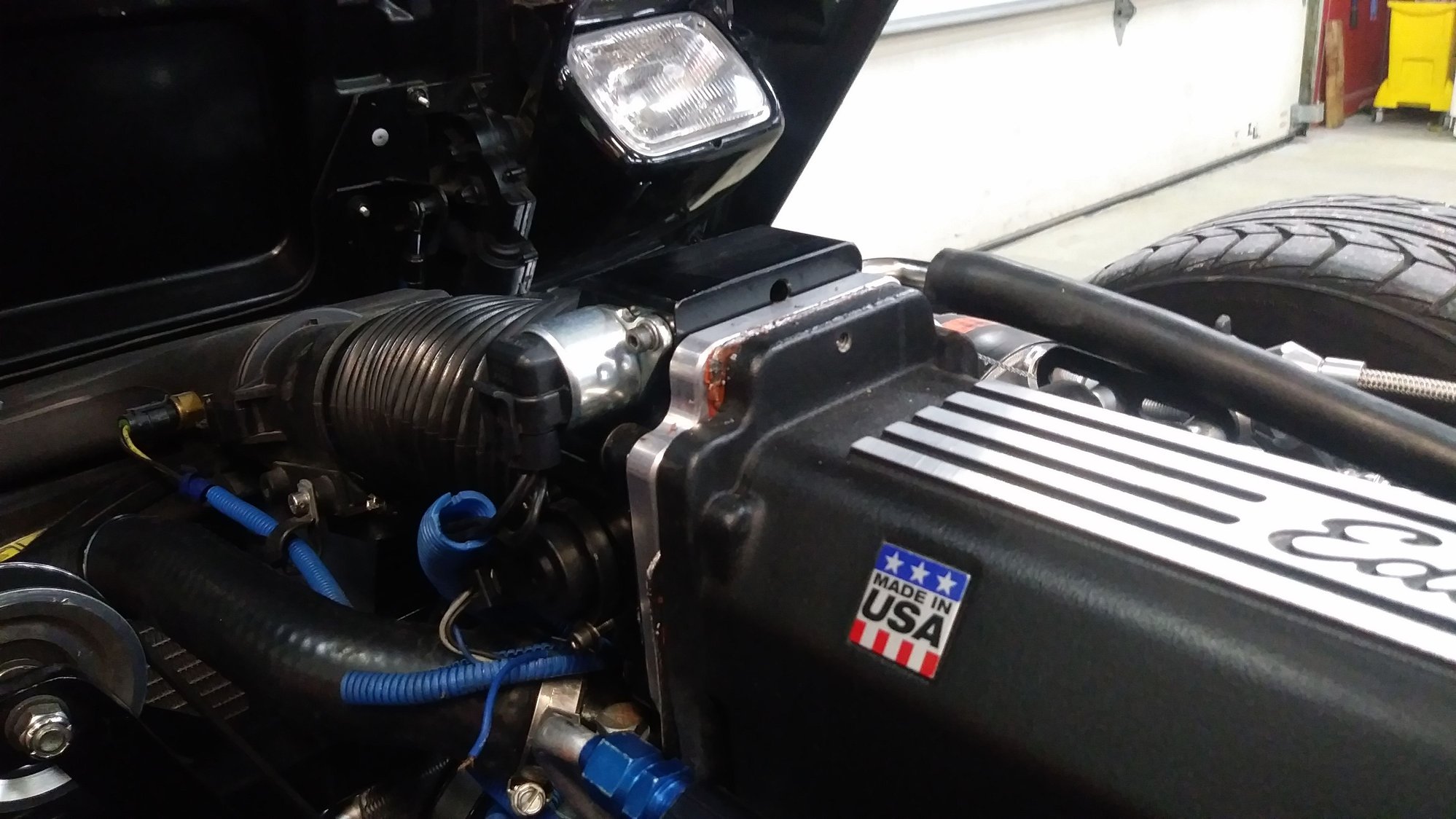

I am happy with my Edelbrock Pro-Flo XT. It fits under the C4 hood with no problem.
I came across this one while researching but according to their site it’s for SB up to 86 model! Is that true?
which part no. You have and any additional parts or mods required? Or just bolts on...

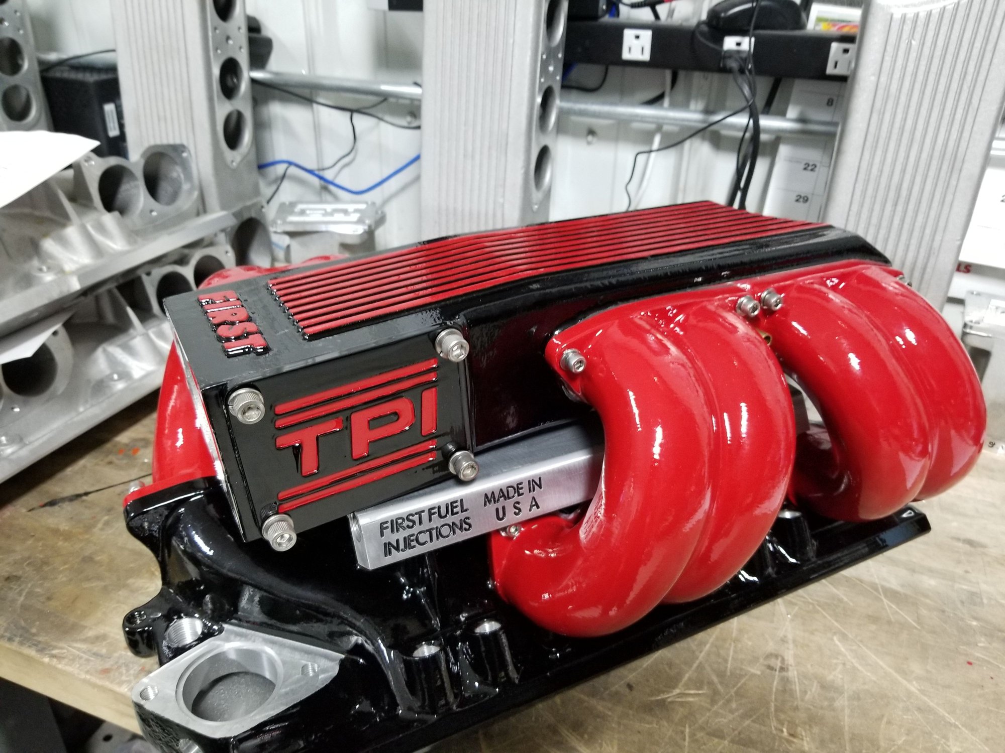

I have a FIRST but I haven’t put it on yet, I will be as soon as it gets warm enough to. I think I will be happy with it, it is still good at 5000 rpm or more and the stock intake stops at 4500 rpm from what I’ve heard, plus it should make more power throughout the whole rpm range. It won’t flow in the high rpms as good as the pro flo or mini ram though. But these cars were built with long gearing to run in the low rpms and the FIRST is better at low rpms so I think I would like the FIRST better. Plus it looks good in their painted version. here’s mine, they took this picture before they added the throttle body.
wow that looks wicked
And it’s close to the stock in shape
how much did it cost you?
does it come all with the parts as in photo or you need to add additional?
cant wait to see it mounted!

It came with all the parts in the photo plus the throttle body. They sent me that picture before they added the throttle body. I have had it since December. It cost $1200 plus $60 shipping. It’s expensive but it does come with the fuel rails and throttle body too and most other intakes don’t. Plus you can fit the big cap distributor with this one and with others like the mini ram you have to buy a small cap distributor. Yeah it’s close to the same shape as stock and I like that part because the tpi looks good, it just flows bad. This one when sitting next to a stock one is giant though, the runners are really big and all the ports are bigger than stock. I will have some pictures probably the end of March or April when I get it installed. I still need to get injectors, an adjustable fuel pressure regulator and new sensors to use.
thanks and good luck 👍🏻
looking forward to see it mounted and running....
I’m interested more in this one now

https://www.edelbrock.com/pro-flo-xt...fold-7137.html Another option that will fit with a tad bit a trimming to the Throttle body lip but will cost as much as the TPIS Min-Ram by the time you buy all the hardware and the Throttle body.
