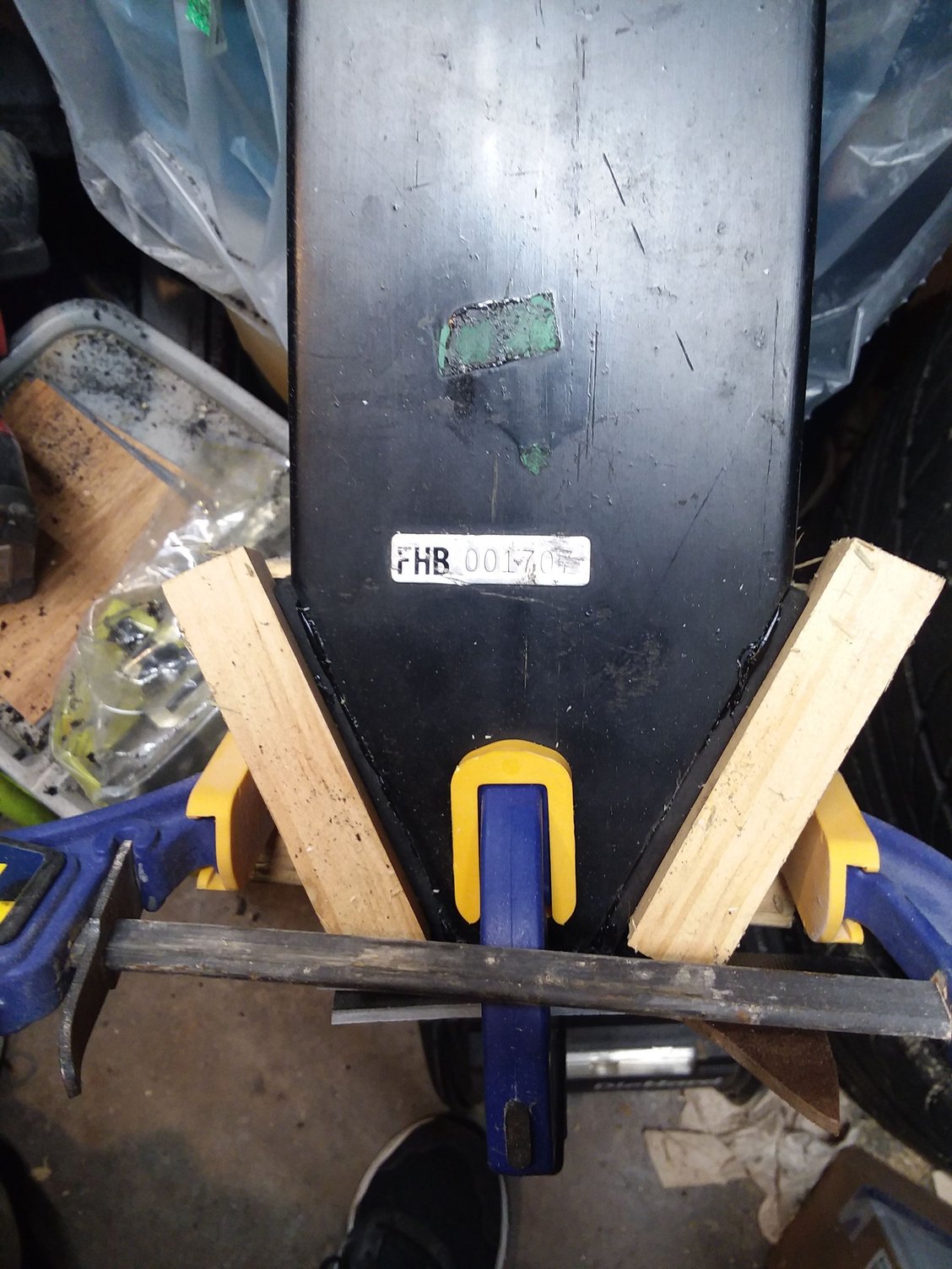

Well, I finally got around to getting the old pads off of the FHA spring. Took quite a bit of work. I actually cut the end of the spring off to make it easier to put into my bench vice (didn't care about the FHA spring since they are available all over the place). I then used bosch oscillator tool to cut the pad from the fiberglass while pulling the rubber pad outwards.
Here is me gluing the pad back on with the 3M Windo-Weld mentioned above:
Hopefully be able to put this thing on the car on Sunday. Have an event on June 6-7 at Grissom to get it ready for.
