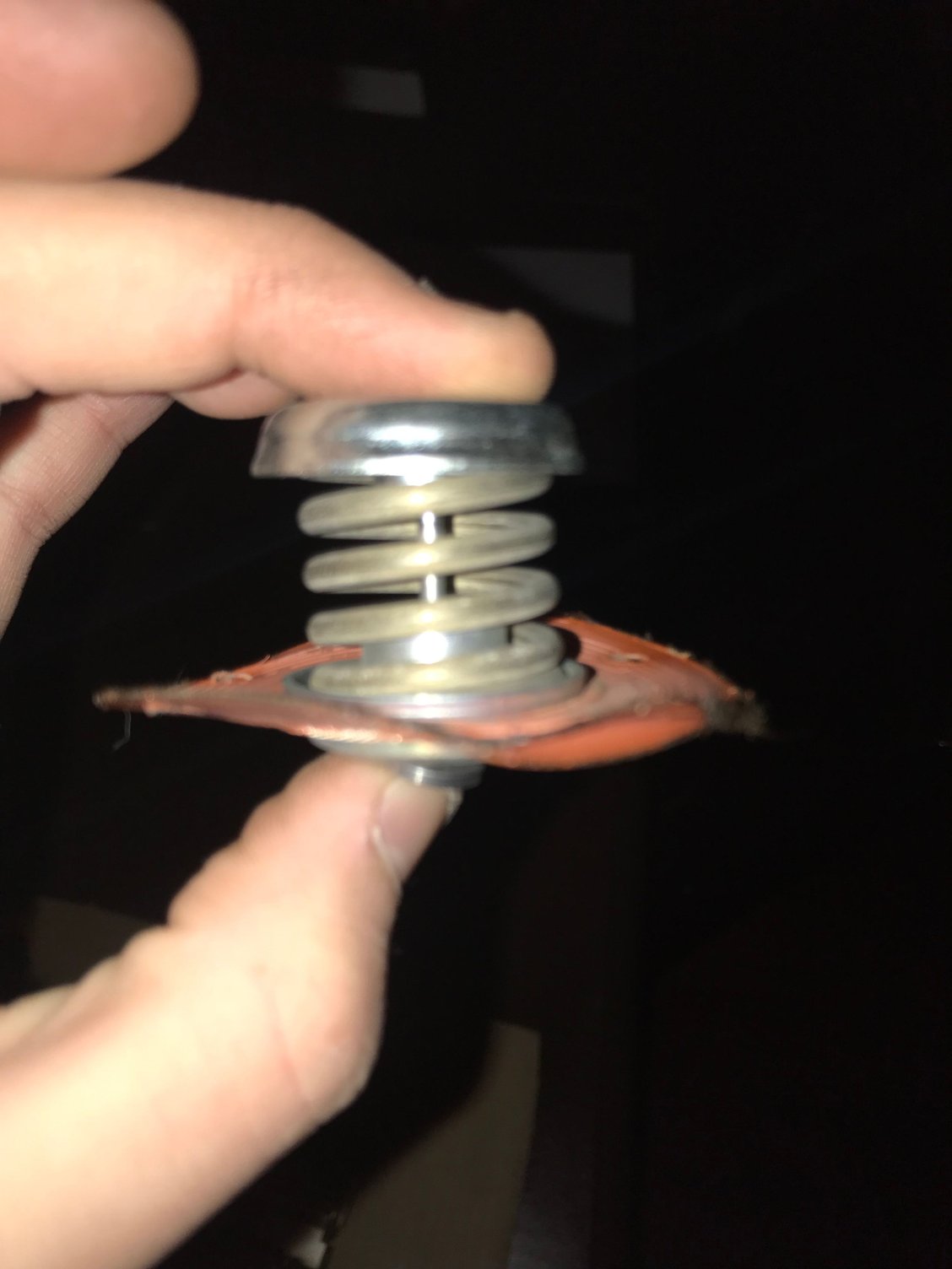

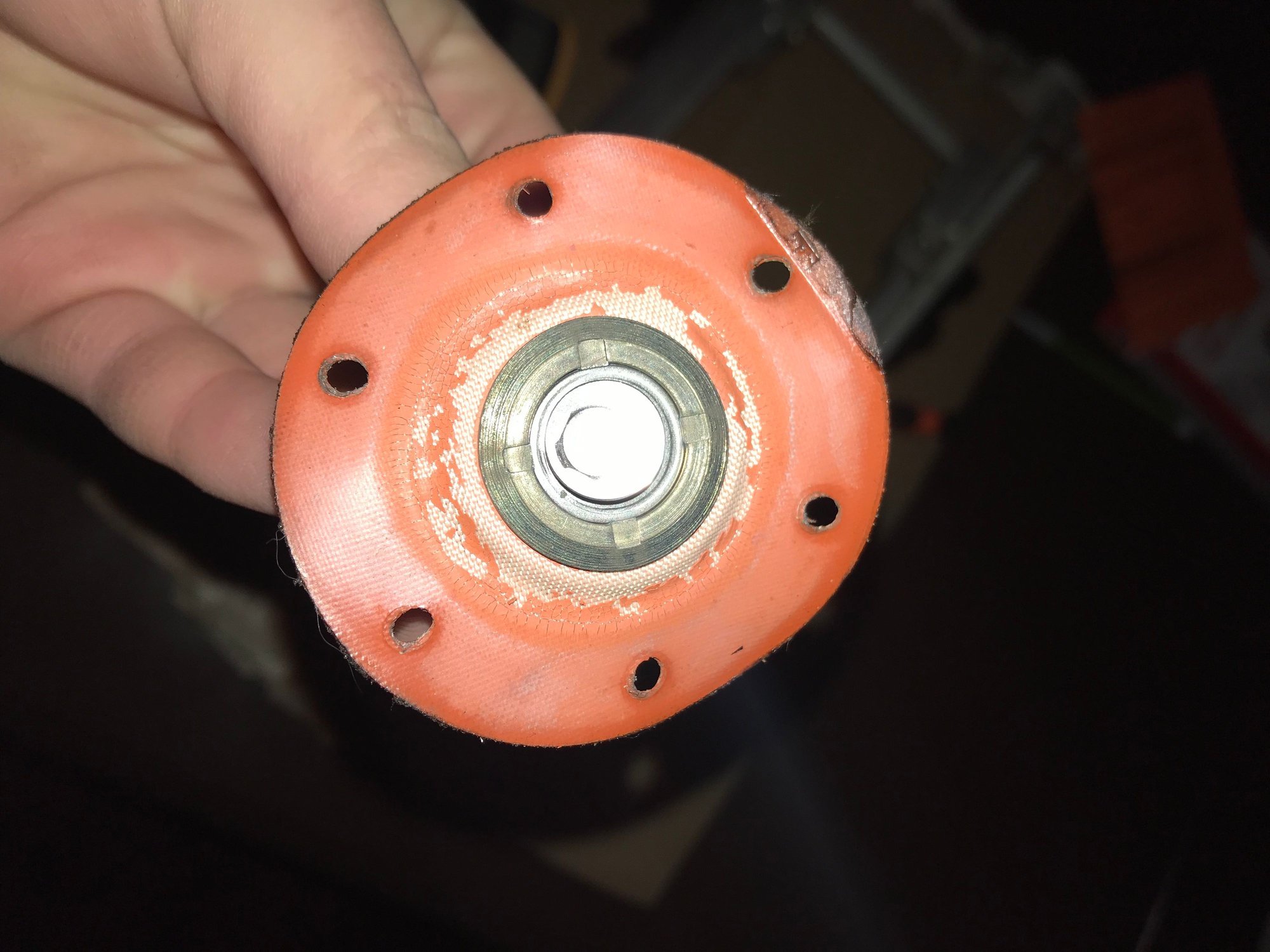

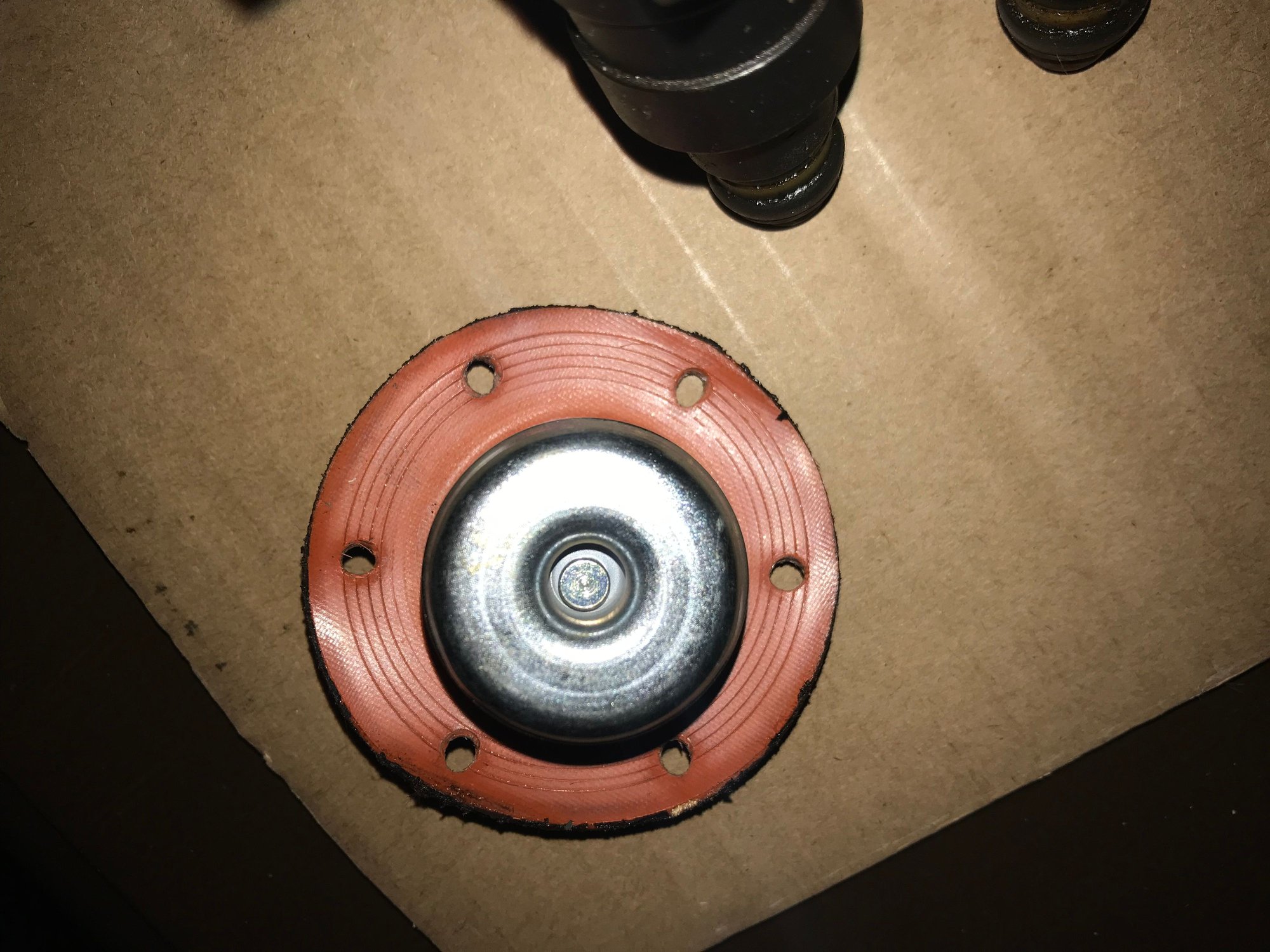

great. Thank you for the responses. I took the diaphragm out and looked at it. The material/ orange stuff was flacking off towards the center and I was wondering if that means it’s going bad? I’ve test idle pressure and it’s been ok but it drop suddenly when shut off. It’s goes to 0 after a few mins. I have another forum that I posted with the full detail but to sum it up, the car needs to turn over quite a bit to get it going. But if I leave it sit for a week it’s starts instantly. But 1 hr after? Hard start. Not sure. Hoping this Diaphragm could maybe solve it? I’ll post a picture of it. Thanks!

First, YES, replace that diaphragm. The coating should not be flaking off. The material is coming off of the "fuel" side of the diaphragm and heading straight for the injectors.
Secondly, you will not be able to diagnose your hard start issue properly until everything is put back together and you can diagnose your issue methodically. Can that diaphragm cause your issues? Yes. Is it a sure that that is the problem? No. Your fuel pump can cause pressure bleed down after shut off as well. So don't try to fix what you can't properly diagnose until you replace your injectors, that diaphragm, and get your car running again.
Do you have a Factory Service Manual? If not, buy one now. I can't stress the importance of owning the service manual enough. It will walk you methodically step-by-step through any problem you could encounter on your car, and save you from having to ask (and wait for) solutions on a forum that may or may not take you through the steps in the proper order required to correctly diagnose an issue.
