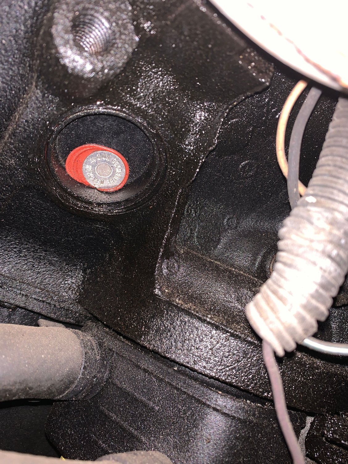

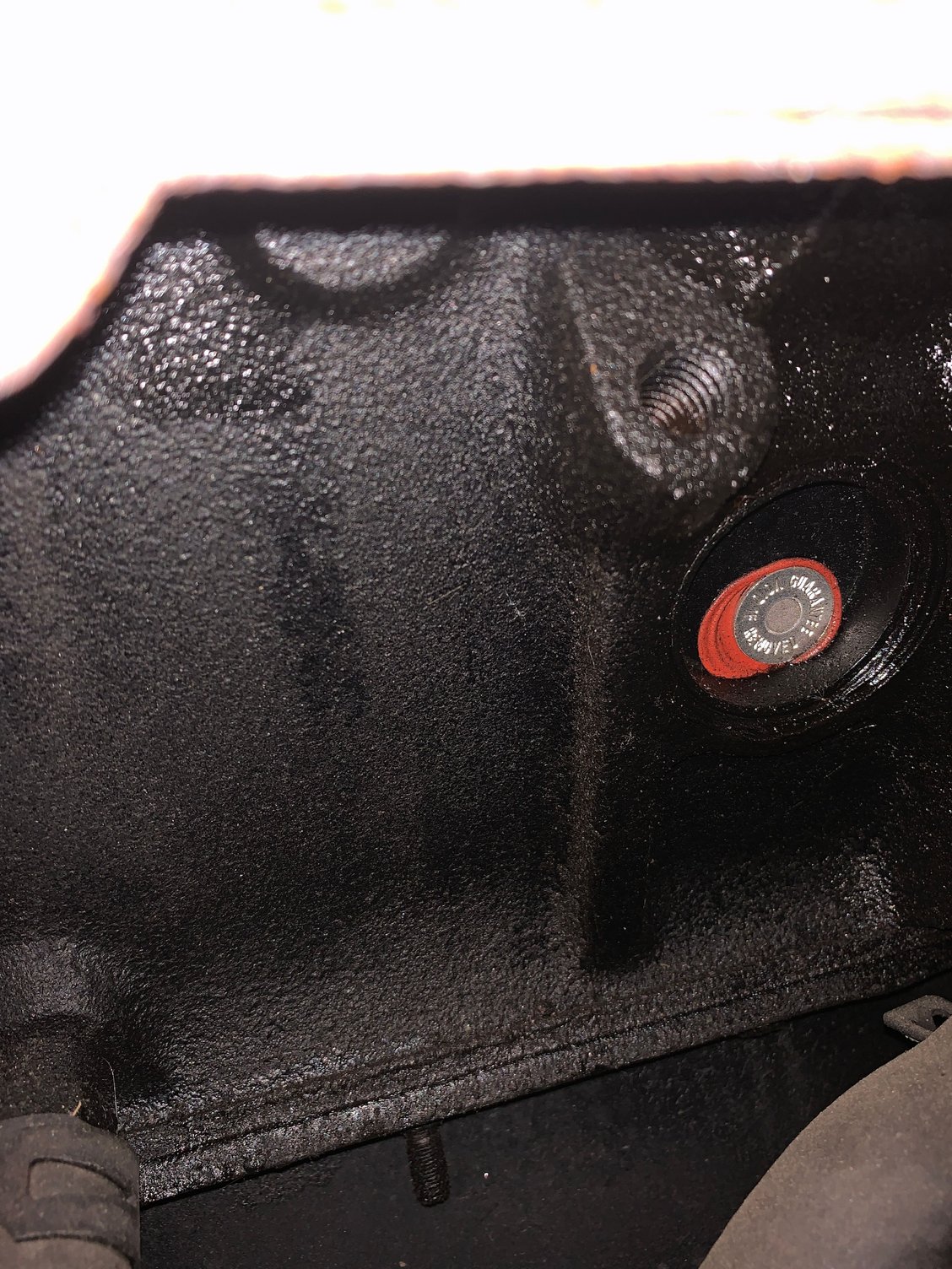

Another update, Corvette down (temporarily).
Took it out for a fun backroads drive on Friday, and things went south. Ambient temps were approximately 90F with high humidity. Had sudden loss of power, and noticed that oil was hot, approaching 255F, and coolant was around 225. Immediately started towards home. Noticed no smoke. Made it into the garage without temperature climbing further from prior numbers, shut it down. The heat coming off the engine was intense enough that I decided to look into it the next day.
Tried to drive on Saturday, just to see if it was temp related. No improvement, got home and shut it down before it warmed up. Also thought I heard a faint “induction” type sound under throttle, but can’t be sure.
Noticed oil on the ground from after my drive on Friday. Not a huge amount, but enough to be concerned. Both passenger and a drivers side are wet at rear of block under the headers. Not the greatest pics, but they served their purpose to show me the ballpark of where the oil was coming from.
Have not had chance to drain some oil to check for coolant, but it passed the dipstick test and looking in the oil cap showed nothing abnormal- but that doesn’t mean much. Have some ideas, but advice would be appreciated. Have done no additional disassembly or troubleshooting beyond what is described here. Really need to clean and reorganize my garage so I actually have space to work with...
