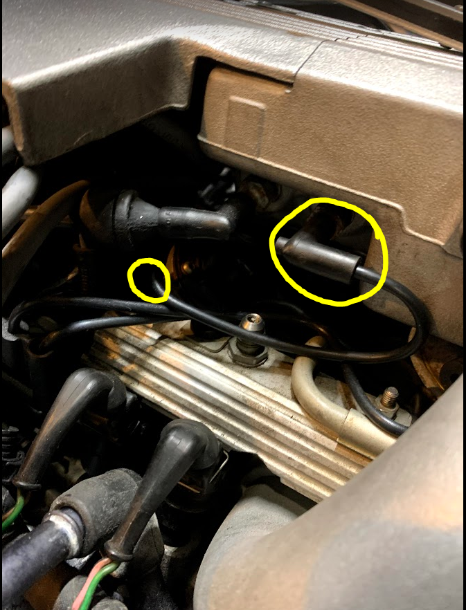

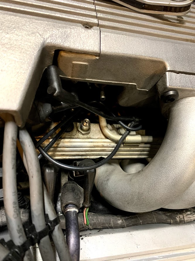

Well I am doing the same, and deleting the EGR stuff as well.....What do you do with the sensor that goes in the A.I.R. pipe at the pass side rear of the intake when deleting the EGR system?

You can cap those air manifolds with an appropriately sized bolt and a hose clamp at the rubber hoses. To be completely honest with you if you want to clean up the look under the bonnet all that **** needs to go and a decent set of header should be installed. I don’t know how many pints of blood I left on the sheet metal whilst changing spark plugs but that’s just my opinion. With regard to the exhaust drone any good exhaust shop should be able to offer a solution. Mine doesn’t drone and I have long tube headers and 2.25” straight through pipes into x-force mufflers.
with regard to the wiring, simply disconnect it it shouldn’t worry the ECM it’s control wiring not sensor wiring and that goes for the ERG valve as well. It’s easy enough to test simply disconnect it and go for a drive.

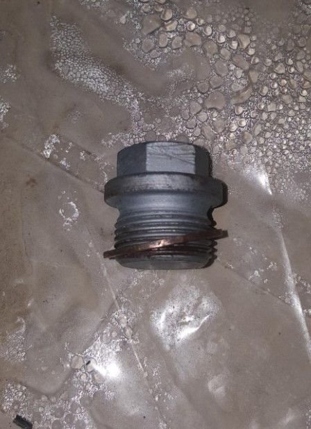

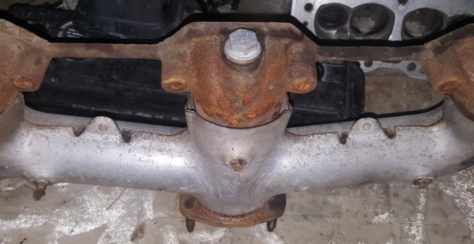

Originally Posted by Bfenty
thanks for the help. For now I’ll leave the headers alone. I don’t have to pass emissions at all so no worries at all there. What should I use to cap off the exhaust? Where else do I need to cap, and what’s the best way to do it without damaging anything permanently?
As for the cat, my only concern with removal is drone. I don’t want the car to be unbearable to drive. I’ve got a full dual straight pipe exhaust sitting in my garage but it droned so badly I couldn’t stand it.
This is what I used to cap of the exhaust manifold, 22 mm end bolt and a copper washer.
I didn't realize you could remove those stupid bar things above the manifolds (no idea what they are called). That would be even better!

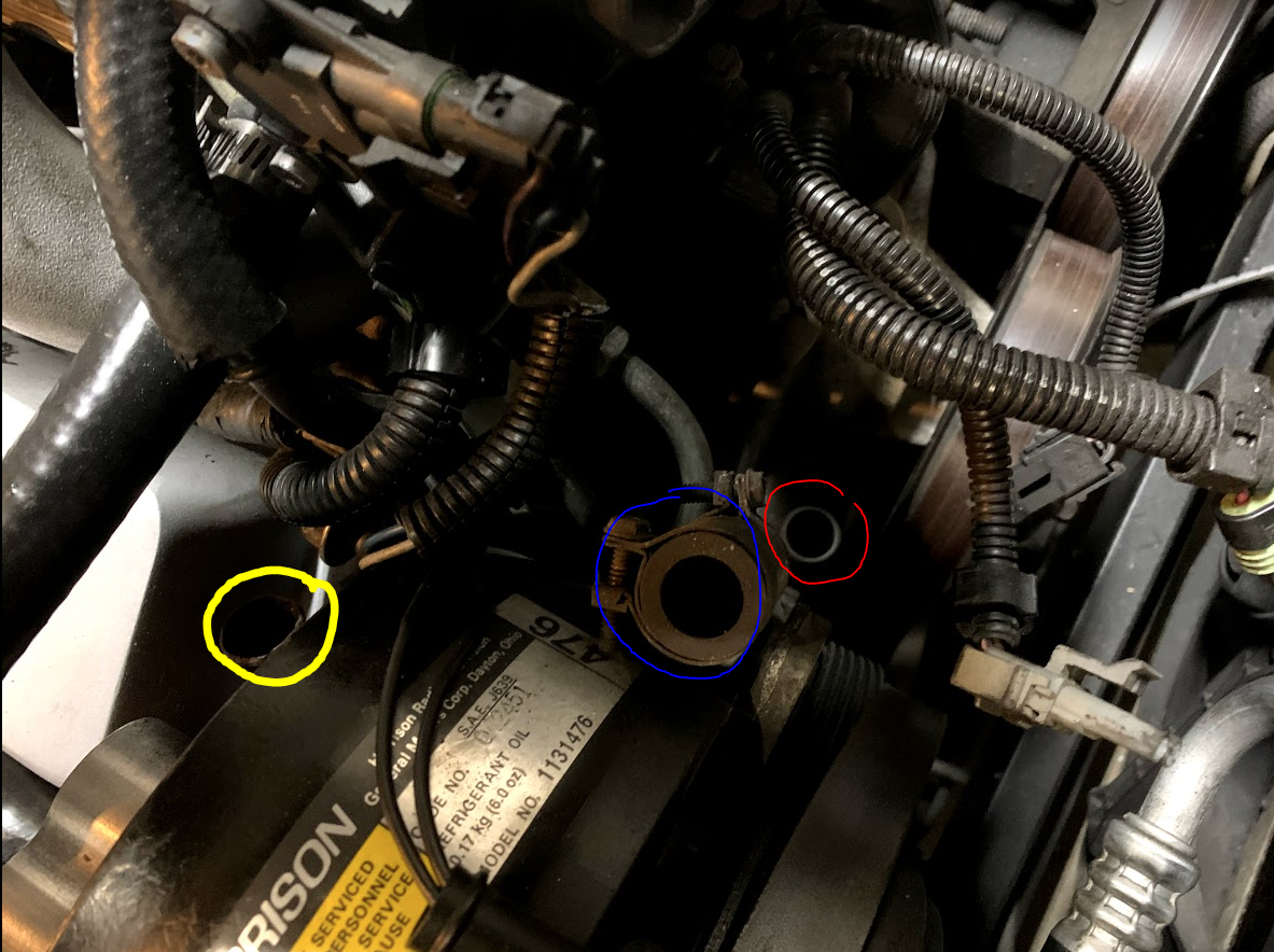

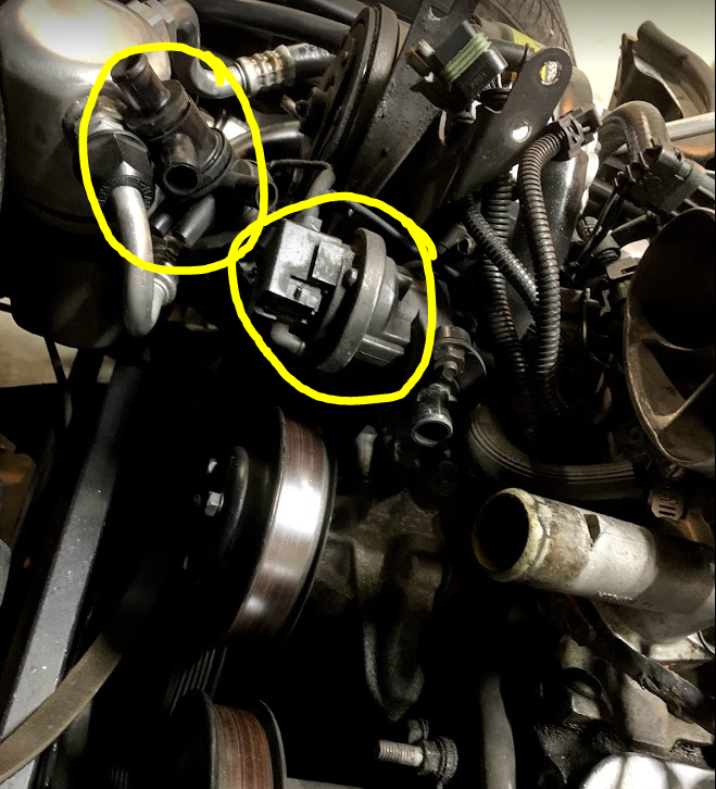

I actually got into this job today. So far it's been pretty straightforward, although some pieces have been stubborn (namely the pipe that goes between the exhaust manifolds). I've got a few questions to make sure I'm not doing anything stupid here. Can you guys take a look at the photos and notes below and help me answer my questions? I can't tell where all of these pipes are going, and whether or not I need to cap any of them off, as well as the fuel regulator vac line (I took out the Y intersection and directly connected from the plenum to the regulator-no idea if that's ok).
Thanks for all the help! I'm already loving how much cleaner the engine bay is!
Yellow goes to the exhaust manifolds. Blue goes to the cat (I think). I can't tell what Red goes to, does anyone know?
I took out the Y intersection that went to the AIR system and bent it around to go straight to the fuel regulator-will that work?
The fuel regulator with the Y intersection before I modified it.
I'm not sure what either of these things actually DOES, but I removed both of them as well as the smog pump. I have a eliminator pulley coming in the mail tomorrow.

Everything you have done looks ok. I forgot about the one way valves as mentioned above so disregard my comments about capping the hoses. The pipe the goes between the two manifolds is a bugger to get out, I ran out patients and cut it in half, it comes out easy then. I guess you don’t have that option f you want to keep all the parts.

I’d like to take it out, but if I can’t is there a problem leaving it? Can you help me ID the other hoses? If I were to try to start it right now, would that be ok? Assuming, obviously, that I get the belt and pulley back on. I’m going to keep removing poppies as much as I can but I want to make sure I’m not risking anything if I leave some parts on that are buried. Particularly the pipe that goes down the front of the engine. I don’t know where that goes or what it does.
