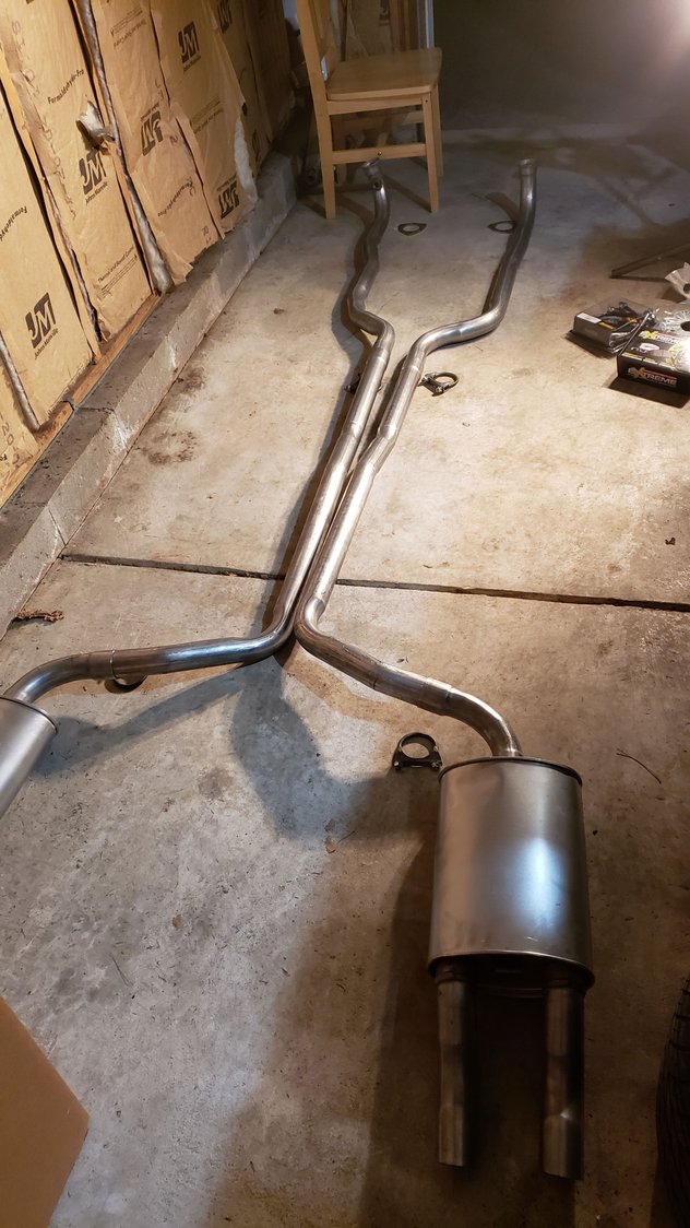

I just did the AIR delete on my 85 last week. I left the original hoses on the manifold check valves as my check valves leak just a little bit of exhaust. I just clamped a large bolt in each hose for now. That metal crossover tube was a royal pain. Unless you want to remove your AC compressor, I don't think it is possible to get out in one piece.

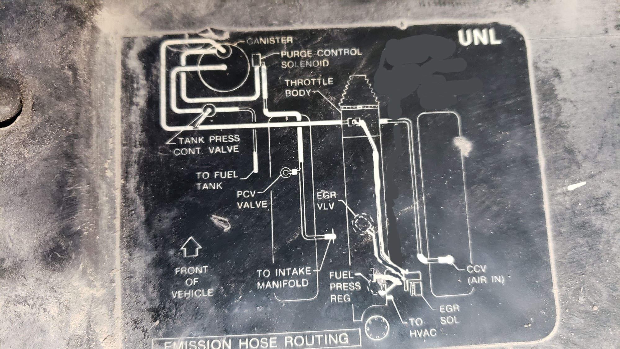

I ran a new vacuum line to replace what used to go to the air solenoids. It was a good opportunity to go over all the vacuum lines on the car and I found a few hooked up incorrectly.
I had a check engine light after removing the AIR system, I didn't check the code but once I cleared the memory and reconnected the AIR solenoids it went away. The solenoid assemblies come apart which makes it easier to leave them connected and tie them up out of the way somewhere.
I am installing an offroad dual exhaust from Allen's Stainless Exhaust, so I won't have a cat to worry about.

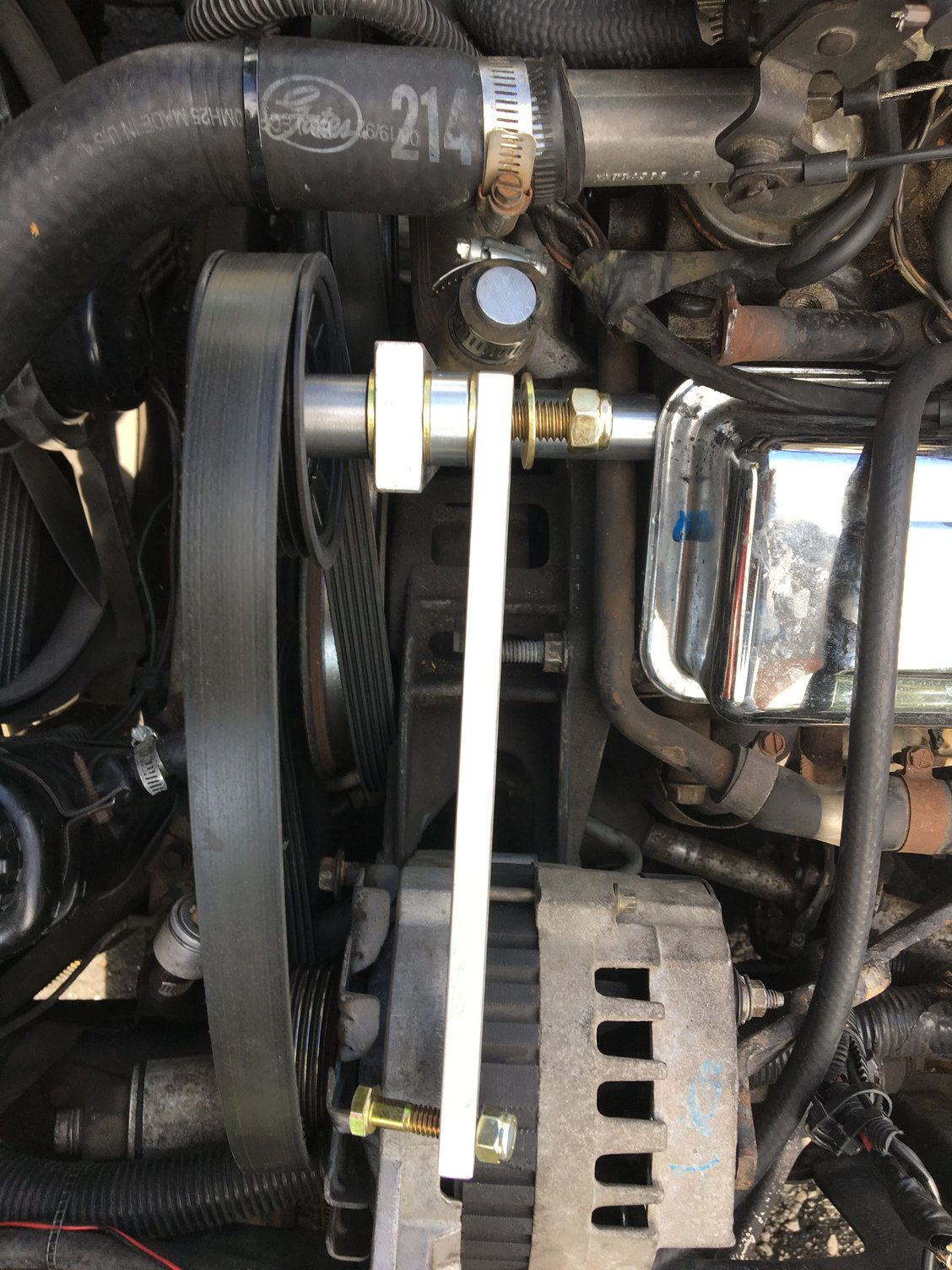

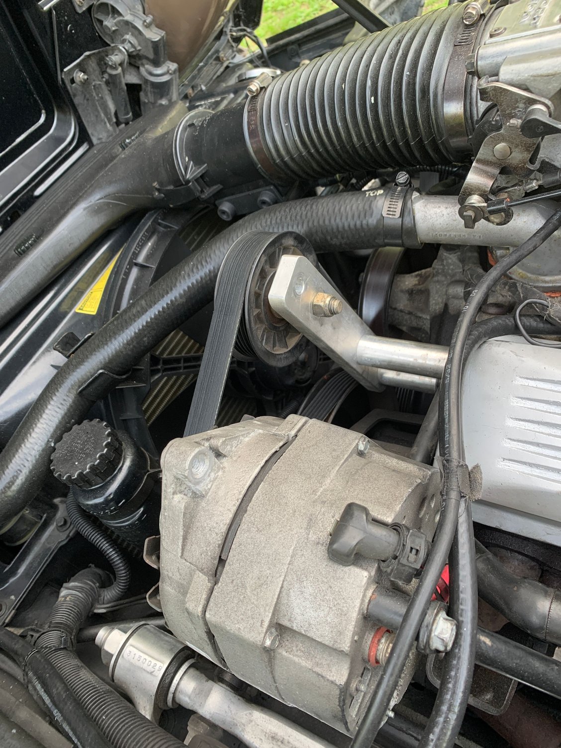

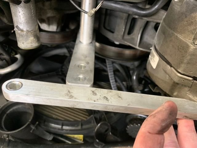

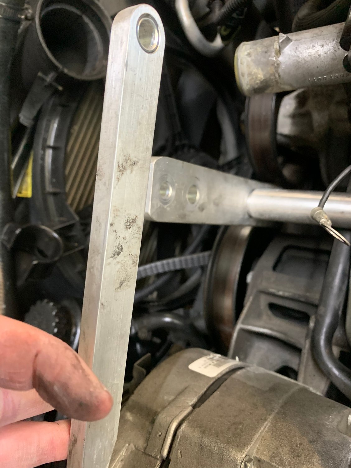

So I got it all back together. Car runs great. I know it’s not supposed to affect horsepower but it feels stronger. I think i had a small vacuum leak.
only thing is that the bracket for the alternator connection is too long. It doesn’t connect. I’m not sure how big an issue that is, it’s very solid as is and doesn’t appear to be in danger of moving. Thoughts?
It’s WAY too long

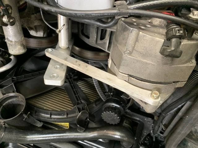

This seems to work without issues

There can be a fair bit of vibration on the alternator and pulley assembly so it would be better to have a bracket. I don’t know why it doesn’t fit but maybe your alternator has been replaced with a different model. Your alternator looks different to mine, mine is a Bosch but I always figured mine was non genuine.
Edit: you could always cut and drill that bracket or fabricate a new one.

The old bracket fit just fine..,
I’ll get access to a drill press and put another hole in the thing. Not a huge deal I guess.
EDIT: I contacted the person that sold me this bracket (another forum member), and he said that the idea is you remove the rear bracket from the alternator and rotate the alternator outwards. Personally, I'm not sure why you would do that. Maybe it's for belt fitment? I'm thinking I'll just drill another hole, as I'd prefer not to move the alternator around.

Yes you do rotate the alternator outwards and the rear support no longer fits. The upper support from the eliminator is enough.
The rear alternator support isn't important like the rear Compressor support, because the compressor bracket is weak-*** pot metal and the engine torque will cause it to crack and also take out your tensioner. Although the bracket on 84-87 isnt as shitty as what comes on 88+ in my opinion.

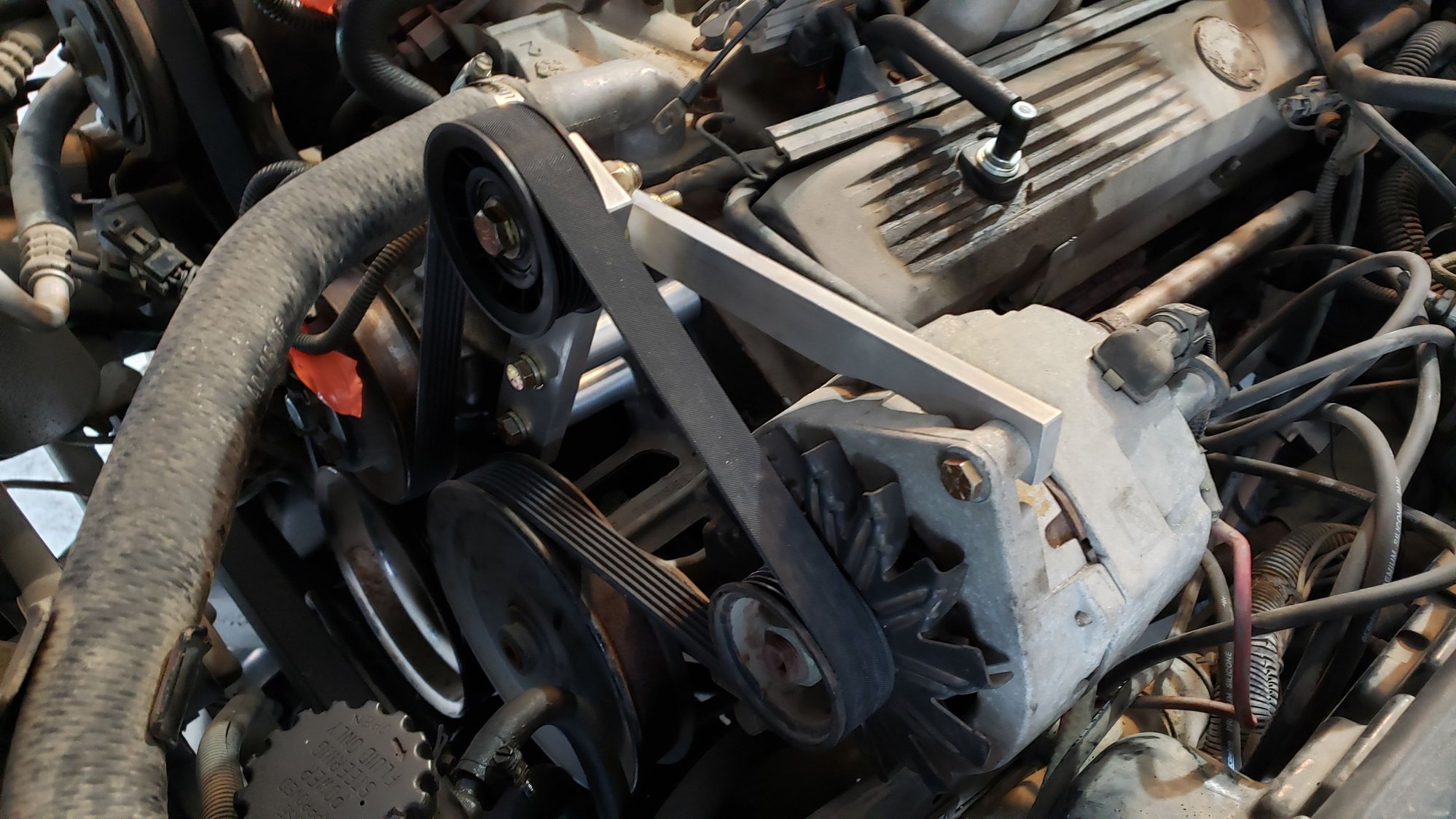

Attachment 48343035 I bought the $99 one off Ebay. It even came with an aluminum pulley instead of plastic. Note hole used to keep factory serpentine belt.
