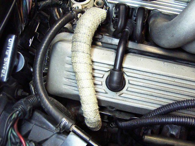

The pic shows that there is no water passage across the rear.

Correct, not trying to be funny or cute, thought the picture would get the point across better.

Tommy, the intake is blocked off except for a very small hose on the passanger side that allows steam to be vented in the corvette since the manifold is higher then the radiator and GM did not want a steam pocket to develop in the head which would lead to detonation. What you are looking at is the the passanger side of the intake where the steam port is located. The drivers side is blocked off, there is no crossflow. The cylinder heads are symetrical so you can use them on either side of the engine, that is why there is a port at the back. If you study the flow you will see that there is no flow from the rear ports. Hope this helps.
