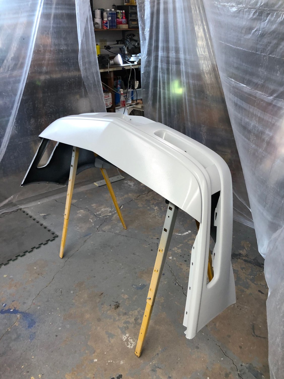

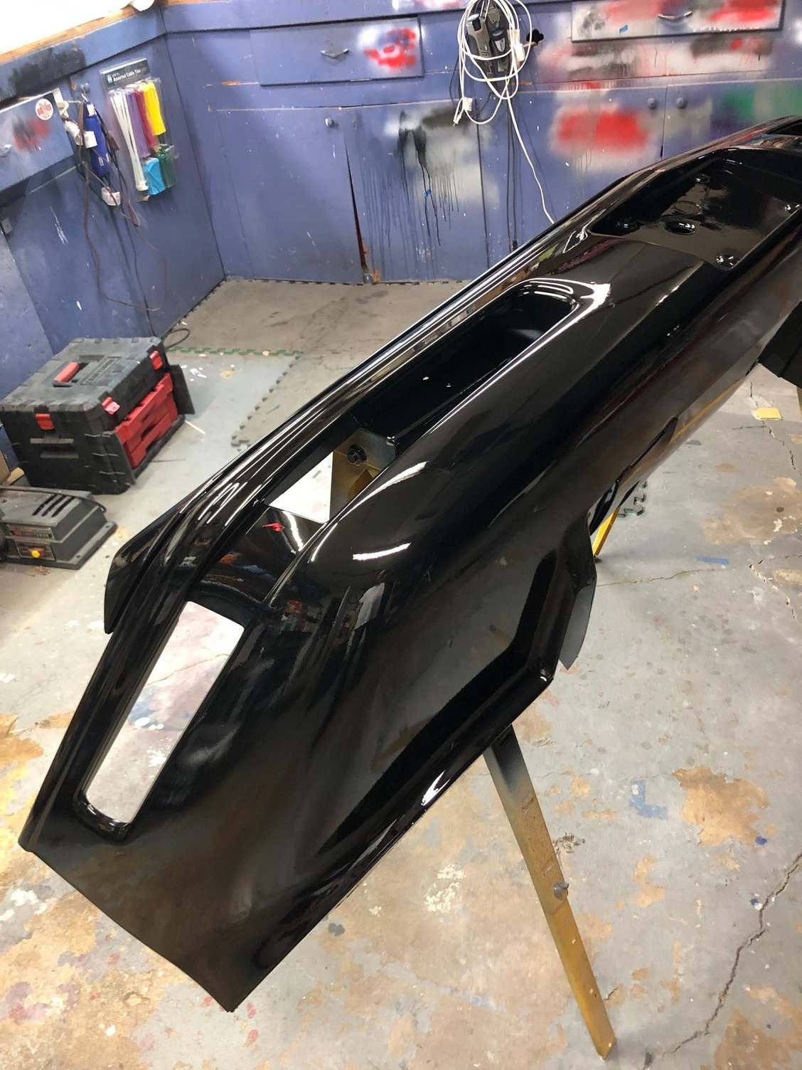

Weather kind of went south over the weekend so I decided to finish up the front bumper. I took it off when I painted the car recently.
The bumper came out pretty good. Buffing this out will be a nightmare. But I plan go slow and do it by hand. I have some bumper support parts on the way. As soon as they show up I can get it back on the car.

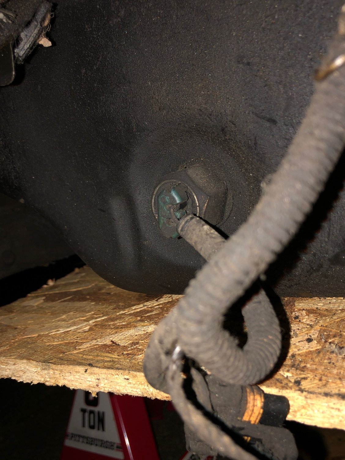

I was able to locate a 12mm Hex wrench and loosen the ball stud and get the bell housing loose. I found metal shavings in the bell housing??? See pic. The edge of the clutch looks like its been rubbing something. What could that be. The inside of the bell housing looks ok??
Also there is a wire attached the oil pan inside a huge bolt. I can't see how to get that wire unplugged. Any ideas? It is insane how many wires are plugged into this thing. There is no way I ill get all of them back in place.

9T3VETTE's Avatar
9T3VETTE
Joined: May 2007
Posts: 1,426
Likes: 165
From: Motor City
The bolt attached to the pan is the oil level sensor. Be VERY careful and take the blue clip off, then unscrew the oil level sensor from the side of the pan. However, I'd wait to take the sensor out until the motor is out. The sensor shaft is long and can be difficult to get out with limited room under the car.

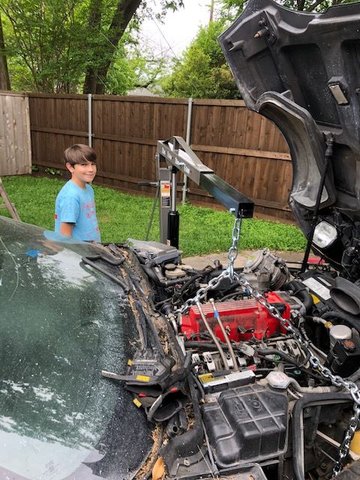

Likes: 105

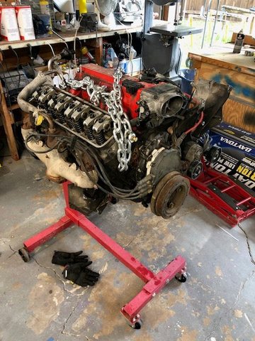

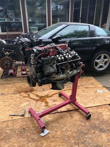

Future gear head helped me get the motor out yesterday. He worked the hoist and I wiggled things around and came right out. Then he said we had to go fishing. So we did, I mean what are you going to do when they say we have to go fishing?

Couple of questions as I’m undertaking this in the next couple of months.
Where did you bolt the hoist chain to? Also, I’m assuming you removed the bell housing with the engine in the car? Many people suggest removing the engine with bell housing attached. Curious about your lessons learned..

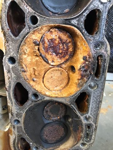

I bolted the front chain bolt to head where the coil was mounted. I bolted the chain to the last intake bolt. I used grade 8 bolts.
Then I removed the head to find this. Might just derail the whole project.

mtwoolford's Avatar
mtwoolford
Joined: Jan 2009
Posts: 3,482
Likes: 195
From: folsom california
Don't let "first impressions" discourage you; get in their with a power washer (or hot tank) and some WD40 (as in water displacing formulae number forty). It just looks like a blown head gasket; it'll probably clean up just fine.

cardo0's Avatar
cardo0
Joined: Oct 2002
Posts: 7,098
Likes: 378
From: Las Vegas - Just stop perpetuating myths please.
Cracked heads can be welded/repaired. Aluminum is much easier to weld than cast iron.
