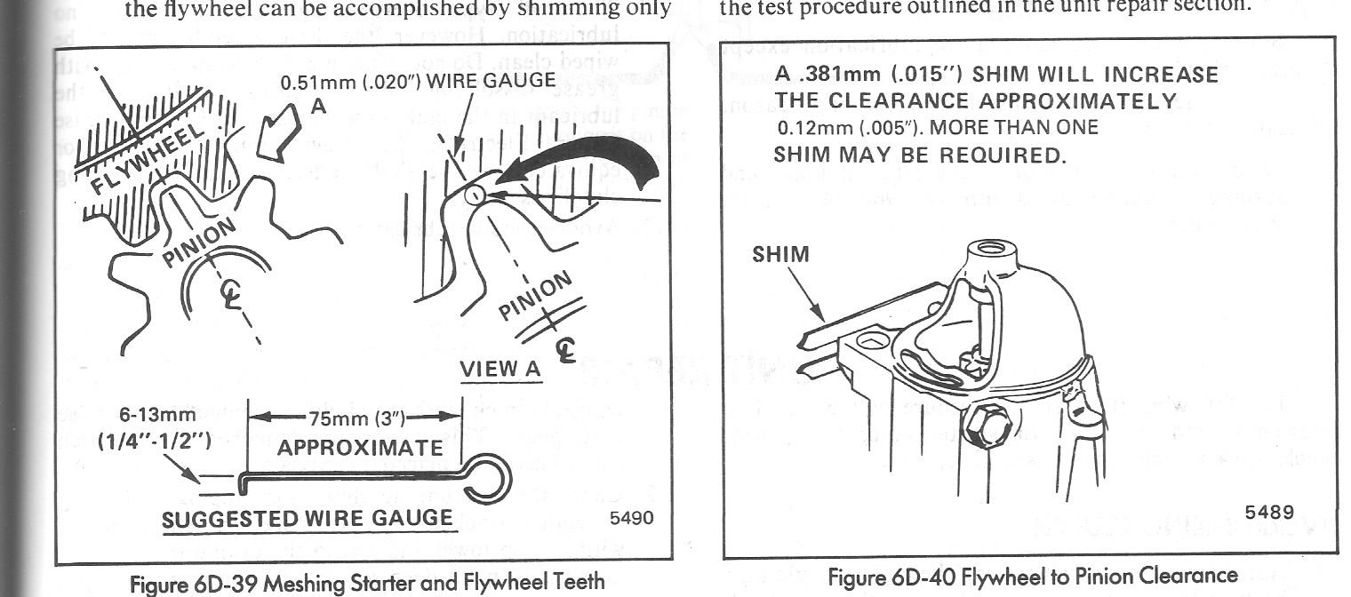

Maybe it's not shimmed correctly and binding. Did you check for the 1/8" clearance? Are you sure it's spinning and not just pushing the gear out? The solenoid pushes the gear out and sends power to the starter motor. If it's shimmed correctly and spinning, it seems like a bad solenoid to me. It gets ground from the block.

Did you return the core yet? If not, go get yours rebuilt.
I had a horror story with an 89 auto and reman starter. It took so many shims and was miserable

Did you read the instructions that would have been with the remanufactured starter? I'm sure the instructions would have described the procedure to add shims between the starter and the engine block. That is why the starter "connected with the flywheel at one point". There is no reason to rotate the engine to "top dead center". That has nothing to do with the installation of a starter.
