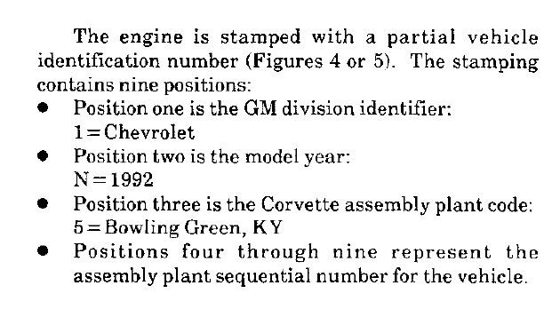

It was assembled on May 07. The casting date is on the rear bellhousing flange. If you want to be sure it was installed in a Corvette, the partial VIN is on a machined pad on the drivers side rear of the block, above the oil flilter, inline with the upper bellhousing bolt. Something like "N51xxxxx" where N is the year 1992, 5 is Bowling Green assembly plant (Corvette), 1 is car line identifier for that plant (ZR1 is a 5) and the xx,xxx is the sequential number beginning at 00,001.
NOT QUITE RIGHT -
NINE DIGIT EXPLANATION
I believe that a ZAC in '92 would be an A4 - NOT an M6

The 'NINE' digit partial VIN can be applied to any GM
The first digit is car-line (1) Chevrolet, (2) Pontiac, (3) Oldsmobile - you should catch on!! The 'last eight' of the partial will 'always' match the last 8 of the actual VIN. The rest of your comment I quoted is BS! What has an XLR have to do with any of the 'actual fact/description' of a GM partial/ NONE. My 'NINE DIGIT' explanation is directly from a GM FSM!

This is also 'WRONG' The first would be a partial for a '92 Corvette but the 'other' is 'NOTHING' - Had you wished to make a legitimate comparison you should have been a bit more careful. The 4th on a partial would have been an 8 if ZR-1 and 'NOT' a 5. You've I believe a '90 ZR-1 - you could check!!
Here's a random '90 and the partial would be 1L5802944
1G1YZ23J9L5802944
