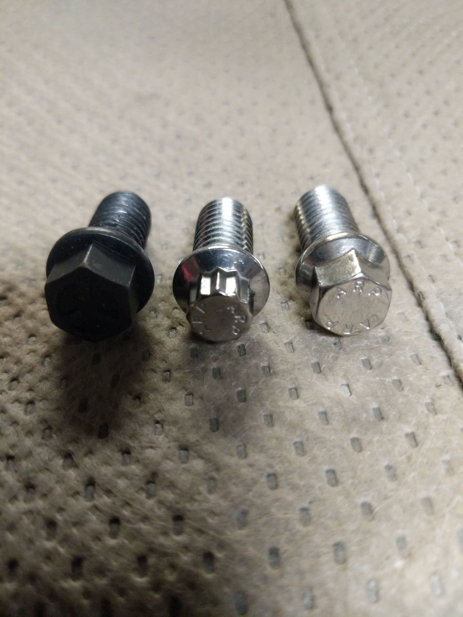

I did this on my 93, pretty straight forward job. couple tips. I highly recommend ARP header bolts with 5/16" head. gives you ability to get at least a box wrench on all bolts to get tight enough. open end 3/8 wont cut it. they'll come loose and waste gaskets, also insist on Felpro 1406 gaskets(not the junk that come with headers) you will see in pictures I show both. they will slide in very easy from underneath with some prep work. not sure if you have the luxury of a lift but I did mine on car ramps and was high enough. you will want to remove A/C compressor alternator and ASR, for really easy access. on passenger side you need to remove dip stick tube, and coolant temp sender from head. obviously you will loose about a gallon + of coolant. underneath on driver side it it best to remove the oil Temp sender(not a must) but it is probably brittle and if you break it good luck finding a replacement. cost me $50+ shipping for a NOS that I was very lucky to find and it's right in the path to shove them in place. one other thing I had to do was pull my motor mount bolts one at a time and stick back in from the opposite direction cause tips of bolts hit and I didn't want to damage ceramic coating. as far as removal of stock most likely all studs from manifolds to cats broke. there's a bracket holding passenger cat that 2 bolts are the bell housing bolts. This was my toughest task. I cut bracket. as far as cats to exhaust the DS will probably break all studs as well. I eliminated all EGR crap. if you are too you will need block off plates for back of intake. I made them with aluminum plate.

i used cheap black oxide allen head bolts for the headers. They did require a re-torque buT have held fine ever since.
i used allen head bolts bc it was easier for me to get an allen ‘key’ into tight spots then a wrench. I could also use short allen keys that attach to a ratchet wrench.
(no doubt though arp is the better hardware)

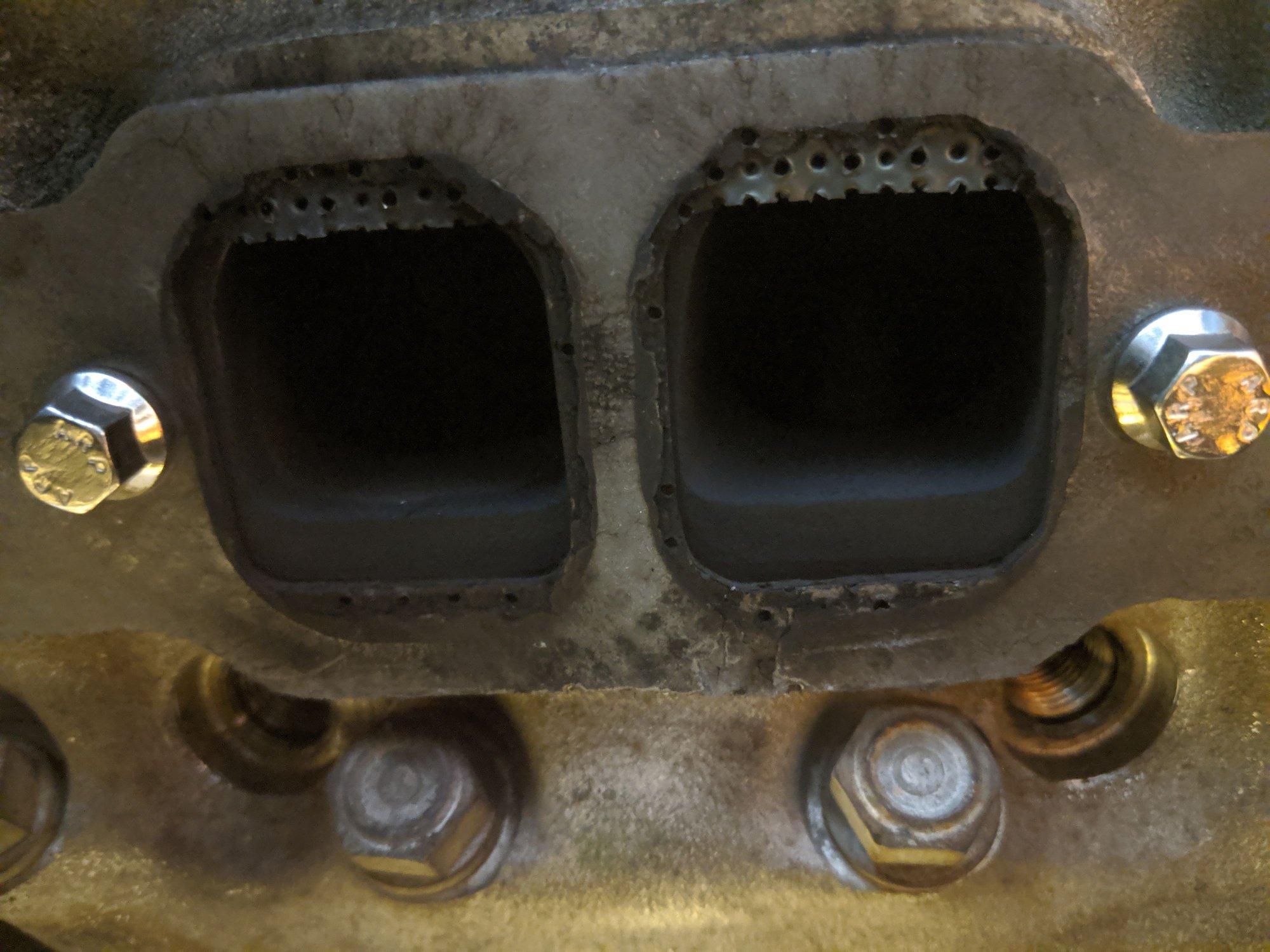

sbc have been notorious for stripping out header bolt threads in the heads, so here is what i do. get a 3/8 - 16 bottom tap and chase the threads all the way to the bottoms. then i use a header bolt that is 1 1/4" under head length. also use a double gasket

i had the same issue with my lt4 383 with arh 1 3/4 - 1 7/8 step headers with the canton pan. when i double gasketed the headers it gave me the clearance between the headers and the pan.

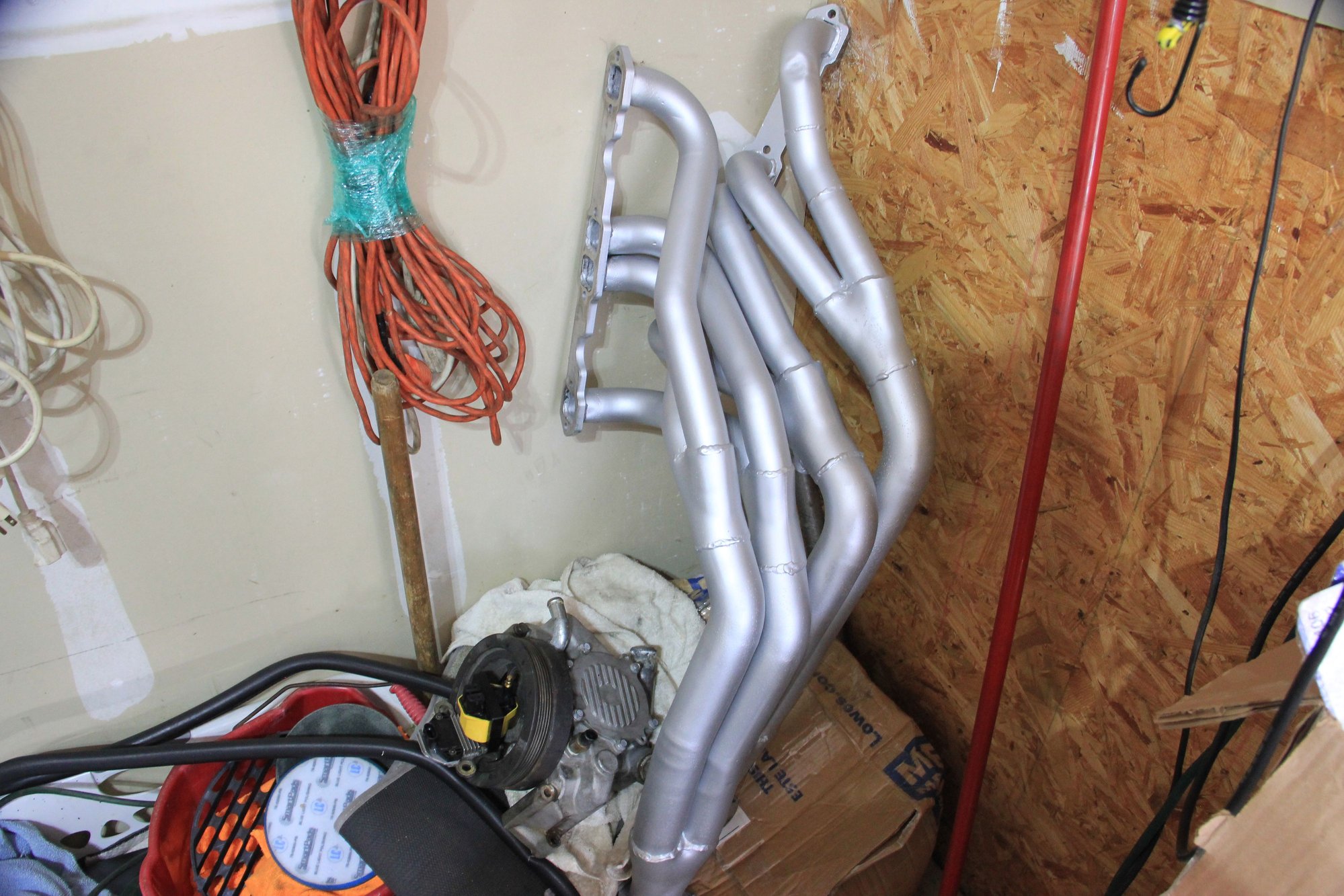

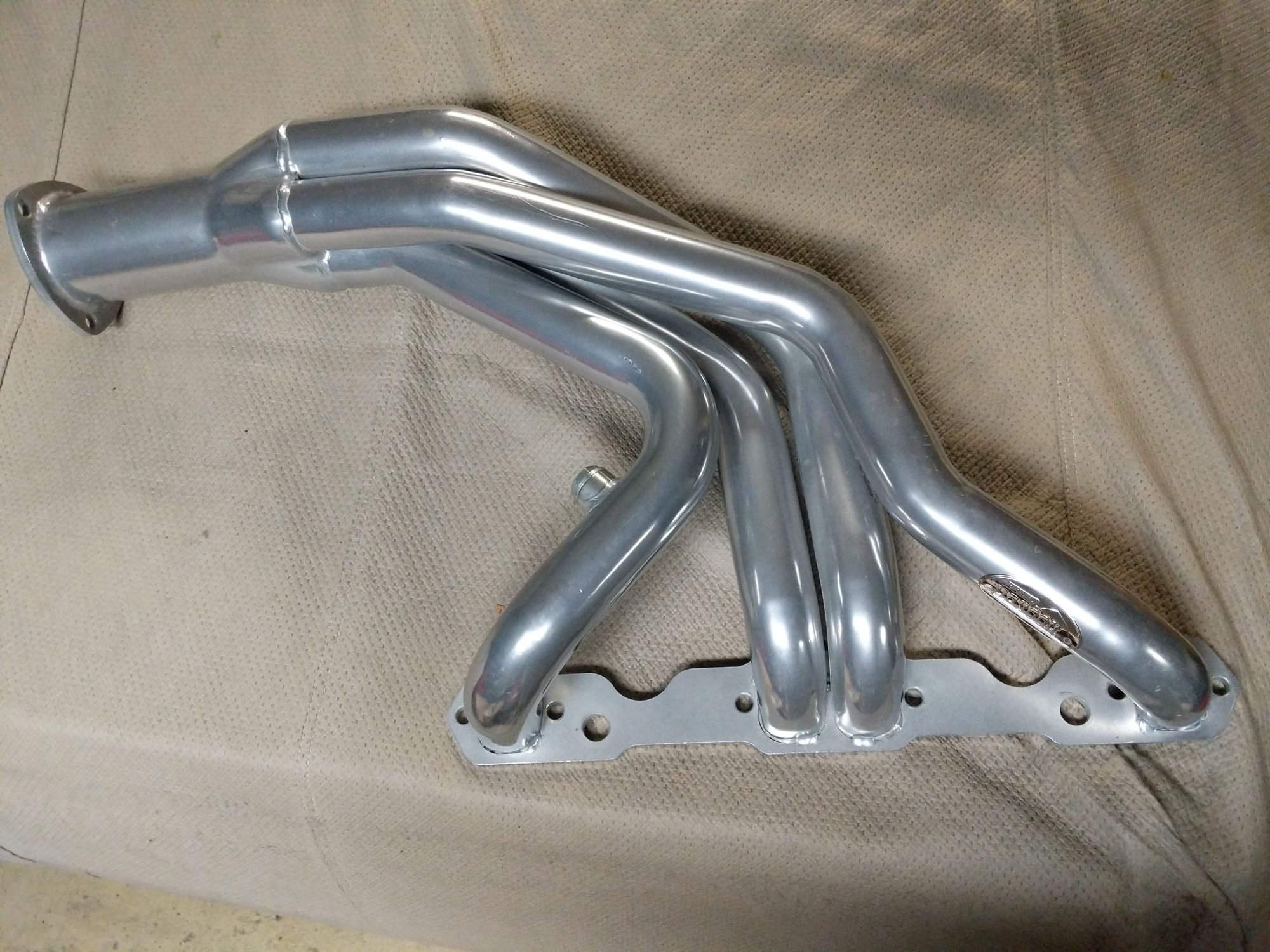

Thanks for taking your time to send all this info . I for sure will use all of it . These old headers I have are tri-ys NOS , coated I can't remember the brand but still in biz and still in the org. box , but not making these any
longer for this old 93 ,they are for a 93 ,EGR delete ,I got them relay cheap old Corvette old headers ( just something to do ) I have been doing other projects and have for just yesterday gotten all the hardware to install ( I got the good stuff ) not going cheap with gaskets bolts ETC.. I have the right stuff I hope ..
I don't get the deal take starter off install headers and put starter back on ,seems if the starter was in the way on install it would be in the way after install .. I grues I will see the deal when I get into it .. Thanks ,this kind for info relay helps ..
I take pic ..

I don't think it will be big deal with all the info I have . The striped bolt deal I B taping and two gaskets .One thing I do is leave NOTHING to chance , I drive my Corvette all over the country I do not need to be on side of the road calling AAA . I have had good luck over the years and going to do my best to keep it that way . That's why I ask : I need some header install advise and will use it all . Thanks ..

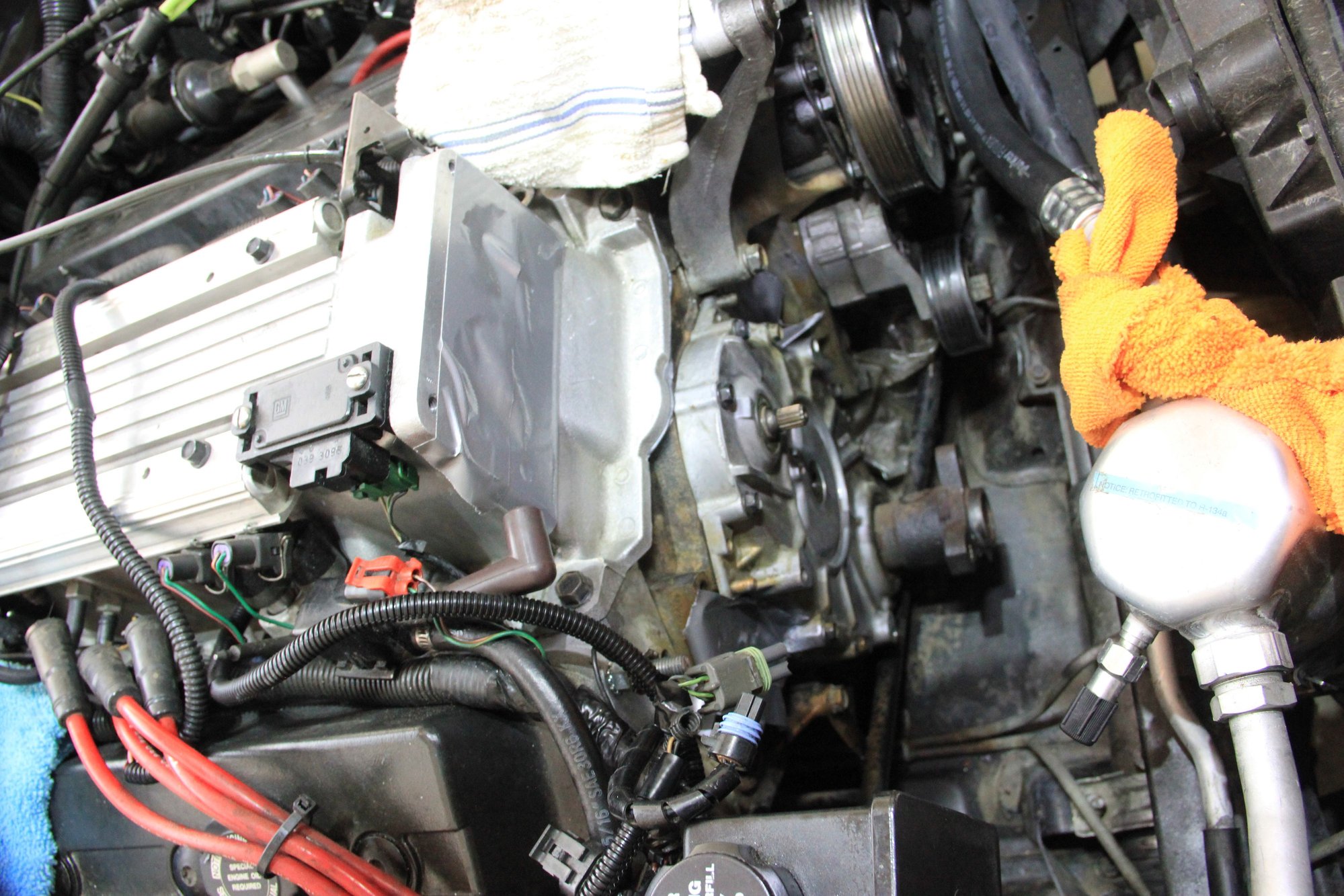

UPDATE : BAD EMC . Could not be rebuilt . I have figure out finding what the hell is wrong with my old C-4 is not as easy as one might say all you got to do is check RIGHT no some times not that easy
Some times the EMC would work and sometimes not it cranked and run a few times for a short time 1 min. then nothing them later do it again ??? So sometimes power here and there sometimes not .
Sometimes the ICM had power them nuting . I was thinking the OPTI was bad ?? so new OPTI , was under warranty so FREE YEA (Not a cheap one ) they sent a new one OK , nothing changed so new ICM not it , nothing changed new coil not it . Still crank and run for a min. them nothing .. Checked the speed sensors all good .
Sent off the EMC the mother board shorted out DOA and it was doing the same with the testing guy sometimes worked sometimes not so new on the way . NOT cheap .. So what do you do ..

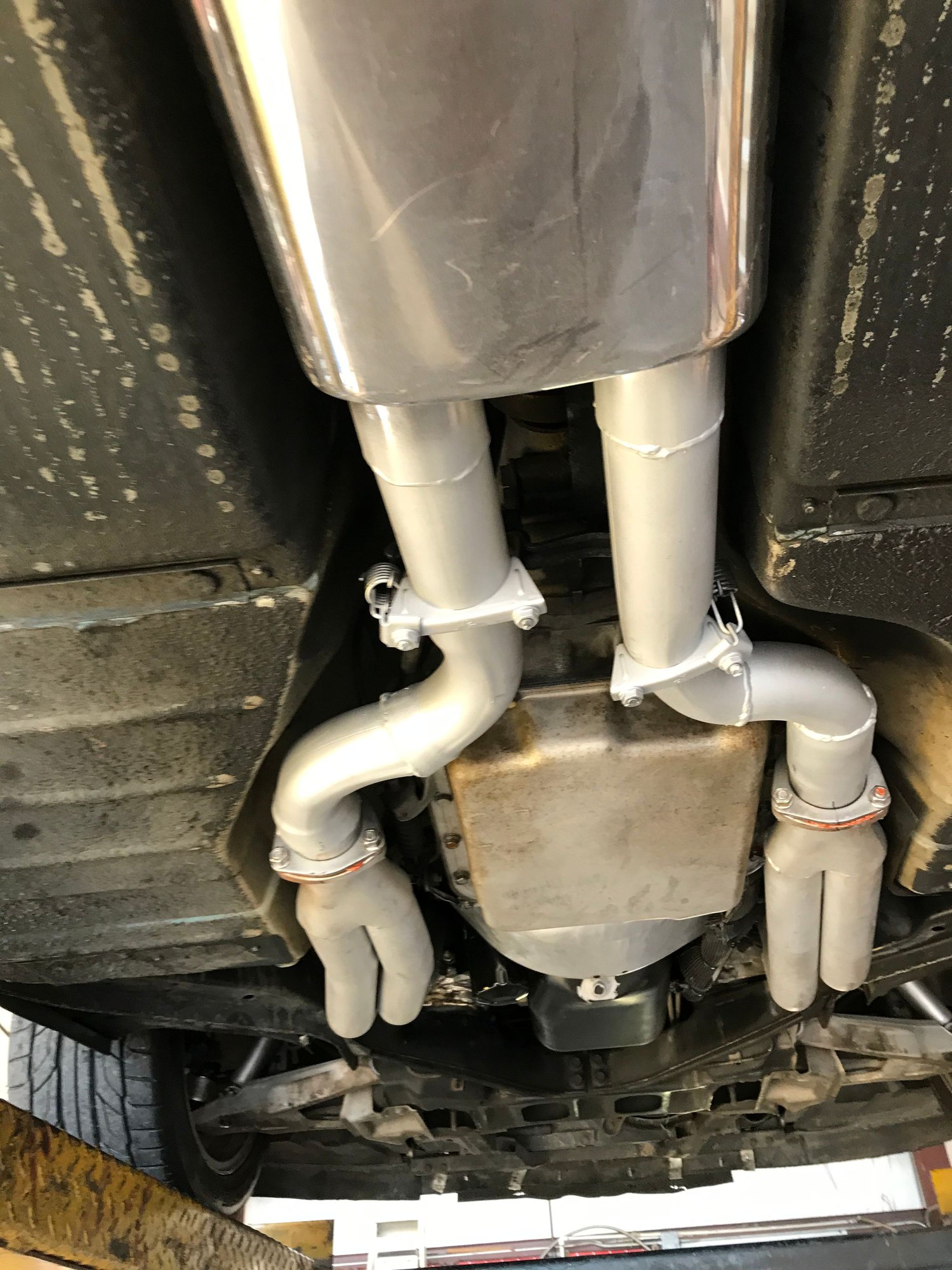

Good question LOL I have not cranked it yet just finished it yesterday will be cranking today and going to the Muffler shop to tie it in to the rest of the system and will be installing LT-4 rockers as will ,got a set of LT-4 ORG. rockers and push rods and a retune chip all this should give it a little more pep .Film @ 11 ... I got a hot rod don't really need another one but had the headers got the rockers cheap so and had the 93 so why not .. I am just hoping it runs lot of changes for sure .. Let you know ..

Done finely ,does it run better HELL yes it does have a custom chip in it so the headers alone with out a chip I don't know if would make a difference or not , was in work yep lot's work . The resonator was replaced with a X-pipe from JEGS built in the stainless muffler looking deal sounds great and for sure has a little more get up and go ,was in worth it I think so . Thanks for all the help for the install advice used it all and made install WAY easer .. Now on the to the stock LT-4 roller rockers install ..
