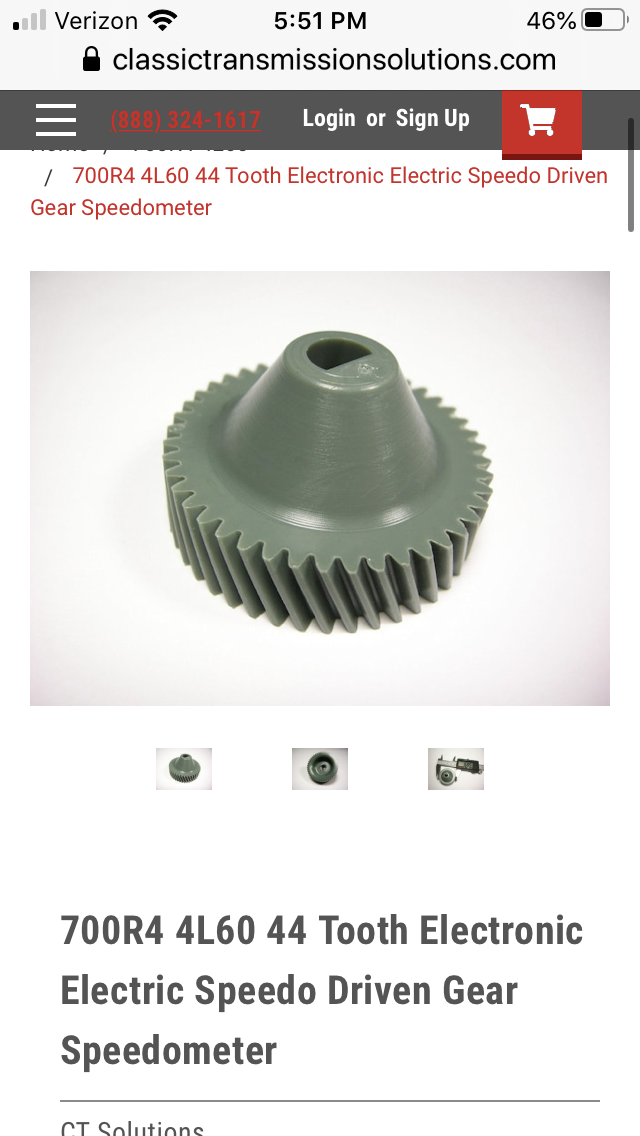

found photos online that look like the gears I have
Photos I found online indicating green driven, wife drive.... not sure it yields 3.45 translation.
looks like I have 19 drive / 44 driven teeth

[QUOTE=BPontuti;1601515556]
I can assure you that's incorrect!!! A 'gray' drive might snapshot as 'white' but I didn't recall the gray being that light!! Your 'green' gear I'm quite sure will have a 42 on it!!
If you used your old VSS and it has 10456091 ( OE for a D36 & 2.59) stamped on it, that's what started your situation. If your VSS wasn't original post the info like you were asked several days ago. Does your console lid SPID mention D8K?

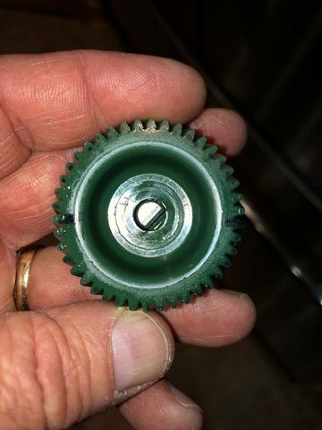

Thanks for your help WVZR and sorry for the delays in getting proper responses. I was on the road this afternoon. So to answer a few of your questions I can't verify drive gear color yet as the car is off of jack stands... I'll have to get at it again tomorrow and check). Here you go:
  • Replaced D36 with 3.45 D44
  • VSS is original equipment. Rear gearing from factory (C4 base auto) was 2.59 Dana 36
  • The green gear has two "4"s stamped inside 180 from each other across the axis. See photo below.
  • I cannot confirm color of the drive gear however it looked snow white when I viewed with an LED light. Can I remove to check without major tail section disassembly?
  • THERE IS A HIGH LIKELIHOOD that you are absolutely correct and the gearing in not correct. I purchased the change gear set from one of the equipment suppliers I used in acquiring parts. The gears were new and I believe they were purchased through Exotic Muscle which were supposed to be the correct combo for a D44 3.45
  • The REAR TIRE size is P315/35ZR17
Any help you can provide in helping me determine what gears I actually need would be quite helpful. Thanks again.
Difficult to see but for reference... you will need to zoom if possible

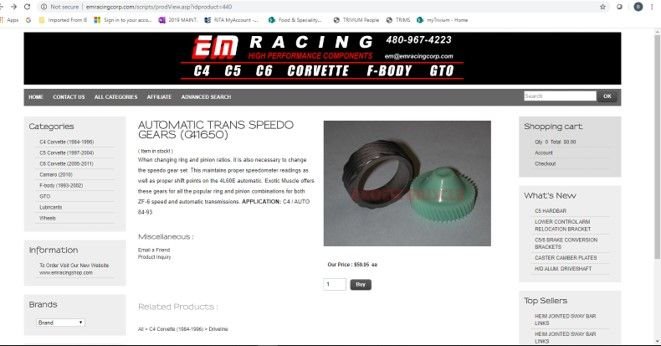

Again... I bought the speedo gear set from EM (below). I can call them on Monday to check into gear set that was sent.

Ok guys. I confirmed that the driven Green gear is. 42 tooth gear (marked and counted). Also, the drive gear does appear to be light grey (thanks to lighted camera probe). Now... it’s a matter of confirming and sourcing the VSS.
