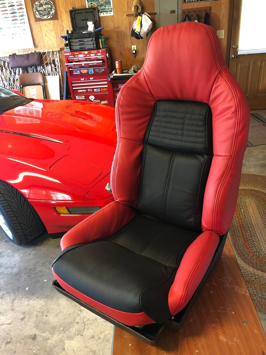

Interior. I want to replace all carpet, door panels, seat covers. Can anybody recommend a good company to order from?

Only question I can help with is seat covers. I got mine from ridies.com and they are excellent.

Thanks for the answers guys. I'm glad to hear the optispark isn't a big deal, I'll keep running it. I really like those seat covers puterami, thanks for pointing me in their direction.

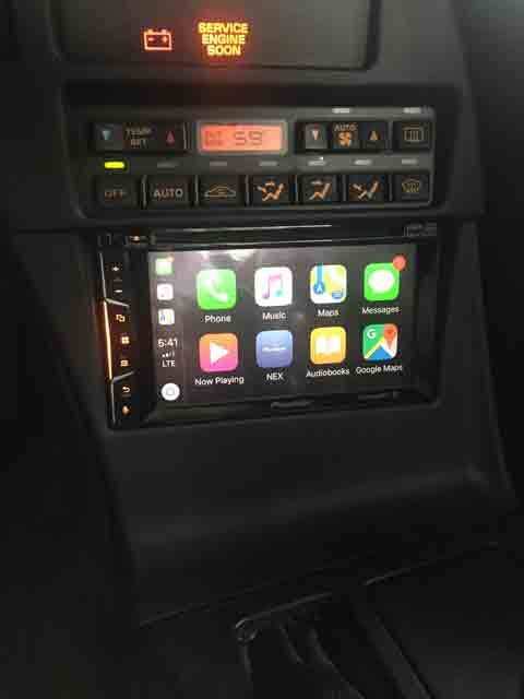

Sound system. The car has the original bose system still functioning, but the sound is definitely worse for wear. 2 questions. One, does anybody know the factory speaker sizes? And two, does anybody make a nice double din mounting kit? Id like a nice touch screen in there.
Metra makes amounting kit that works perfect. I put a Pioneer with Car Play on my 92. I just put the phone in the console and I have phone, music and nav.
