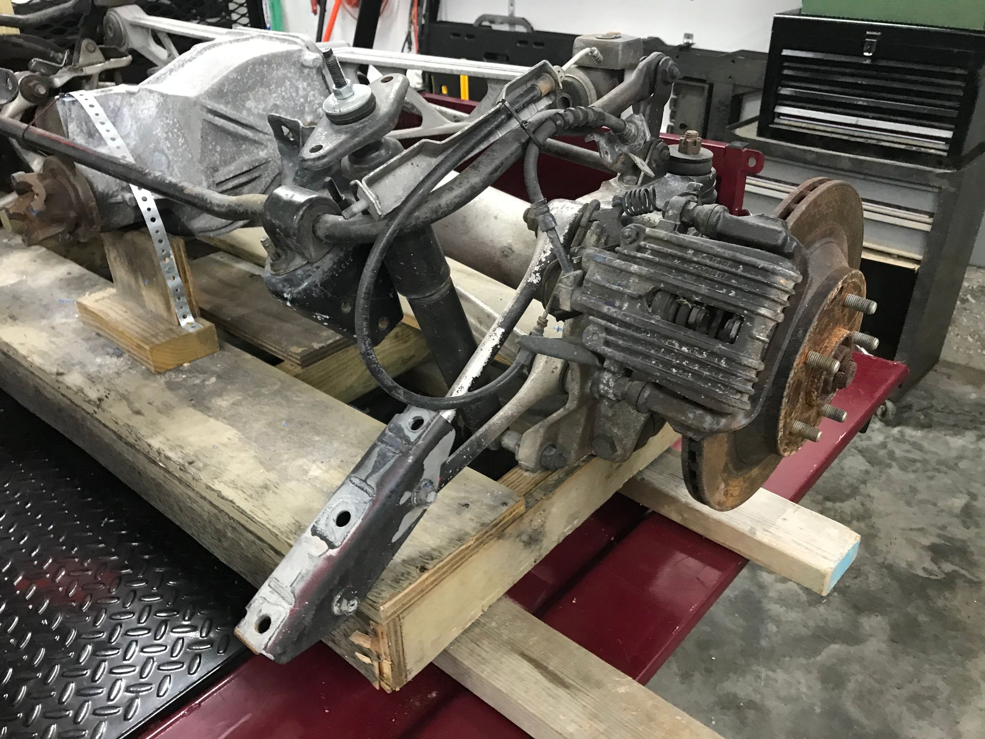

Working on cleaning out the garage while teleworking due to COVID and am down to the largest and most unknown (to me) item. Long story on why and how, but I have what I believe is a complete C4 rear differential/suspension and am trying to identify it, so I can correctly describe it for sale purposes. I've read several thread and been on numerous sites, but will post the information and pictures I have and let the experts tells me what it is.
+Numbers cast in:
- 42861
- 43164
- 14105119
- D216
- WO65
+One turn on the half-shaft = roughly 2 3/4
Brake cables and number of bolts across the top are shown in the pictures, so I'll let them speak for themselves.
If I'm missing something needed to correctly identify; please let me know where to look.
Thanks in advance for your assistance,
Groot

The important facts are:
2.73:1 Dana 36 from 1988-1996 Corvette.

THANKS! Greatly appreciated.
