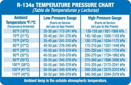

I’ve noticed my compressor cycling on and off more than I think it should. I was worried I might have over-filled it, so I rented the gauges set and decided to test it out. Here are my notes:External Air temp-81F
Idle-80 psi
Low-25 to 40 (pauses and sits at 35)
High-140 to 250 (drops as soon as it his 250, back to 140, fan comes on, pressure starts building again)
compressor cycles on and off until ~170psi, then stays on steady until ~250, then drops.
Air blows cold inside. I do not know enough to know what expected behavior is for this system. Car is a 1985 Corvette.
Thank you in advance for help!

High side should be in the 180-200 range. Simple calculation 100 + ambient in F it will be close enough most of the time.
low side 25-35. Outlet temp 40* or less.
you want to test at 2k rpm. Low side may rise to maybe 40 at idle and be normal. 1 or 2 fans?
If car sitting 8 or more hours a/c pressure should be close to ambient in F. There are charts that have exact numbers.
