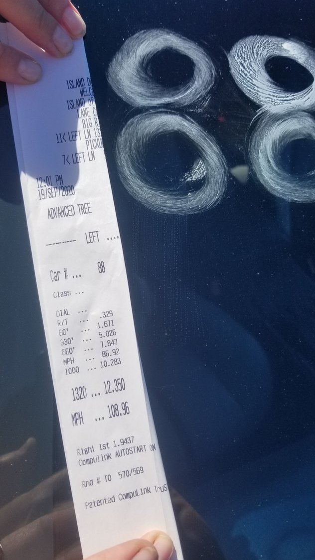

Ok took the car out this past Saturday for the 1st track passes did pretty decent for my wifes first time with the new setup..definitely has more in it..especially since she just rolled off the line..never really used the convertor if she did it wouldn't hook it has nitto 555rs we have to put the MT drag radials on for it to hook..so what do you think

I think: "She 'rolled off the line' to a 1.6x 60' time??" I think you're wife knows how to drive! 12.3/109 seems pretty strong to me. ~350 hp or so?

Thats a great combo you have there front to rear Id say...get some M/T on there and let her rip
What was your 60 ft? See, dont need an ls to run 11s or 12s.

Yes she couldnt use the convertor if she tried the nittos wouldnt hold....so she just had the feather the throttle off the line. She did great I'll post some videos too..

Thank you 1.67s 1.65 was the 60fts she had to roll into the throttle if she tried to launch it hard the nittos wouldnt hold..
Also it's still shifting at the stock rpm we need to address that either she will need to manually shift 2nd to 3rd to hold it out a few hundred rpms I think that will help with the mph and ET a little
