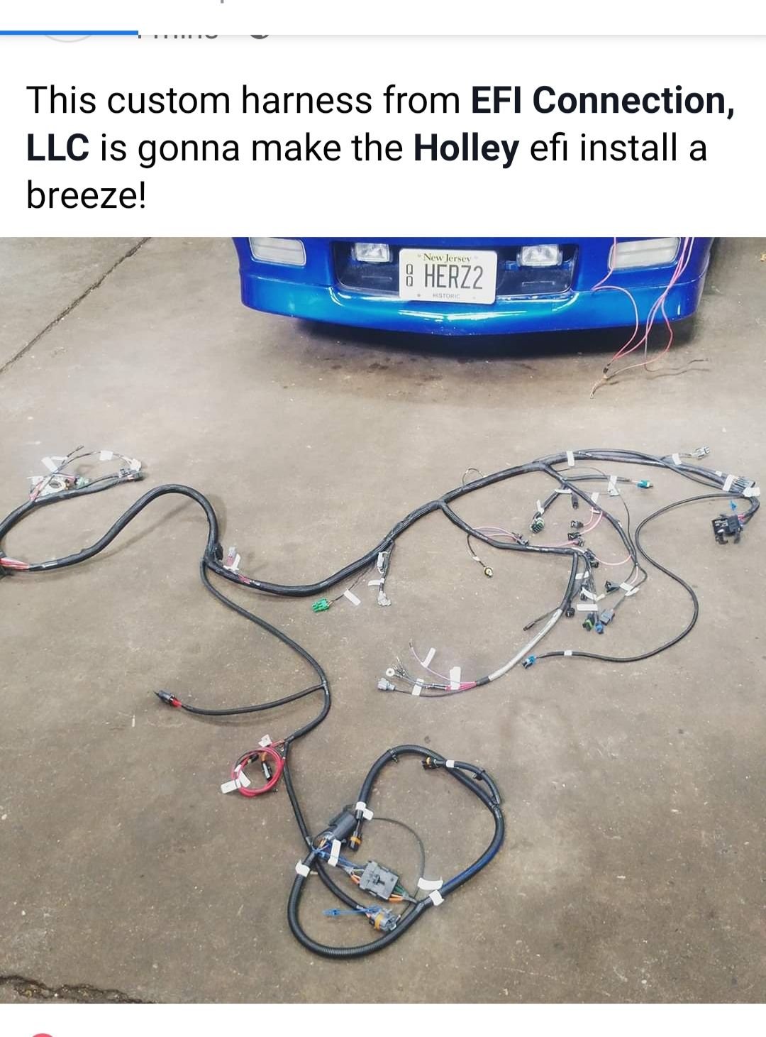

The holley hp efi system is the state of the art technology the shop our car is at loves them he even had a custom wiring harness made to make it all plug and play our factory harness was all chewed up so this was a no brainer
