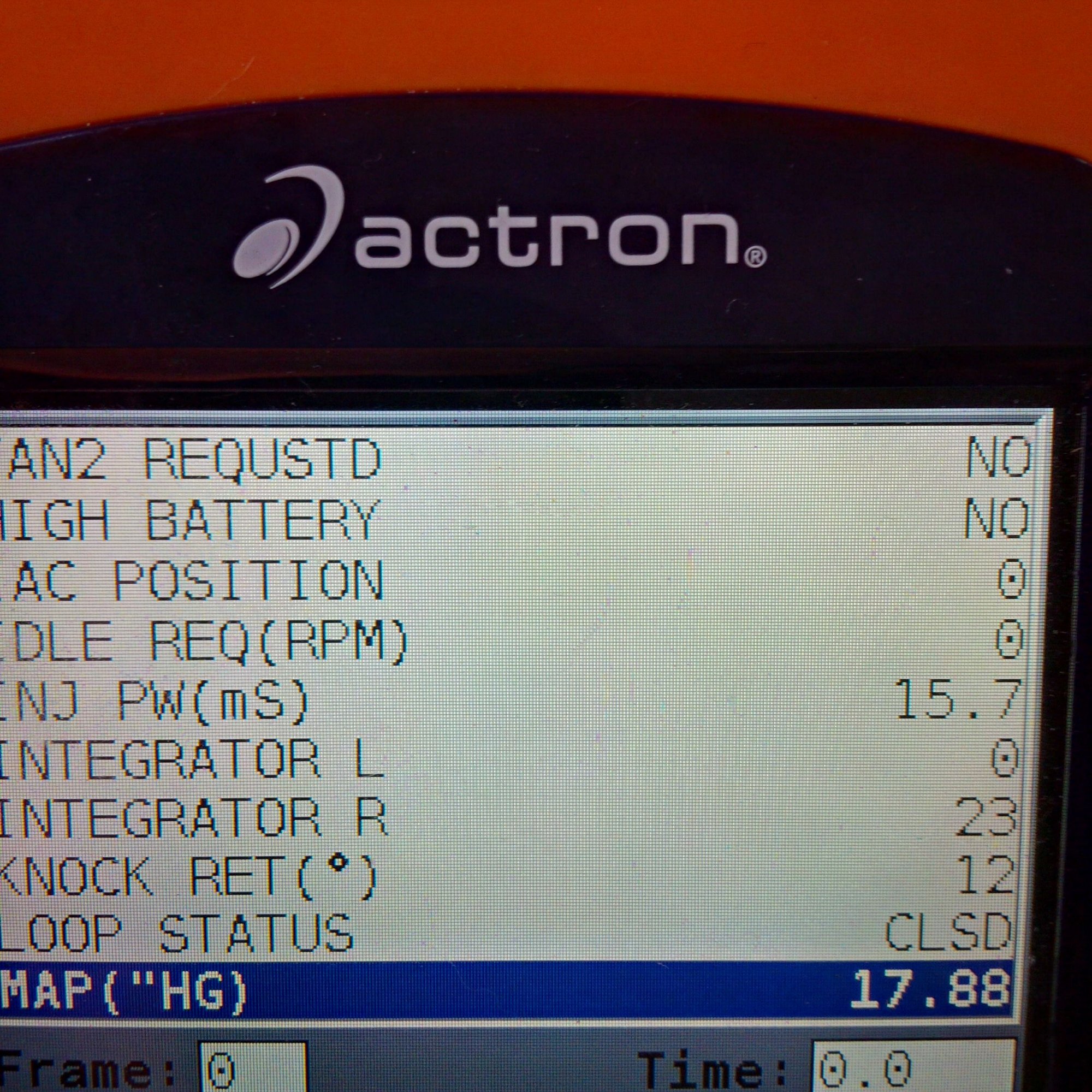

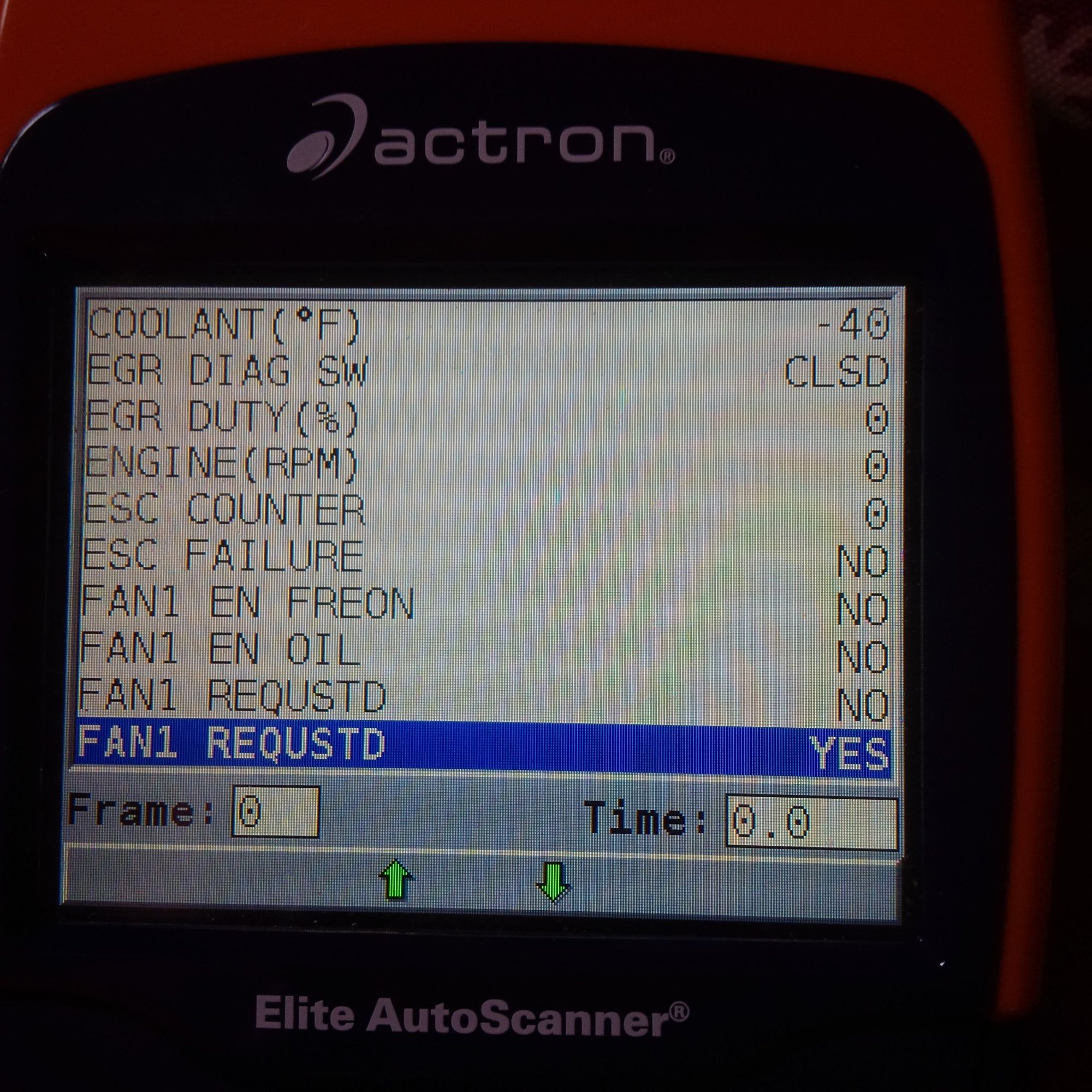

Here are readings i was able to take pictures of because still can't get scanner to link to my computer.

I'm pretty sure that was because i was playing with different amounts of throttle when scanner was recording. The other recording I did shows throttle % 0. Also just returned from a drive around the neighborhood and still has a miss, but not as bad as yesterday. I have checked all the spark plug wires for connection at both plugs and distributor. On data i show MAP is at 2.43 which i believe is within specs. If that is incorrect I'm sure one of you will advise.

Your readings from the Actron are all over the place and likely not correct. The (MAT) Mass Air Temperature is showing -40 and that alone would cause problems. Just because the Actron was acting up I would certainly not replace the ECM. I read someplace that if the ECM is bad the cooling fans will start and run the whole time to indicate a faulty ECM.
In the past when a vehicle has drive ability issues where the pedal does little to help it is frequently a MAP sensor or the MAF on the older L98 engines. When they fail the volume of air going into the combustion chamber is measured incorrectly and this makes a mess out of the Corvette.
Did you buy gasoline someplace different or anything?
Does the engine really think it is -40 degrees or is it the default number when not connected properly? At -40 there would be a lot of extra fuel being injected which could explain the long pulse width time for the injectors. This might explain why the O2 is seeing a rich mixture as well.
In "closed loop" an engine needs to see 3 devices to make the correct air-fuel ratio for those conditions. One is the Oxygen Sensor, the second is the Coolant Temperature Sensor and the MAF or MAP. This is why we start with those three parts and start looking .
Your oxygen sensor was reading .324 which is a bit off the median of .450.
The MAP is reading 17.88 which seems high but this was found to help understand the MAP:
A contaminated or failed mass air flow sensor cannot measure the amount of air flow correctly. This causes the engine computer to miscalculate the amount of injected fuel. As a result, a bad mass air flow sensor causes various drive ability problems, including a no-start, stalling, lack of power and poor acceleration.Feb 18, 2020
The knock sensor seems to be active at the low RPM's when you ran the Actron and that might indicate an "overactive" knock sensor trying to solve the knocking by pulling your timing back. If the knock sensor fails it will retard your engine a great deal, it pulls the timing back to prevent damage to the engine. I had one fail on my 1988 C4 L98 and it really cut my power back until I fixed it. Check it to see if it is overactive, while the car is idling there should be no knocking sounds to pick up on so take a metal wrench and tap on the metal surfaces of the block or cylinder head. As soon as you tap the metal it should automatically cause an idle change. A knock sensor is like a Tuning Fork and at specific noise levels it will produce a small voltage that triggers the ECM to pull back the timing.
The pulse width for your injectors was like 15.7 Ms and that would indicate that your engine is probably having an issue with low fuel pressure. You will need to verify the actual fuel pressure with an external gauge to see what your Corvette is getting for fuel pressure.
Check your Fuel pressure and then check your Knock Sensor as both of these could make for some bad drive-ability issues. I would also verify that the ECM is seeing the accurate temperature and not -40.
