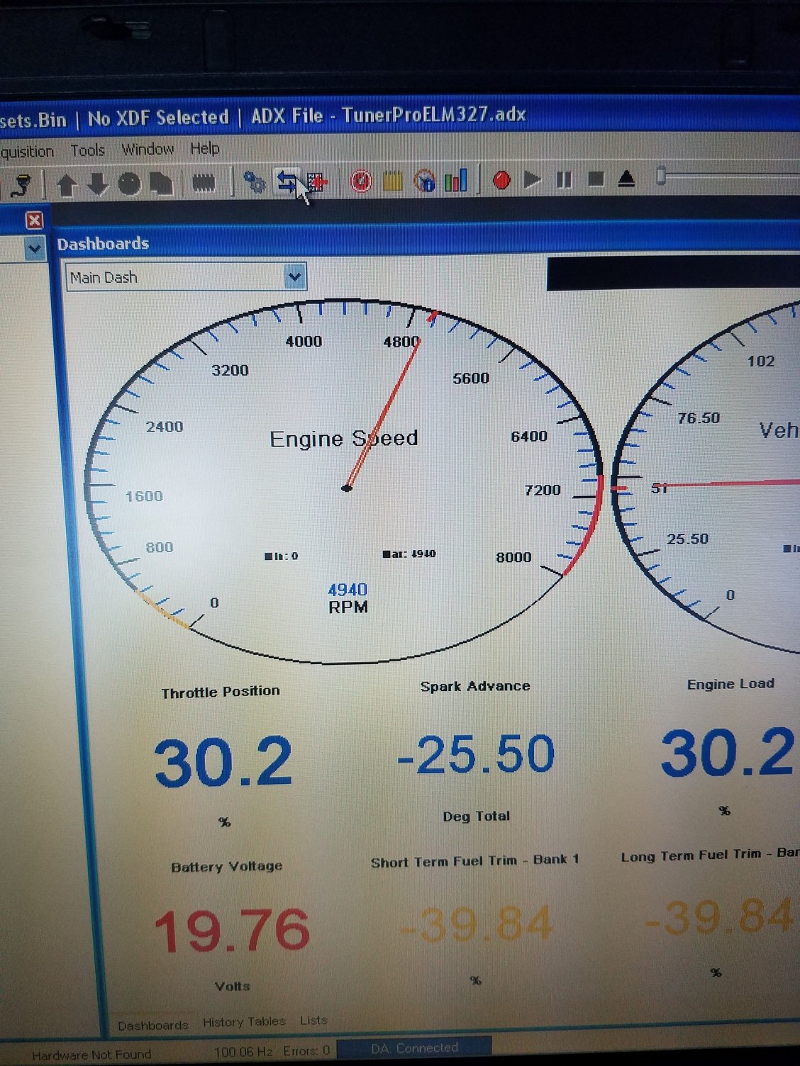

All of the dials are stuck at these values and don't move, with the only adx I can get to even say connected. (It will connect on this adx without even being plugged into the car)
As you can see it does say connected at the bottom and I don't even remember where I got the "tunerproelm327" adx from but that's the only one I can even get it to say connected with. I just tried the adx file that vikingtrad3r posted (after converting it from txt to adx and it wouldn't even connect with that one. I did not, however, have an adx loaded with it. All my settings are the same as you mentioned, earlier in this thread, jseremba. I'll have to double check tomorrow that all the boxes are checked but I think they are.

My TPRT does not look anything like that. I think you should uninstall it and then reinstall from the website.

I'm on windows XP and it is version 5 of TP. Are you on version 5? I actually have already uninstalled it and then reinstalled it from their site, in hope's that it would work. I even tried using version 4 TP. When I load an xdf file it brings up all these functions/values on the screen that it doesn't show without the xdf loaded. Do I need the xdf file uploaded as well?

I am on Windows 10. That is probably why they look different. Did I send you my adx? If not I will
