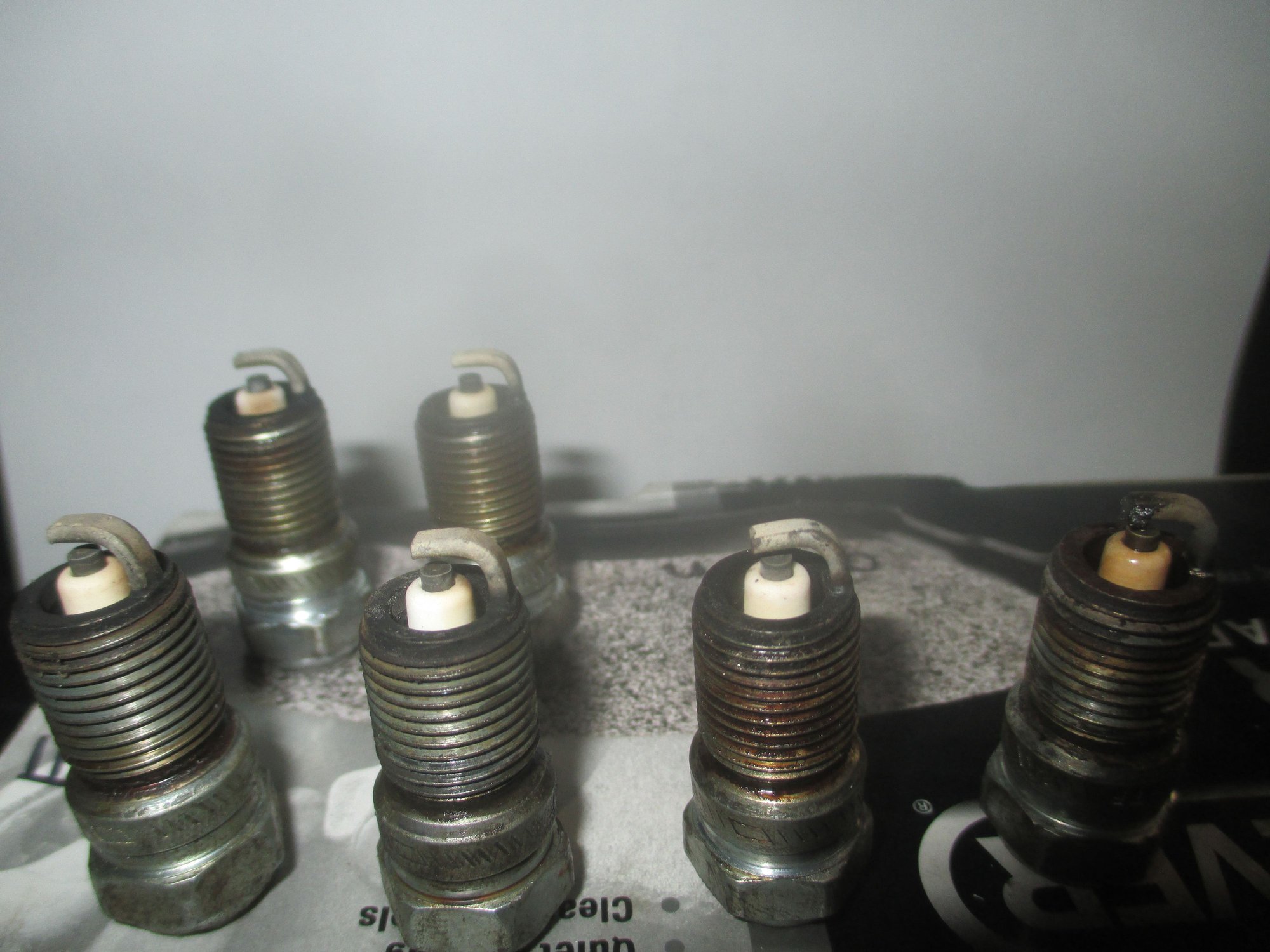

Interesting. the plugs from 1 thru 5 had clean white insulators, 7 had a bit of fouling. #5 looks a bit too white, maybe?
