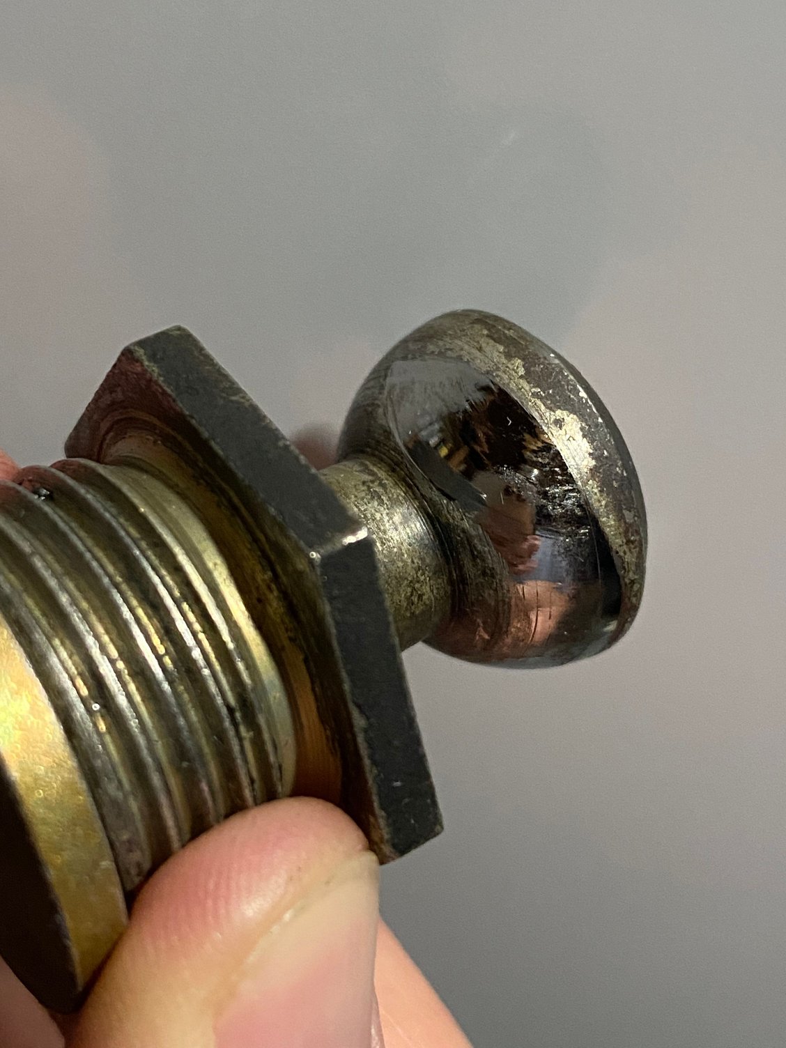

Working on an engine swap and noticed wear on the clutch fork pivot stud.
Is this expected given the car has 100k miles?

Well, theres that noise you haven’t been able to find!
look at the keeper spring on the back of the fork to see that the spring wasn’t mangled when somebody last changed the clutch.
sometimes they get only one finger of the spring on the ball, and it does that

There was a slight squeak when depressing the pedal, but it was very faint. Trans has never been off or clutch parts replaced (other than salve/line).

I just had mine apart with 118k and it looked nothing like that. I wouldn’t put that back in the car. Agree with the others that mentioned to check the fork as well. I used wheel bearing grease on it, in retrospect I wish I used a really tacky marine grease that I have.

It's probably fairly normal wear, and I would still replace it. FWIW, I used CRC Brake Caliper grease. Seemed to work really well as it's made for a similar use.

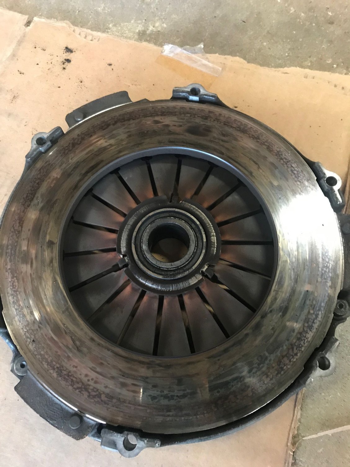

I talked with ZF Doc about it and he recommended replacement of the stud and fork. The stock DMF I took out is on the borderline of free play so i'll need to decide if it's time to pull the trigger on a new clutch setup or not. Tough call because it was working well previously, but with the trans out already it would be an ideal time to tackle it. Here's what the parts looked like after 100k:

Replace the clutch, PP, throw out, and pilot bearing while it's out. That disk is about done anyway.

If you replace the flywheel, you'll almost certainly change to a single-mass unit. That means you shouldn't use the solid-hub disk in the picture: you'll want a disk with a sprung hub as is now commonly sold for a single-mass conversion or for LT1-powered 4th-gen F-bodies. If that's the original Valeo pressure plate, I'd consider asking if ZF Doc would resurface the friction surface and legs for you and throw it back in. Those are better quality units than the replacements that are now all made in China in one factory. Ditto on the throwout bearing: the original ones with "INA" stamped on the green seal are way better than the Chinese-made garbage that seems to come in all kits these days. For the pilot "bearing," I'd use a new bronze oilite fluted bushing instead of the needle bearing that often gets sold.

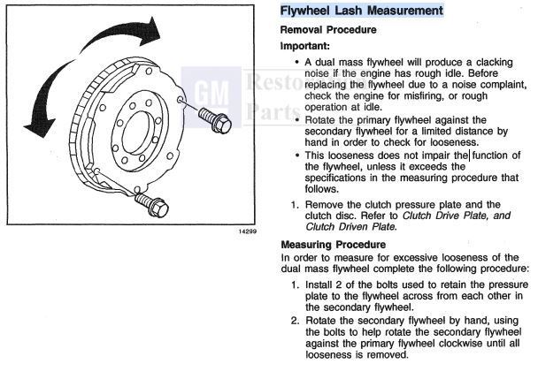

Question about the DFM free play measurement - I assume when measuring free play, the rotational distance considered is only that which is able to freely rotate. Meaning, the end point in each rotational direction is as soon as spring resistance is felt? If so, i'm at 25mm, below the 35mm FSM spec for replacement. That would significantly alter my plans for a clutch replacement (i.e scotch pad the DFM, get a new disk, and have ZF machine the PP).
I've literally never messed with a DFM because my C4 came with a single-mass aluminum flywheel already installed. Best I can do is paste the procedure as written in the factory service manual:
I hope that helps!

^Thanks...same procedure I found in my FSM.
