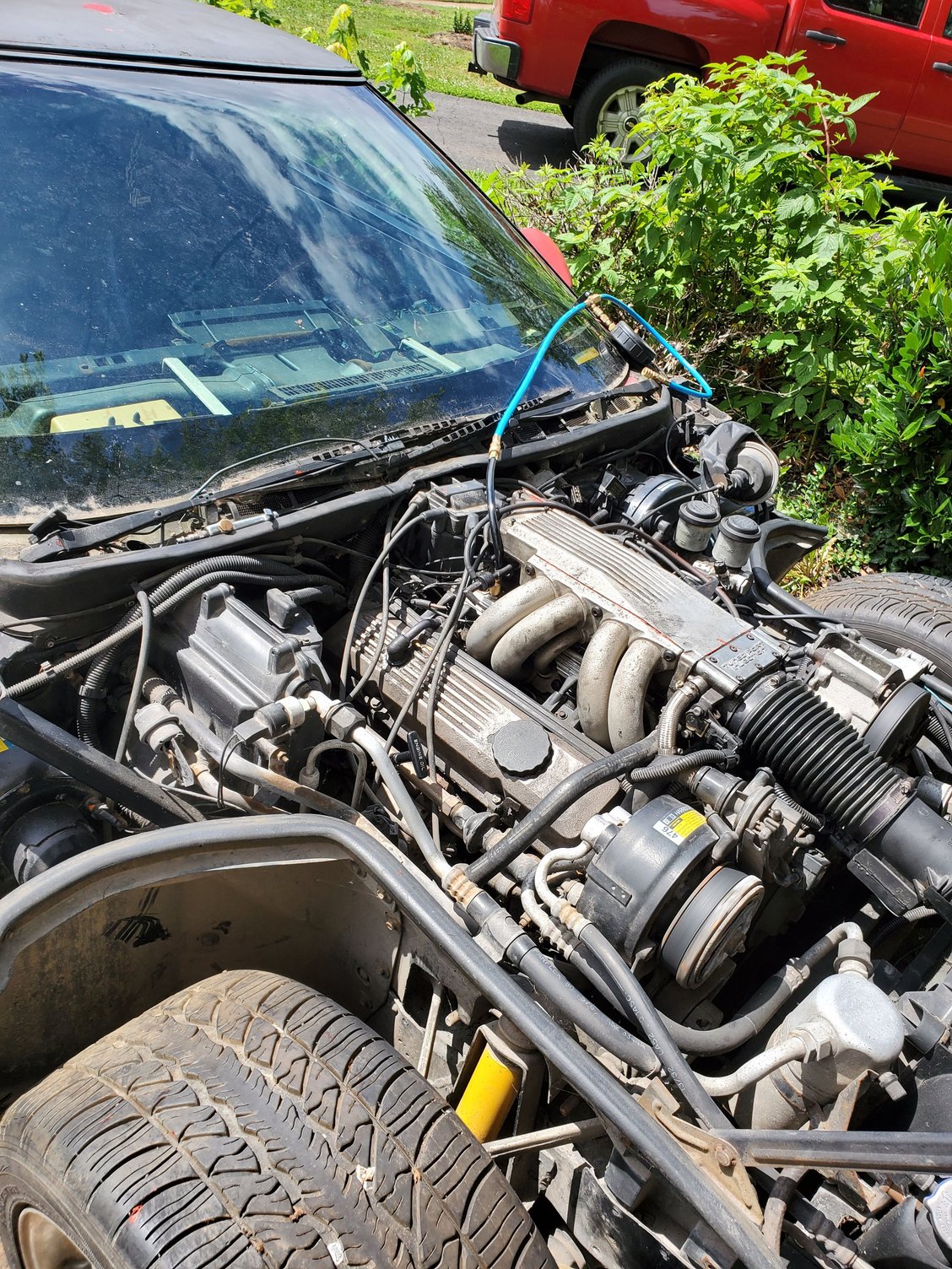

You can tape a fuel pressure gauge to the outside of the windshield and take it for a drive.

20PSI and drops with any throttle, also it seems that there no fuel returning, which makes me think fuel is barely getting to the regulator. When I first started running it there was lots of fuel returning, I guess filter and blow out the linew, run her dry and clean the tank?
ok we have identified the problem now we need to identify the cause. So yep fuel filter, the sock on the fuel pump, the pulsator on the fuel pump (if it has one replace it with a piece of submersible fuel line), blow out lines. That’s a start anyway, after that maybe check injectors (for stuck open).
