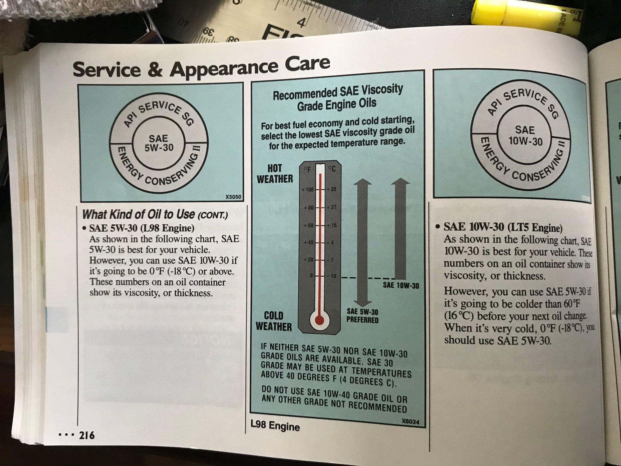

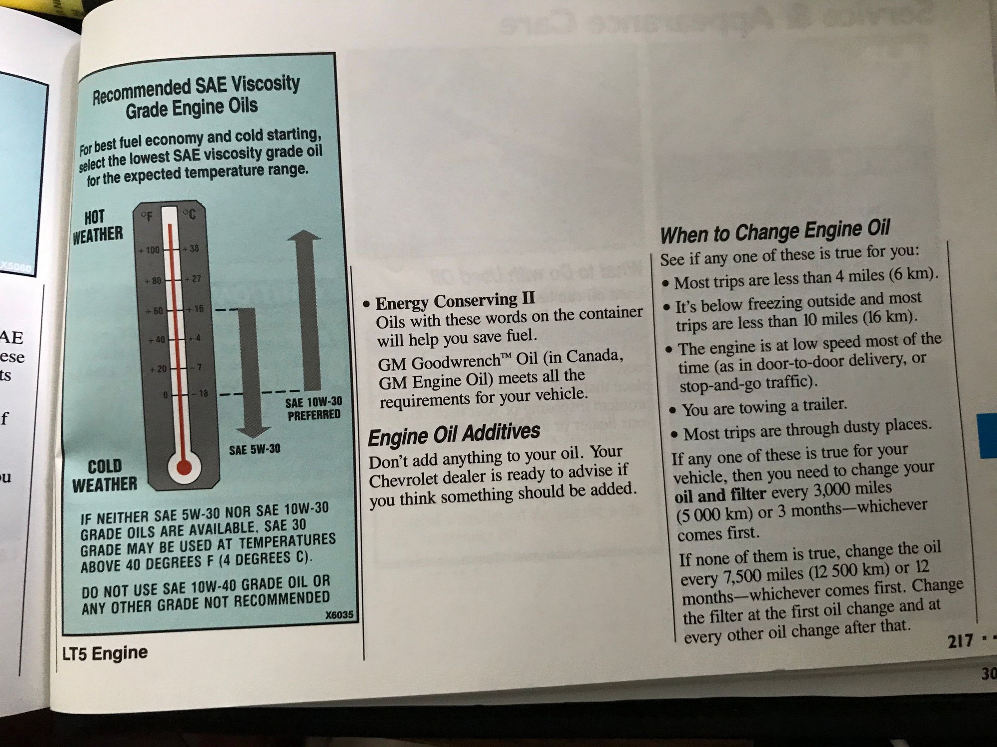

Right out of the owners Manuel, I would refer to the appropriate year for your Corvette. As long as the oil meets the manufacture standards it should be just fine.
