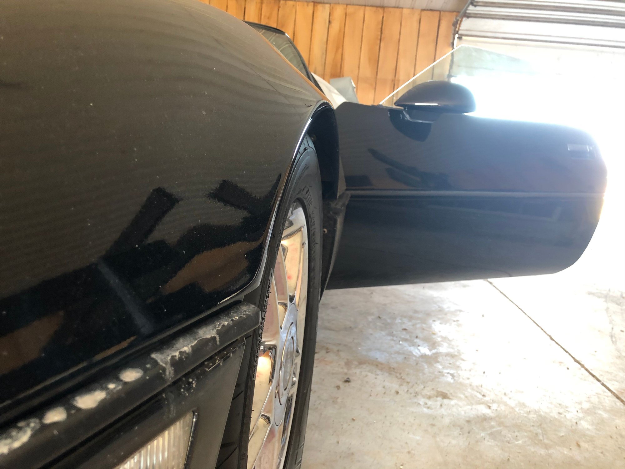

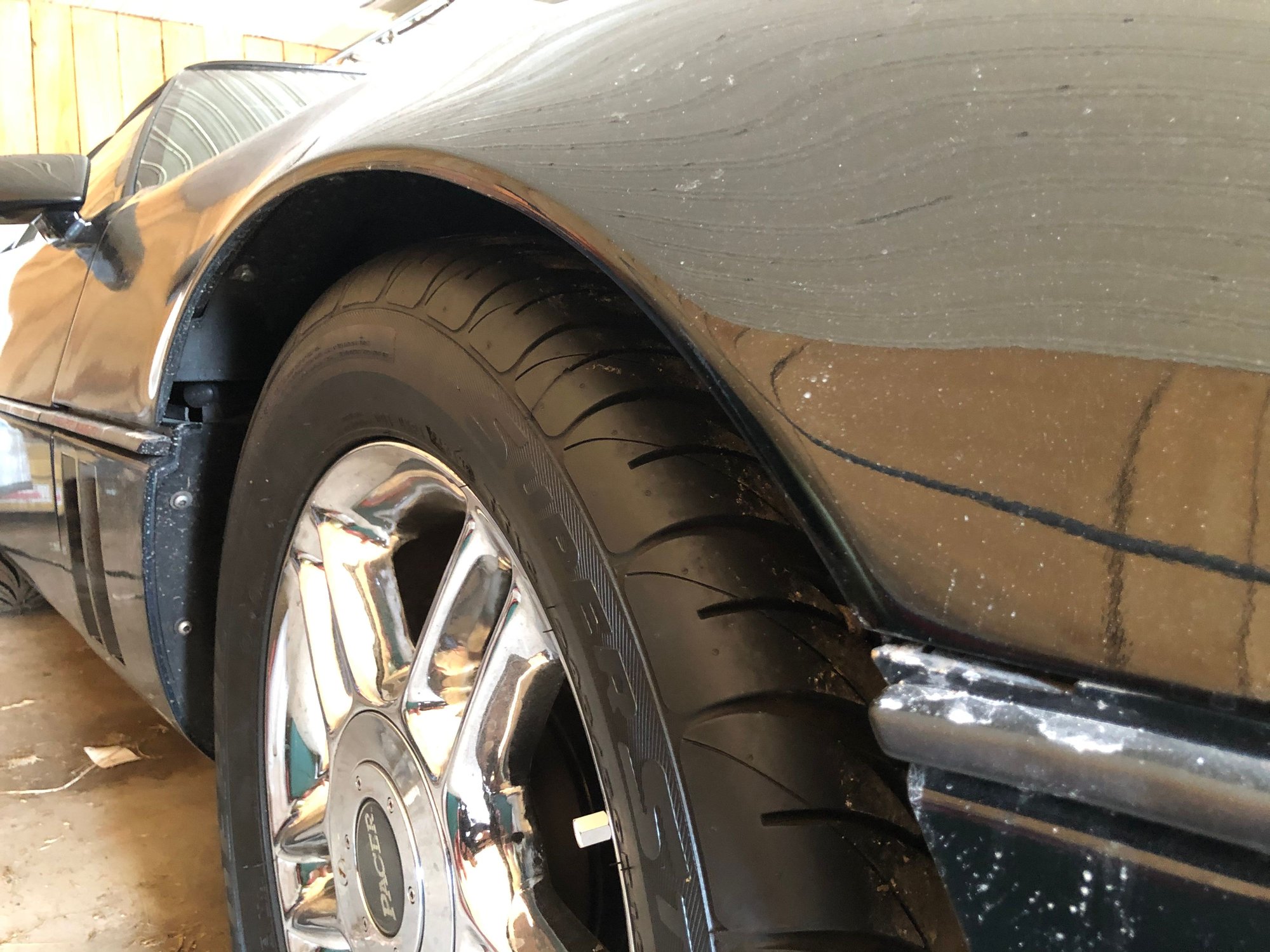

I went to the garage where the car is at today and was looking at how far the tires sit inside the fenders. There is quite a bit of room in the inside, I took some pictures showing how much room there is.
