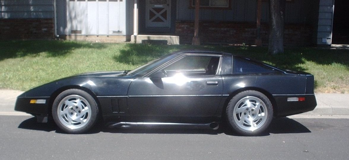

17x11x36mm is a know fit for 84-87 C4's. I have seen many over the years with them on front and rear. 18" would be the same as long as the final OD doesn't get too large.
I don't remember who's car this was. Here is a picture I had saved from more that 20 years ago. He had 90 model ZR1 wheels on all four.

ok, thanks for posting that. I was actually just about to ask you something. You said earlier you had 17x10.5 wheels at 44 offset, this was on an early c4 right? I got to thinking if those work then I would probably just be able to get my wheels in 18x11 at 41 offset since they would only sit 3mm further to the inside. At most they would need a 5 mm spacer on the rear and you said that would work on the stock studs wouldn’t it Matthew?
