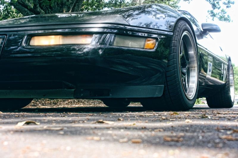

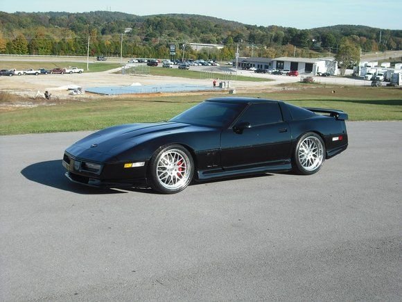

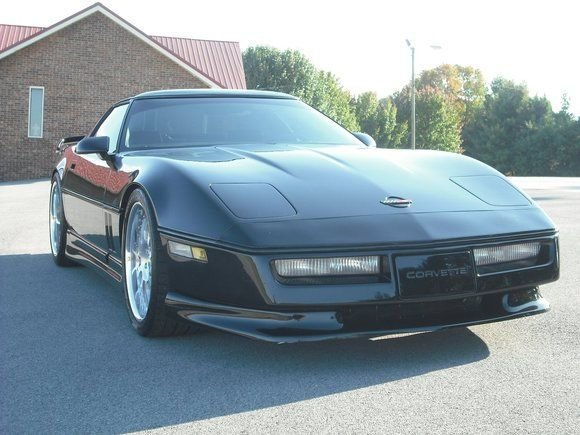

I'm hoping the wheels sit about like this cars’ do in relation the the fenders. It has 315’s all around. I have always though these cars have such a large turning radius, if it was a small as a regular car and let you turn the wheels that far there is no way the wide wheels would fit up front. So I’m glad they made them with the stops out so far for the turning. If the car is moving slow during a sharp turn it barley wants to turn haha.

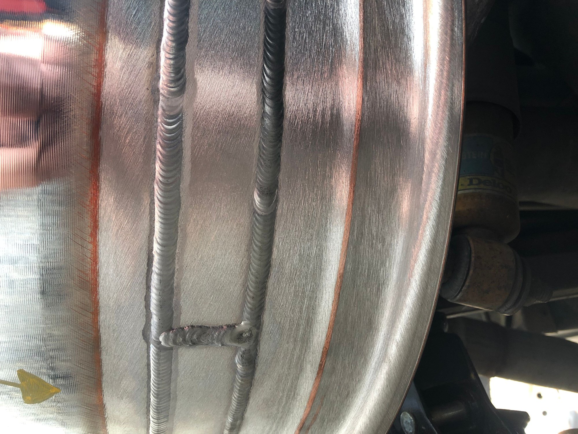

I need to fill out the form to send to weldcraft so they know what they are doing with the wheels. They can grind the welds down so they are smooth for an extra $50 each wheel. Do you have an opinion on whether I should do this or just leave them as they are?
Other than appearance, I'm not sure what the advantages to doing that would be. So I have no worthwhile opinion on this. What do they say is the advantage?

I think that is all it is for, it was just an option on the modification form I need to send to them and I wasn’t sure whether I would want them smoothed out or not. I asked them about it and they said it’s to hide where they welded it and it doesn’t make the wheel any less strong by grinding the welds but I think it would be fine just leaving the welds as they are since it’s probably far enough back in that you can’t even see them anyways. I checked with them to make sure and they said they won’t hurt the chrome finish of the wheel too., just the 3-4 inch area that will be raw aluminum from the welding.

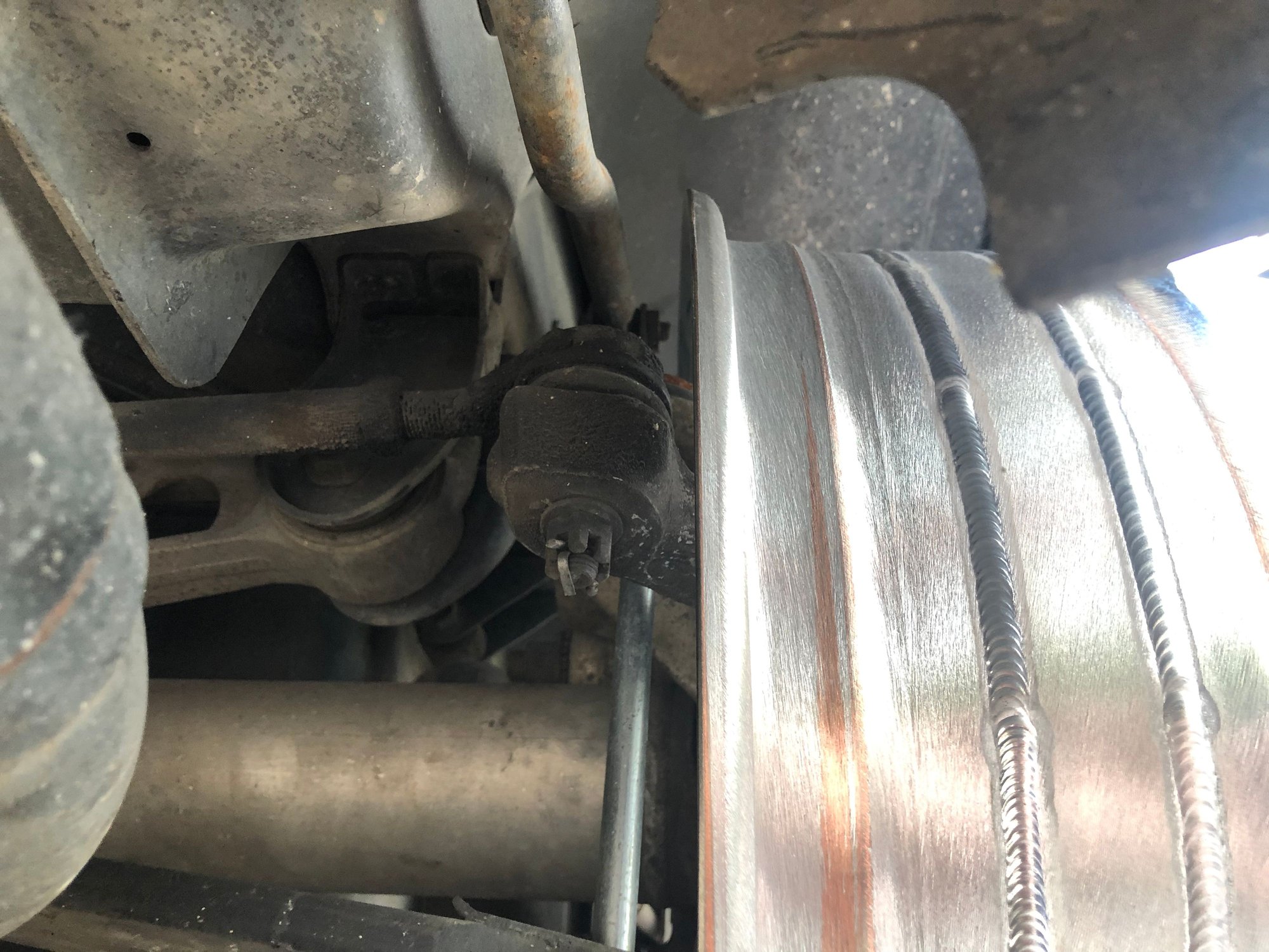

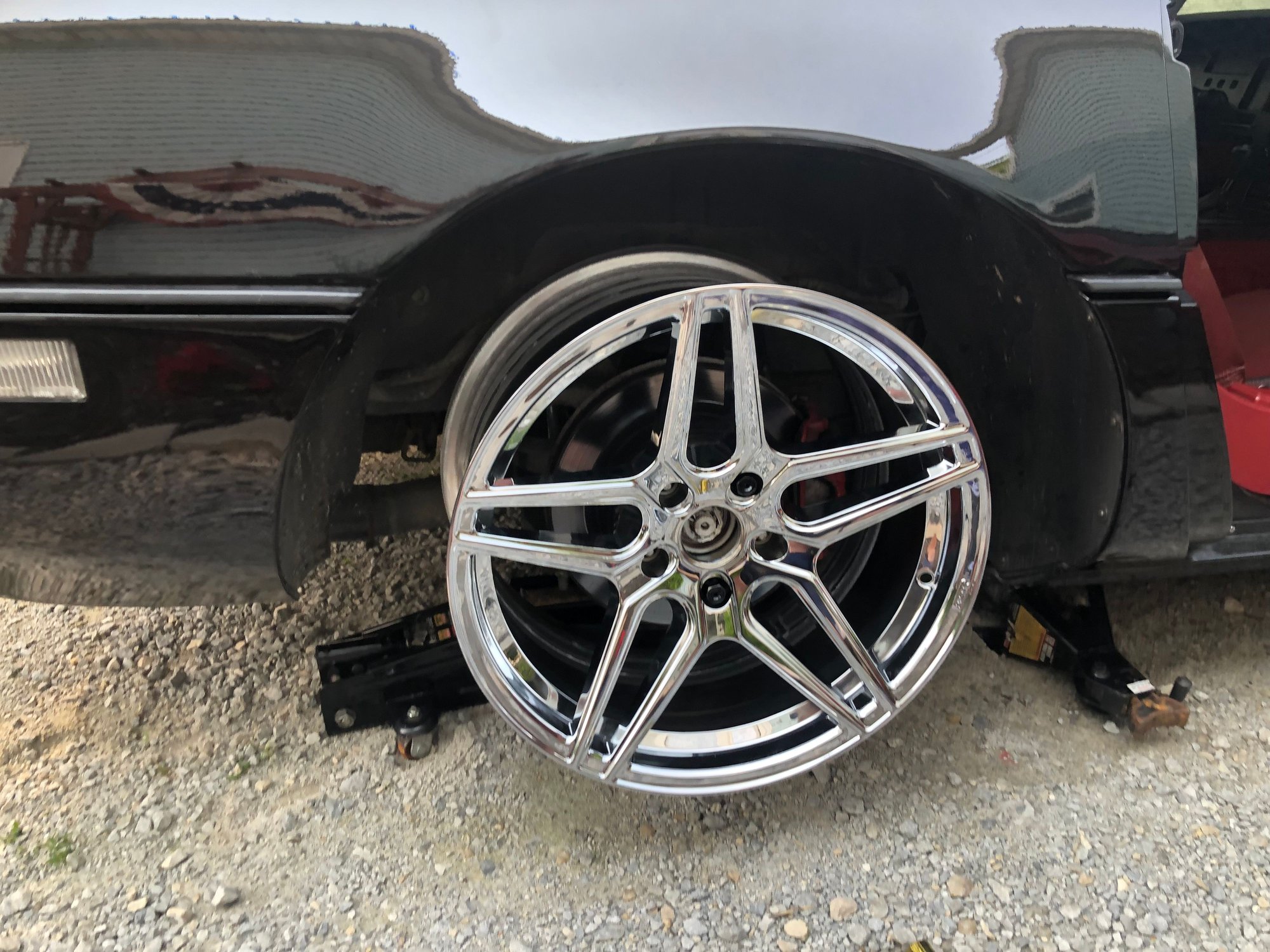

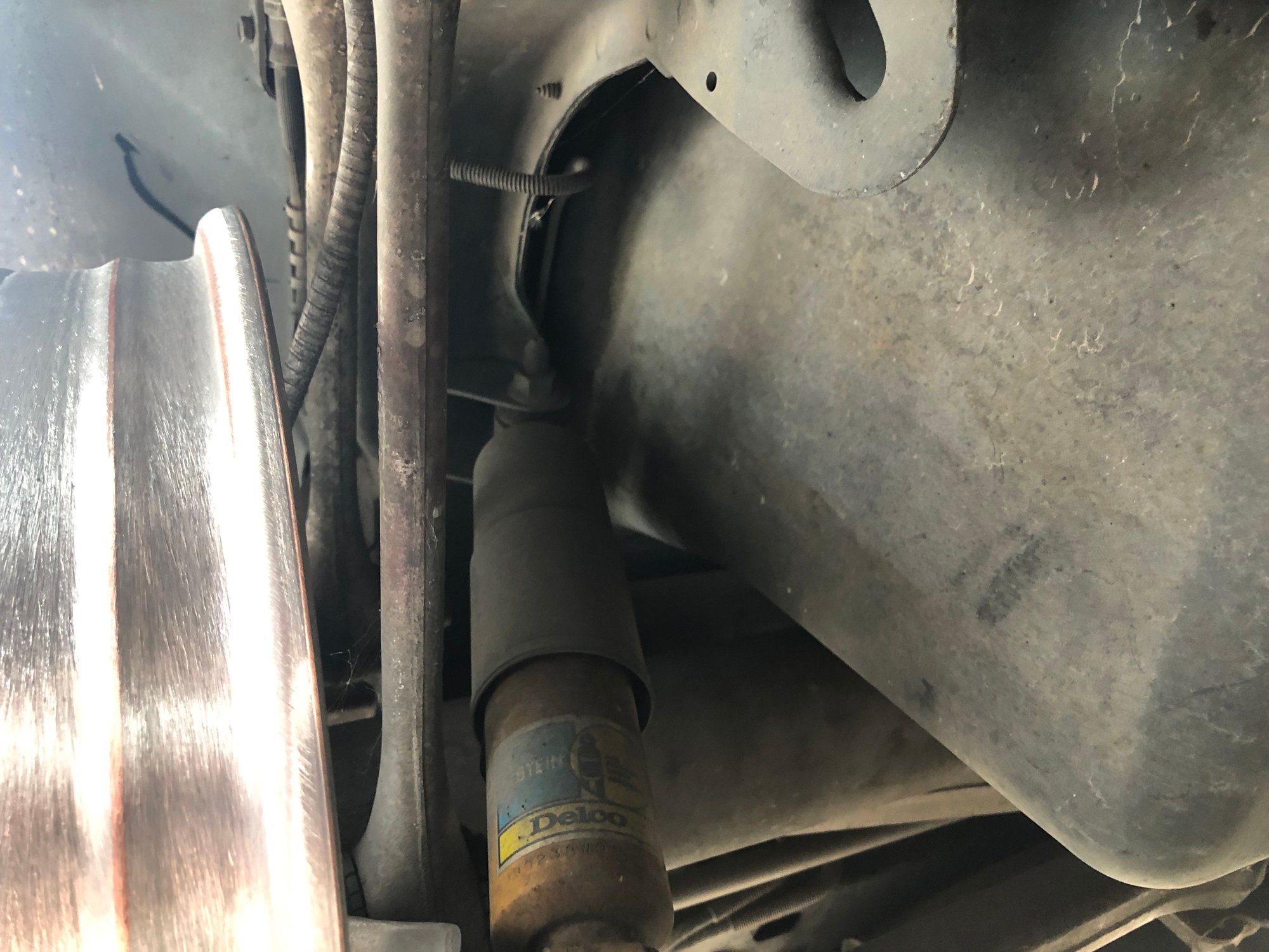

I got the wheels today. I already had an appointment at a tire shop to put the tires on tomorrow but I had to put one on just to see if it looks like it will fit. Here’s the pictures. I think they will look great, it may need that spacer like Mathew mentioned, what do you think? The sway bar and control arm/dog bone link are both pretty close but I don’t know how far the tire will bulge out. There is just over a finger width in between the rim and the suspension pieces so if the tire bulges out further than .5-1” then it will need a small spacer but they look like they will fit almost perfect. It sits just inside the fender too but I will have to see it with the tire on of course. I didn’t stick one on the front to see how that fits, I’ll have the tire shop put the wheel and tire on the front and rear and see if they think it will work.
Old Jul 21, 2021 | 10:07 PM
  #180
MatthewMiller's Avatar
MatthewMiller
Joined: Aug 2015
Posts: 6,078
Likes: 1,966
From: St. Charles MO
If I still had mine, I'd go outside and look at how close the rim edge was to the swaybar and trailing arms. The other part you're going to have to look at closely is the trailing arm mounts that bolt to the frame. The pivot bolts for the trailing arm bushings may rub the corner of the tires. The reality is that every tire is a little different in sidewall bulge and tread width, so you're going to have to try it out and see.
