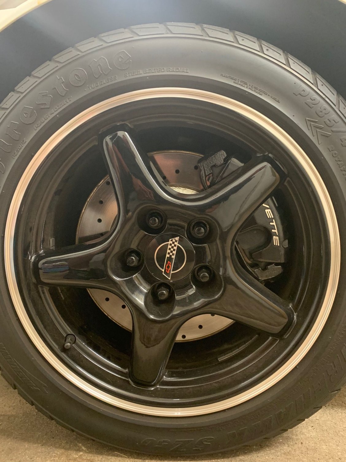

Originally Posted by JoeNova
Supposedly the C5 brakes will fit in 17" A-mold wheels. No personal experience, but that is the claim.
True

Originally Posted by TA
True
the C6 Z51 package fits under the 5 spoke A-mold wheels as well.

Originally Posted by littleredcorvette88
where did you get the calipers? I have found a few but either the corvette logo is paonted all red, or the bracket is another color from the caliper etc.
You can buy factory C5 Z06 brakes which were red from the factory. Anything that has the lettering painted has been refinished poorly as they were to lazy to take care of the letters.
My personal preference is to leave the bracket black, as it frames the caliper.
