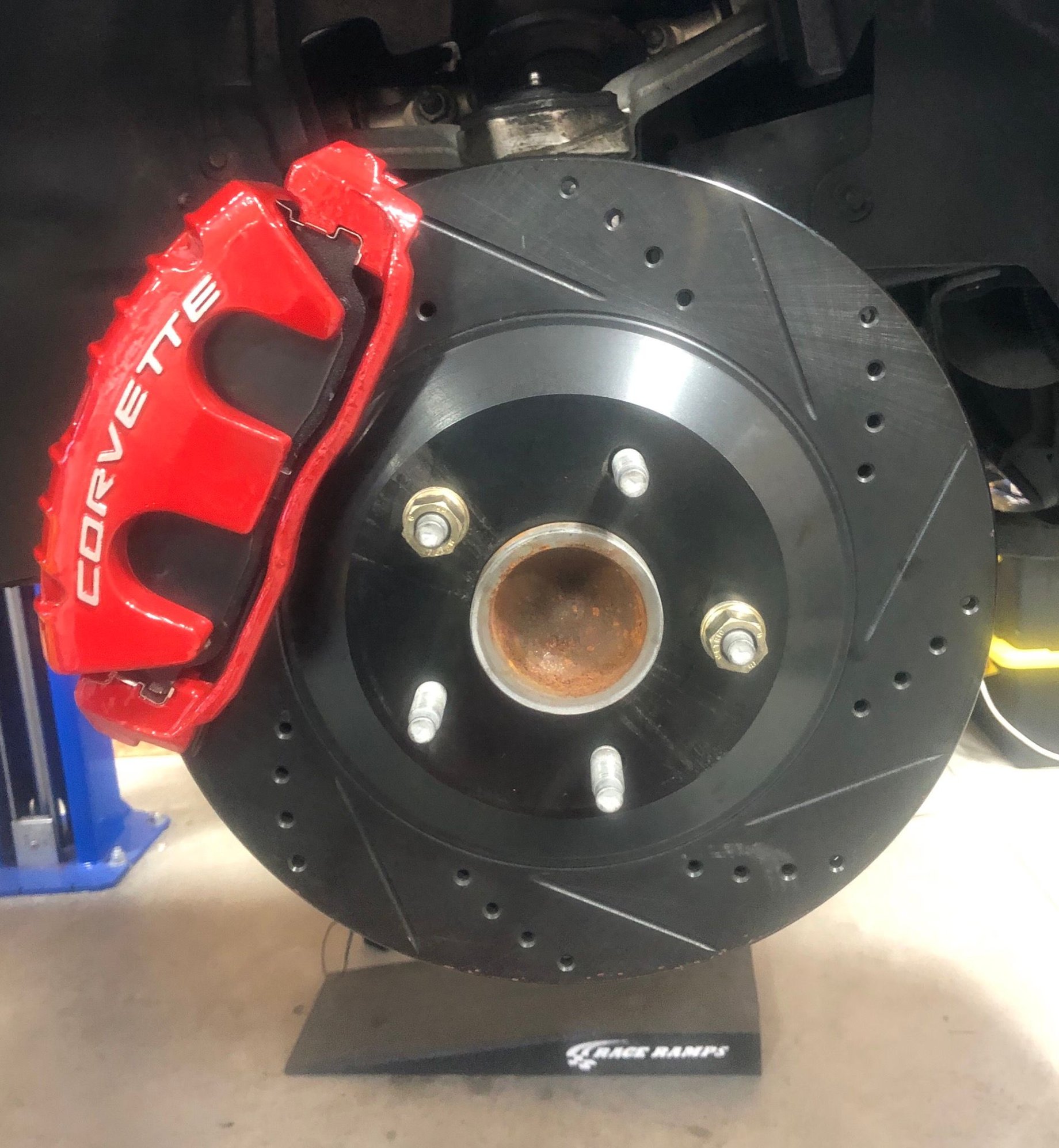

Yes
the C5 caliper fit. I just completed the C5 caliper upgrade on my 94 with 17” A-mold wheels. The C5 caliper do not fit behind sawblades.
Old Jul 19, 2020 | 12:52 PM
littleredcorvette88's Avatar
littleredcorvette88
Joined: May 2007
Posts: 424
Originally Posted by TorchZ51
Yes
where did you get the calipers? I have found a few but either the corvette logo is paonted all red, or the bracket is another color from the caliper etc.
