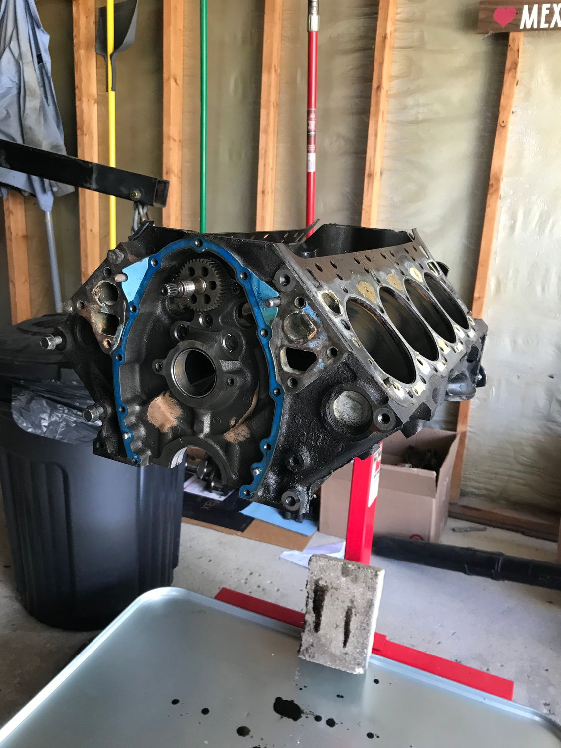

Originally Posted by drcook
what are you going to do with the old block
No plan for it at the moment. Here is how it sits as of now:
