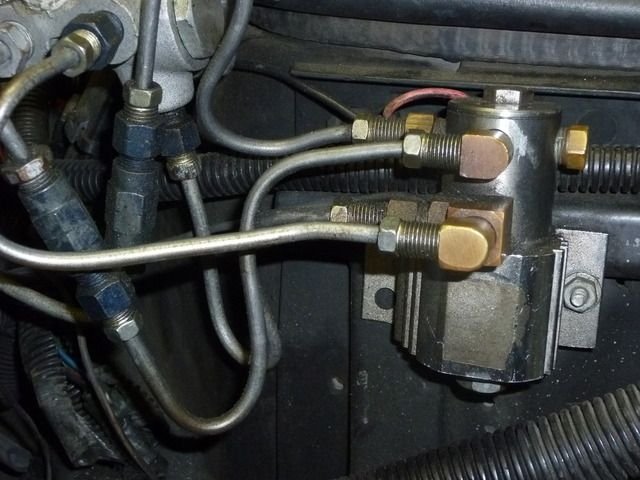

Here's an 84. The bottom of the line lock shows an adapter for the two out lines from the master cylinder. The upper ports of the line lock go back to the stock front lines.

I never even considered the idea that a line lock solenoid could have more than one port for an outlet. Thank you so much for the picture. What brand line lock is that?

It's a Hurst that I have been using for the past 30+ years. Thousands of runs and not a hiccup.
